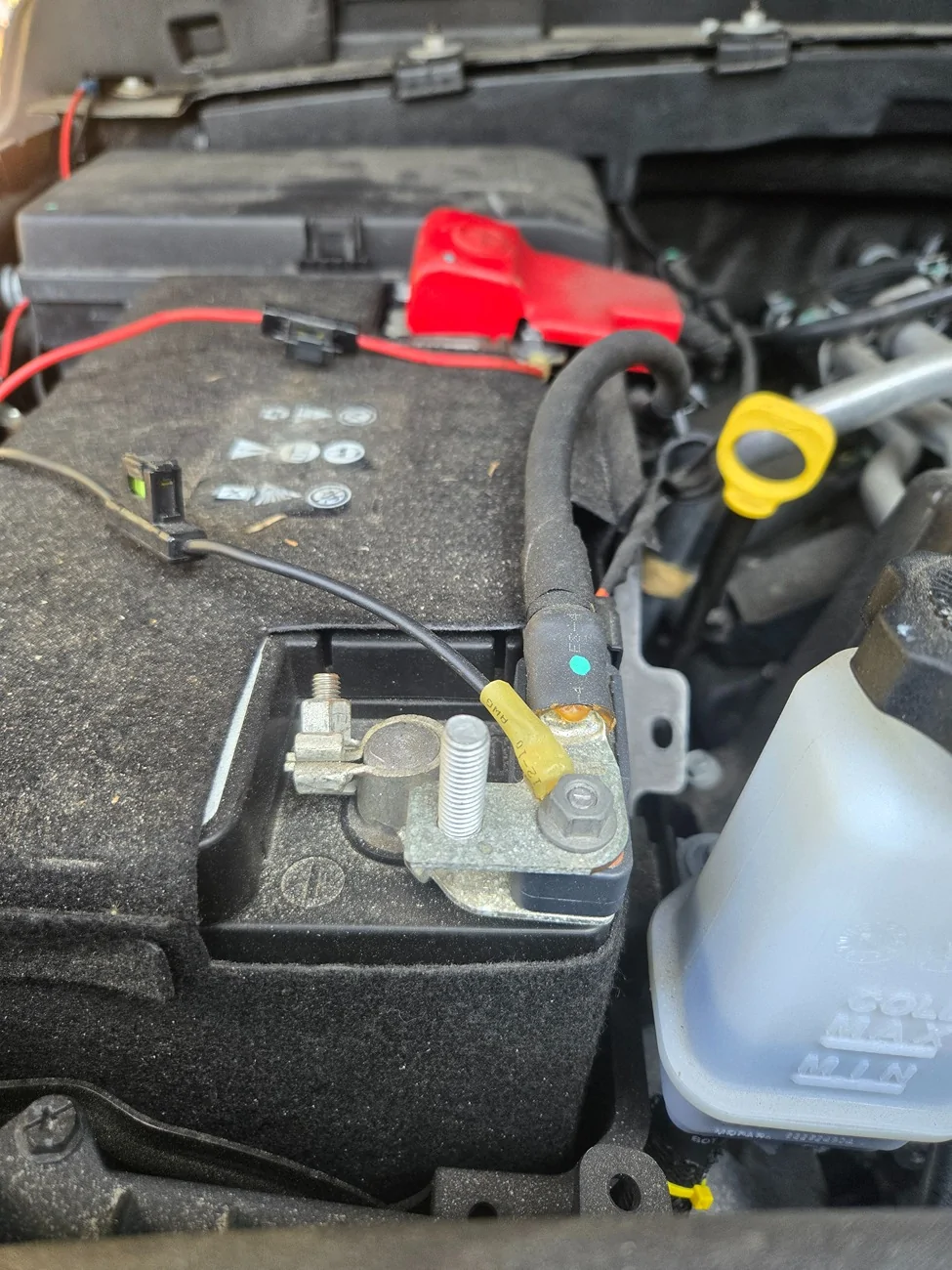

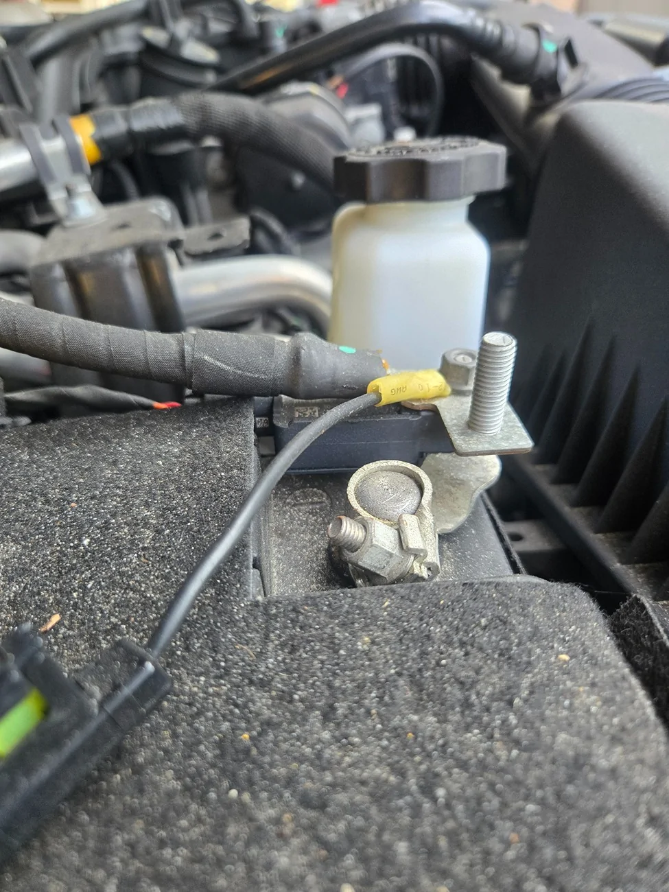

Silly question - Does a 2023 JLUR with a 3.6 V6 24V VVT eTorque Engine with Stop/Start have an Auxiliarly battery?
I'm asking cause I attempted to bypass it today and there was no negative cable for the Aux battery. There is a post that I think is where it should be but there is nothing on it.
{I do have a wire for a radio connected to the main post.}

No. eTorque models do not have the golf cart battery.
Previously asked (among many, many others):
https://www.jlwranglerforums.com/forum/threads/e-torque-have-start-stop-aux-battery.143081/
https://www.jlwranglerforums.com/forum/threads/2021-3-6-etorque-no-aux-battery.61061/
Edit: To go into a little more detail, you have a secondary battery—a big 48V battery physically under the Jeep. You do not have the small 12V battery under the fuse box.

Nope but you do have an empty small battery box in your fender well.
