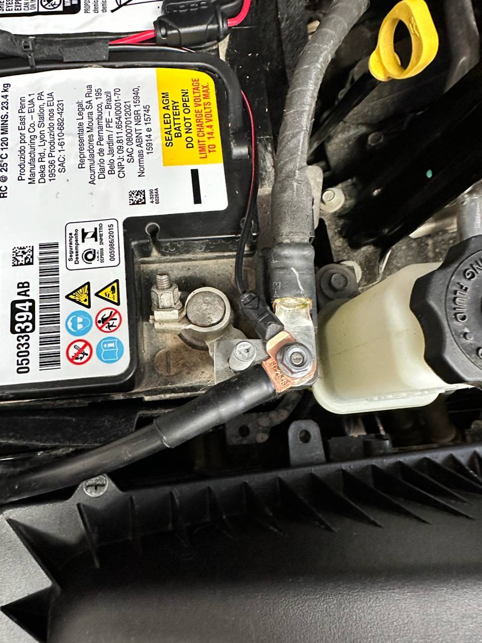

Hey folks!
I’m in need of a good battery d-block system. The nut holding the three wires has only a couple threads engaged on the bolt…

I’ve seen these (but not sold on them yet, unless someone says they’re great) and I’m not quite sure how they would fit…
Jeep Wrangler JL Looking for a Good Battery Post Distribution Block 1678985999406
How do you all connect multiple wires?

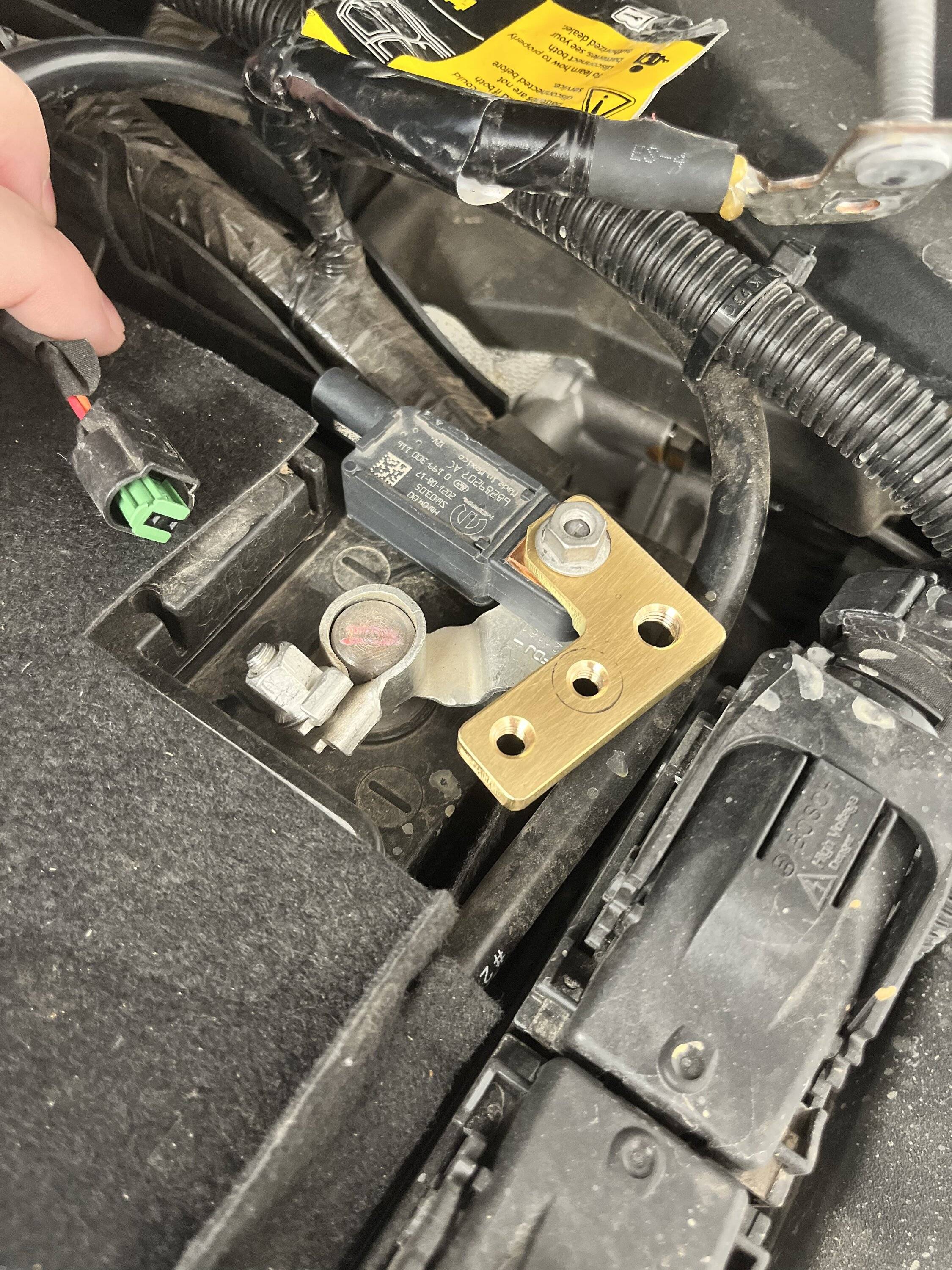

I suspect all of the current needs to go through this post for the battery health sensor to work correctly:
Jeep Wrangler JL Looking for a Good Battery Post Distribution Block 89F349AA-9883-4172-AA79-BF1C1F0374C7
The L bracket I tried is too thick to use:
Jeep Wrangler JL Looking for a Good Battery Post Distribution Block 5D4D01B8-B39F-4109-88A9-288587775F64
Would love to see a good alternative, or to hear from somebody knowledgeable to speak to that battery sensor.

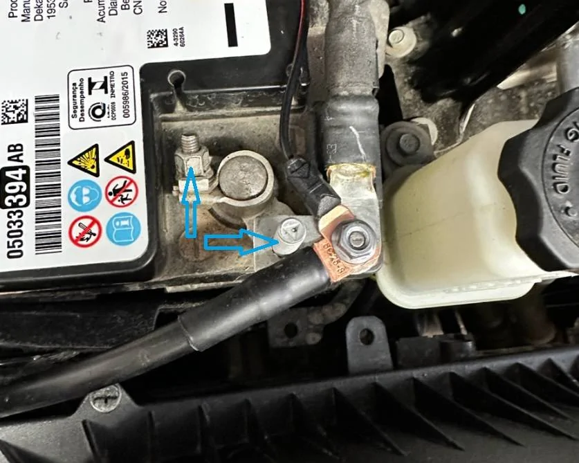

Is it possible to transfer a cable or two to the highlighted posts?
I tried the main connecter bolt, but it puts a lot of stress on my connectors. I thought the long stud wasn’t threaded correctly to accept a nut. I’ll check again. Thanks!
I never noticed that sensor until tonight when I checked to see if I had it. It certainly was there!
I like your bracket idea. What thickness is the bracket? Do you think a thinner bracket would do it or would it be too flimsy?

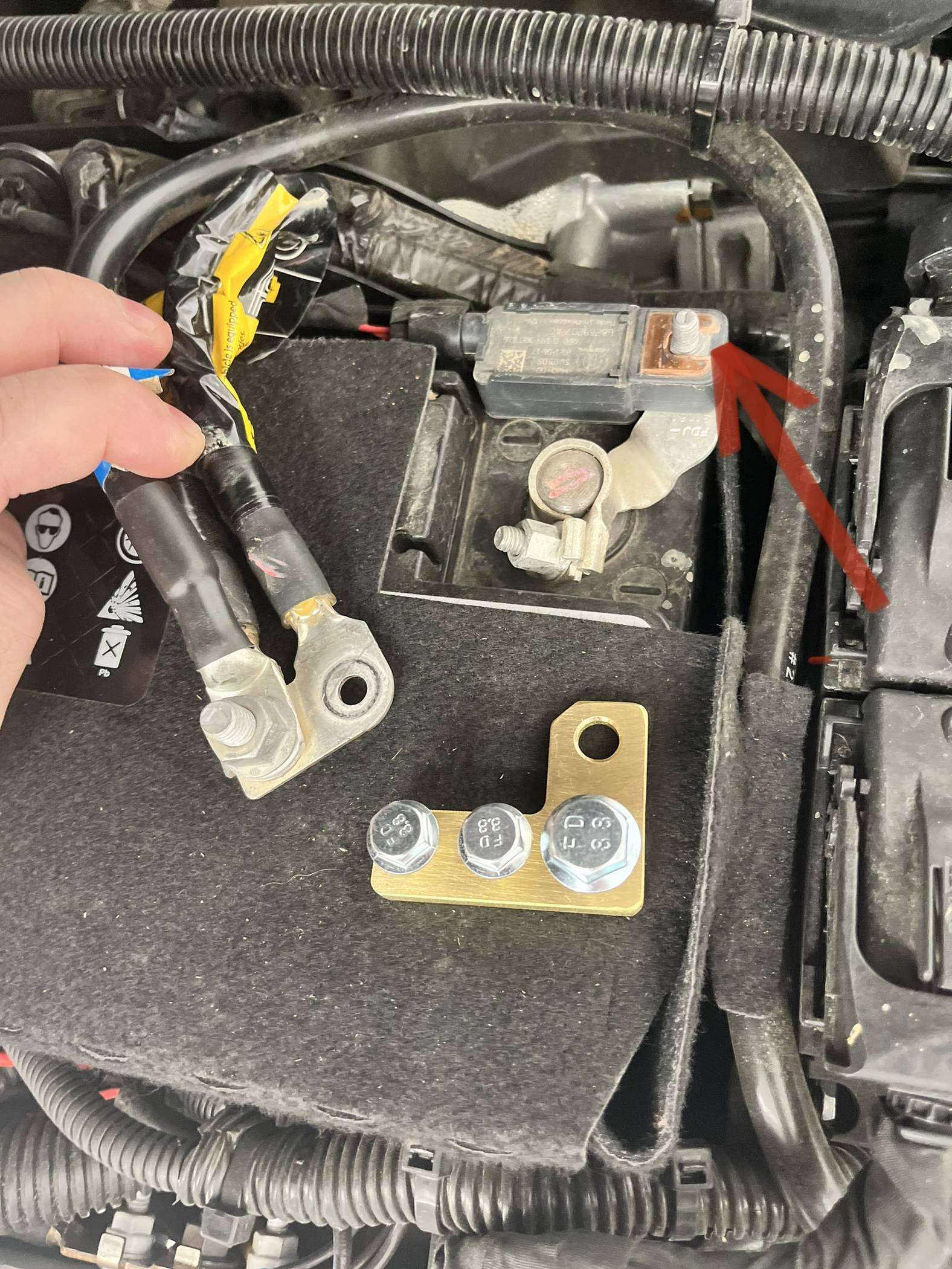

What if you drilled a little indentation for the factory nut to sit inside of?

You know… that probably would have worked. I cut the end of the L off trying this (the last hole is threaded):
Jeep Wrangler JL Looking for a Good Battery Post Distribution Block 98F0B83E-9DBC-4413-9168-D8A3147E0352
And then went to this, not perfect but better:
Jeep Wrangler JL Looking for a Good Battery Post Distribution Block CAAE8CAD-363E-477E-BAF7-A0FE8F296AFD
Jeep Wrangler JL Looking for a Good Battery Post Distribution Block F7961CE2-4090-47BC-924E-339777BA2271
