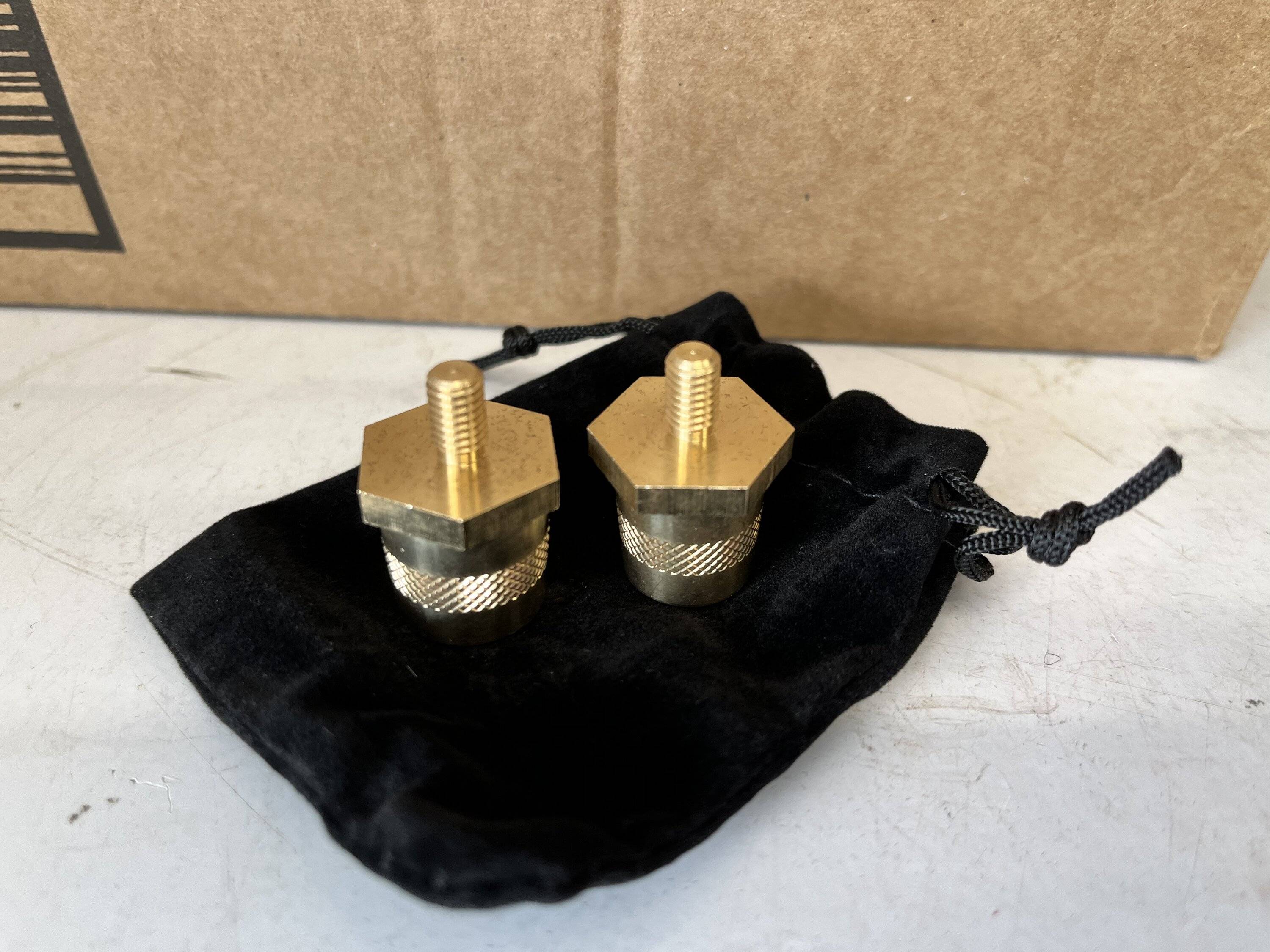

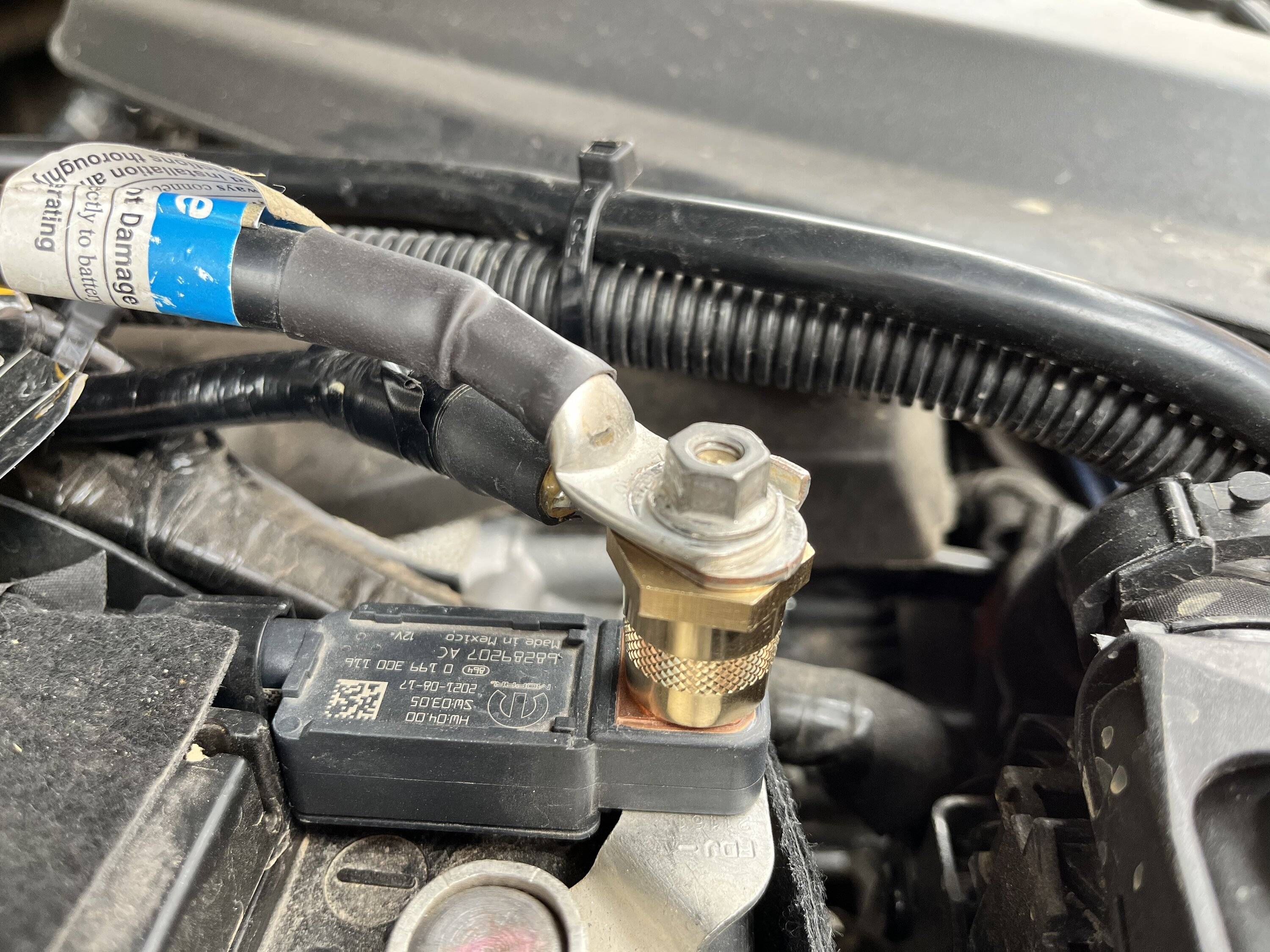

Another option in this vein. There is a "thicker" version of a nut called a coupling nut, that is made to connect two threaded shafts. If you put one where @BDinTX put these brass fasterners, you can use a bolt to connect the upper lines:You know… that probably would have worked. I cut the end of the L off trying this (the last hole is threaded):

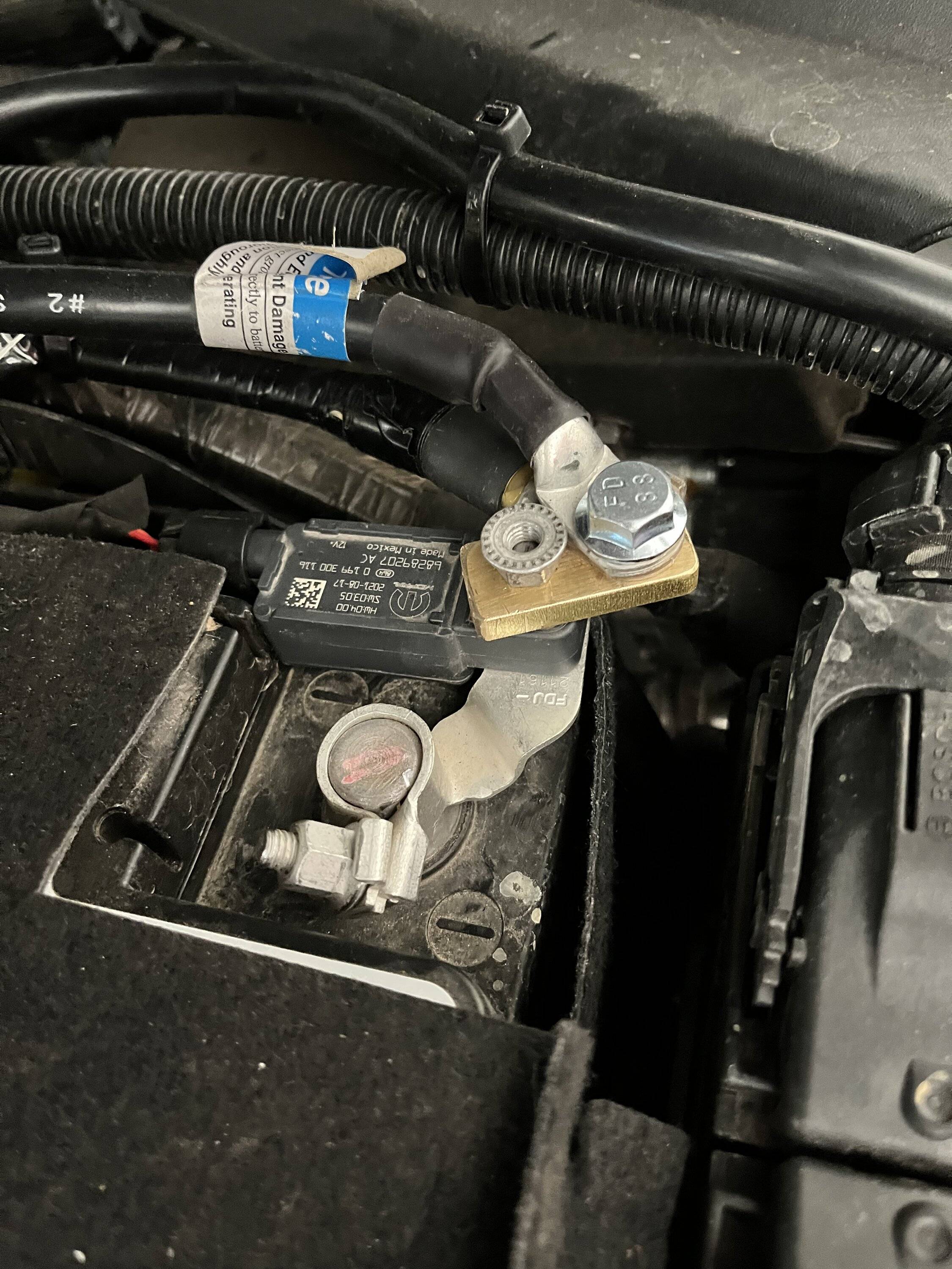

And then went to this, not perfect but better:
