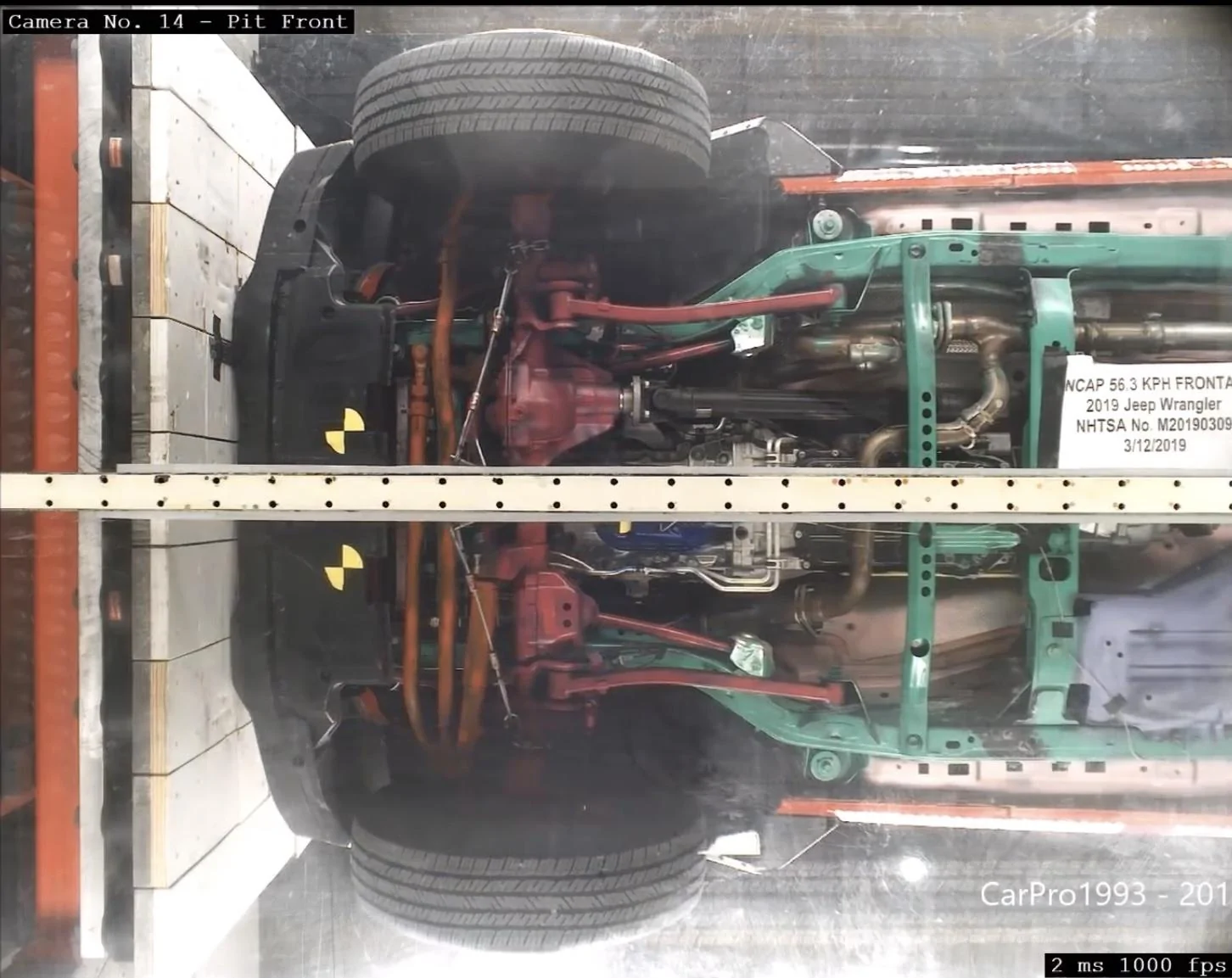

Most of the aftermarket lift companies that specify wheel backspacing are using their own proprietary tubular front lower control arms. The stock (and Mopar lift) LCAs are bent inwards affording more space for positive offset wheels.

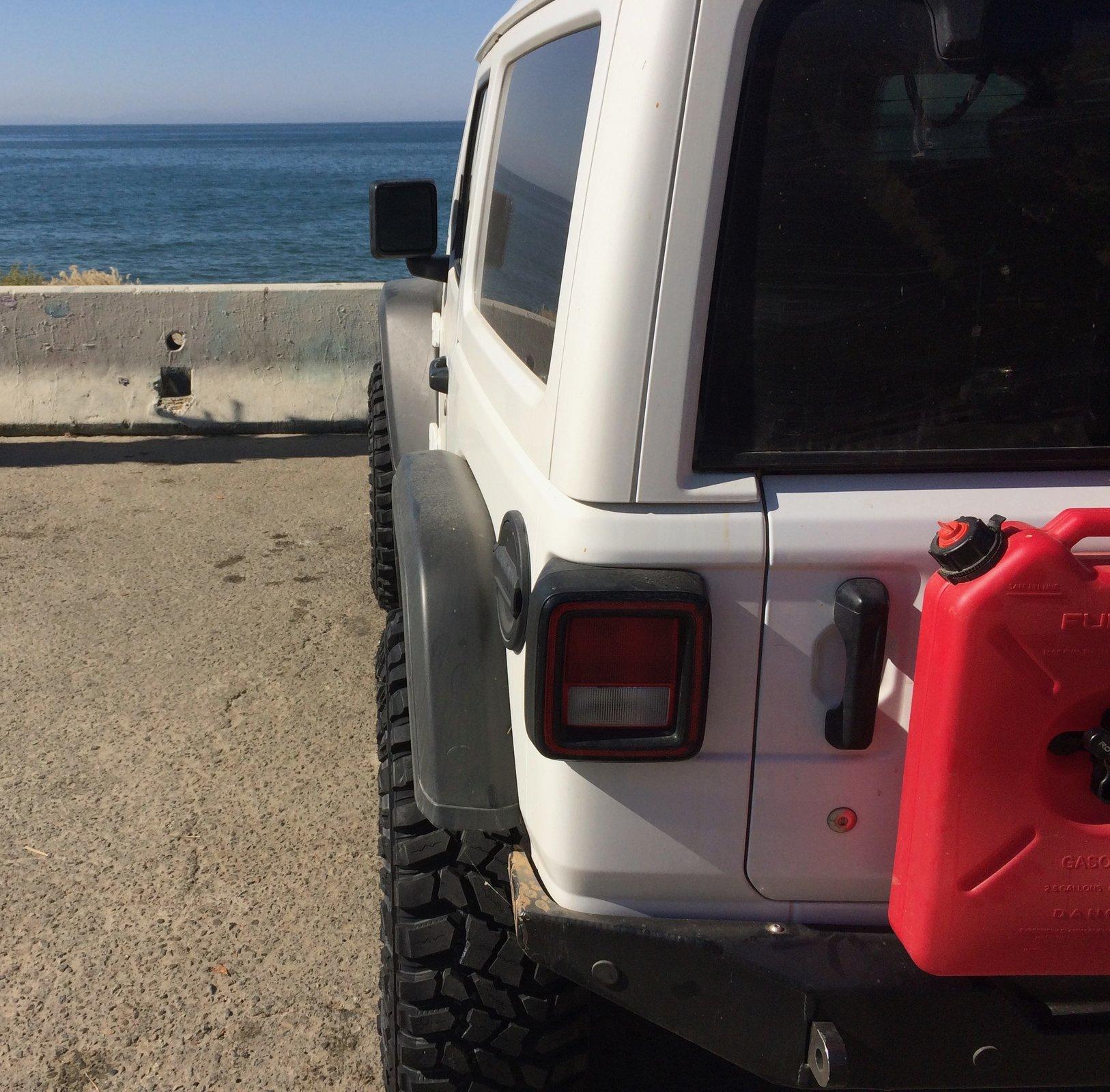

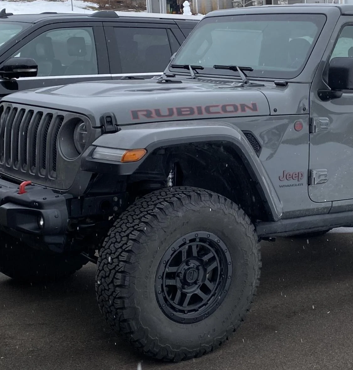

I spoke to AEV about there JL Pintler wheels with 5.77 +25mm offset. They said theirs works with 37’s and a 2.5 inch lift. Your JLR should be fine from my experience.
To keep the stock tucked in tire appearance and engineered scrub, I installed AEV JL Pintler wheels. Engineered for the JL these have worked on my JLR with 37x12.5 tires and the Mopar lift. I like the look and they retain the JL’s HD factory lug nuts too.
Jeep Wrangler JL Positive Offset Wheels with Rubicon Axles JL tire stick out

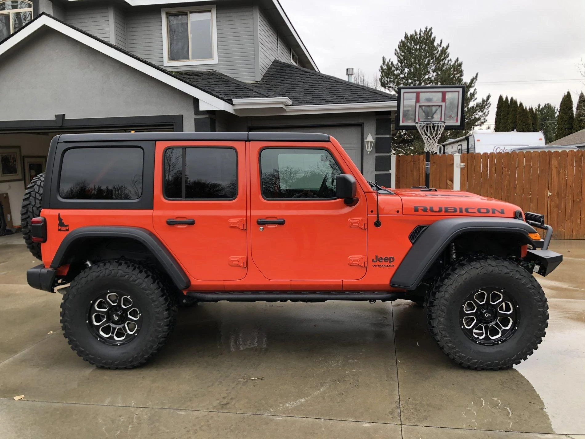

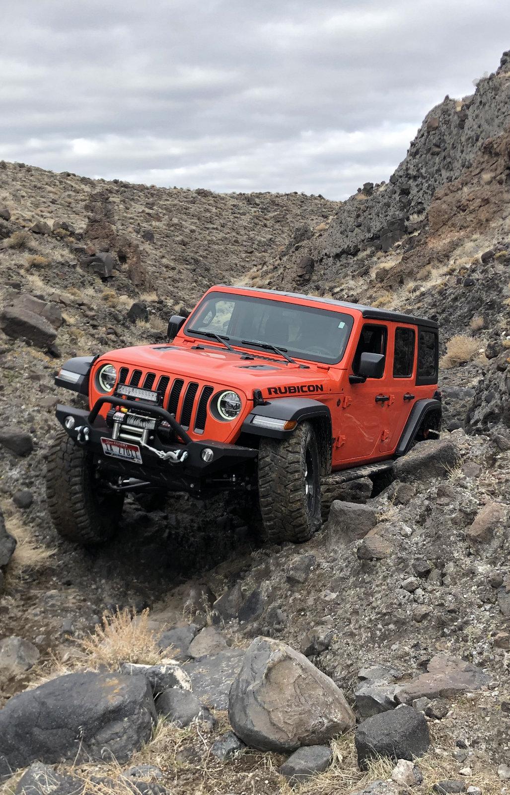

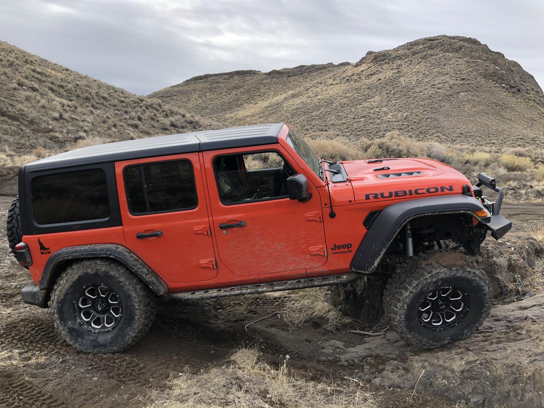

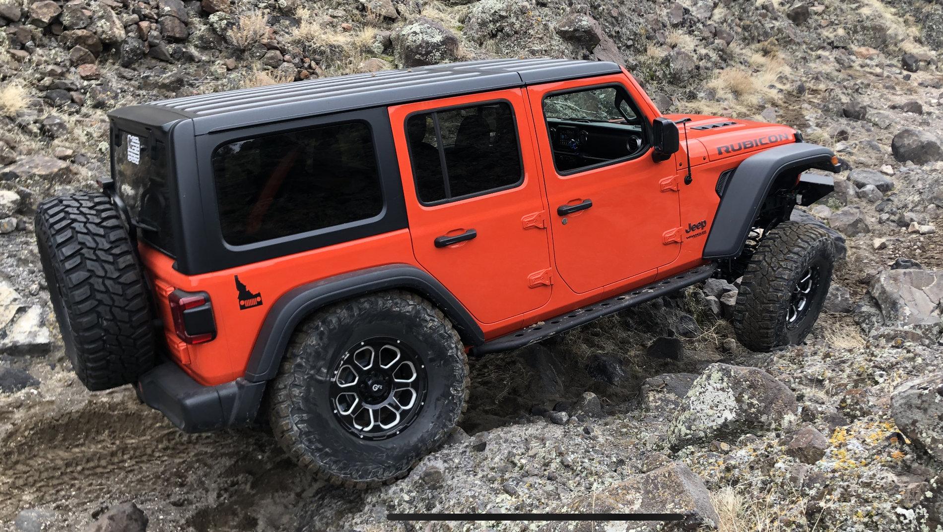

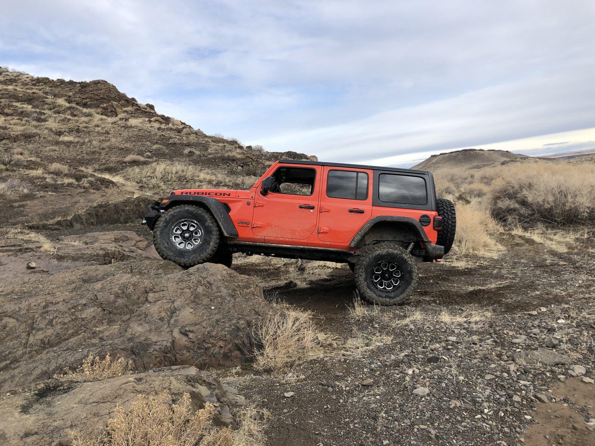

I’m running 17x9 +12 offset wheels with 37x12.5. Only place I rub when off roading is the rear wheel well liners and it’s not that bad at all. Haven’t had any other tire/wheel problems. I also am running the mopar lift with an adjustable front track bar and rear track bar bracket.

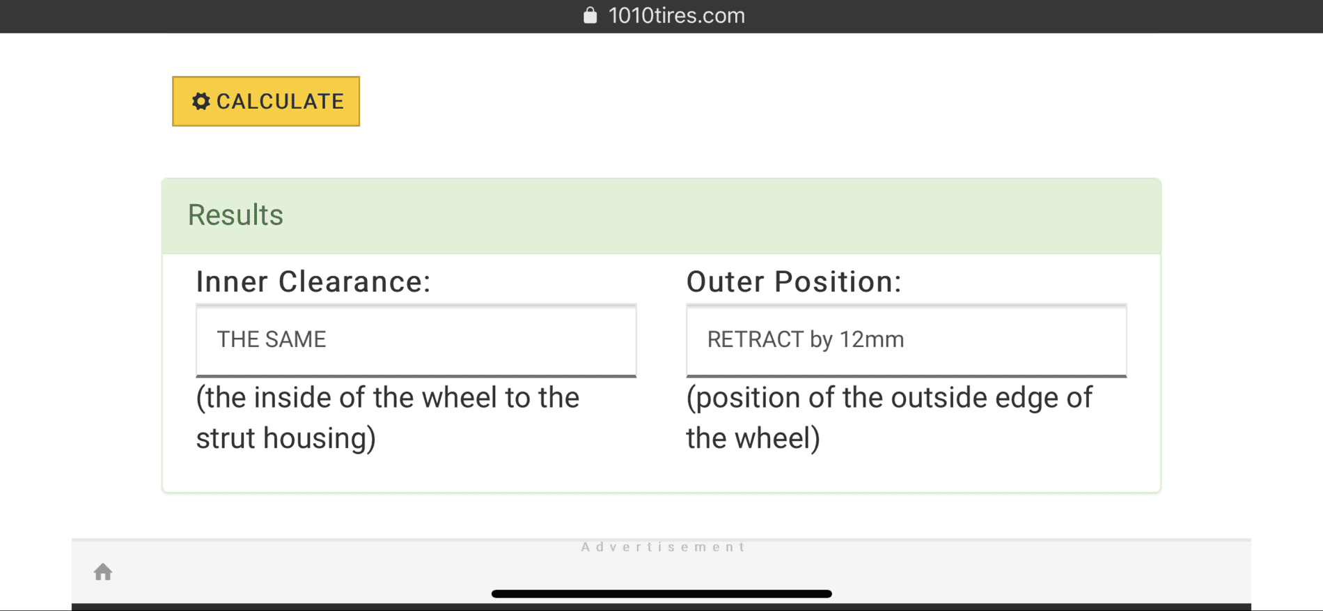

The wheels you are thinking about would have just as much inner clearance as mine but less poke
