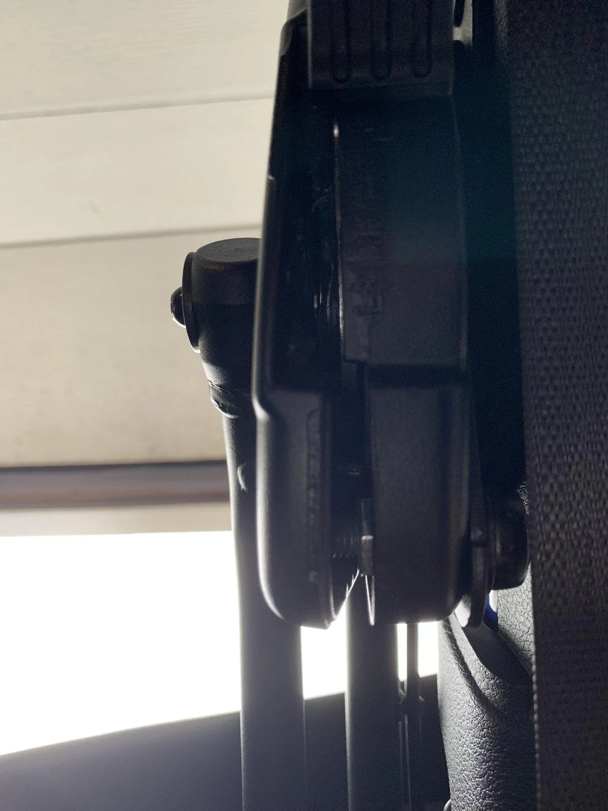

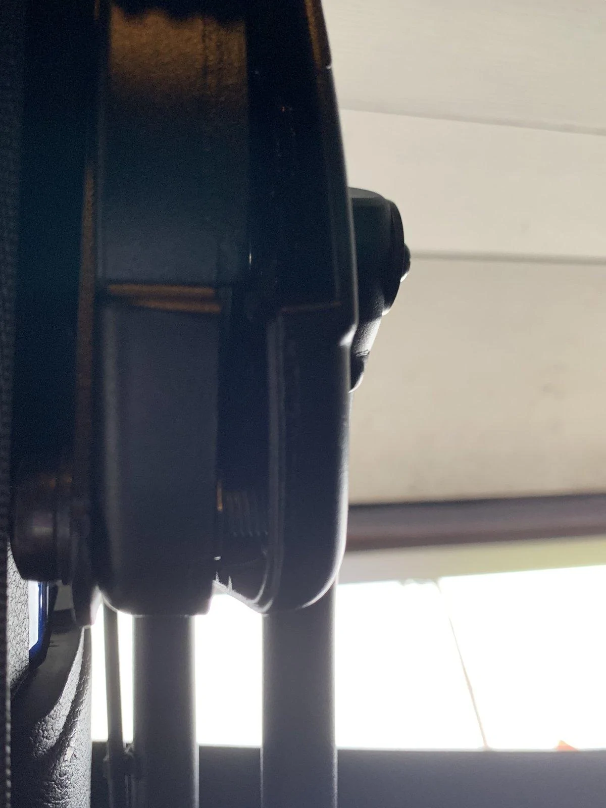

Having an issue with my soft top which was just installed by the dealer. I put it down fine but it will not go back up the whole way. It gets hung up and the problem seems to be with these brackets. Do these pics look normal? Both brackets look like this and I have a hard time believing this is right?
Those look like they are separating. Mine are much tighter, there is no visible opening on the seam. There are some bolts on the face of the brackets, can you tighten them down? Maybe put the top all the way down first.

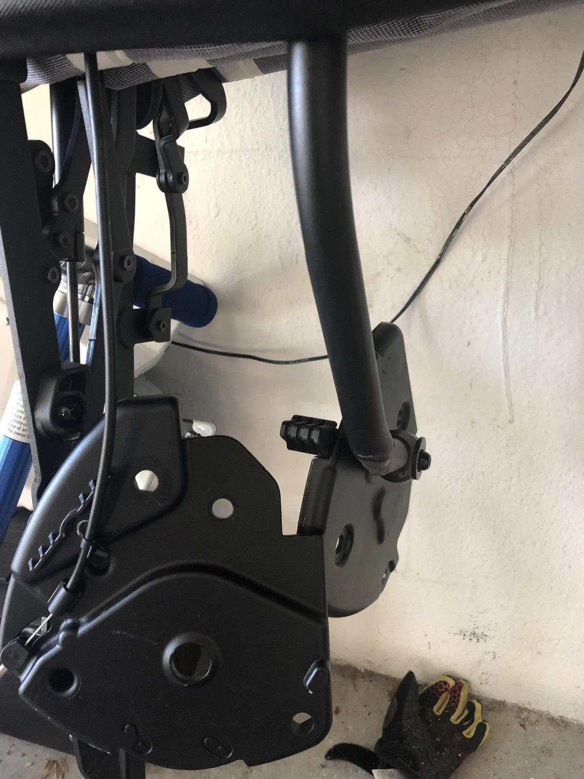

Does anyone have an idea what this part number is? The bar is bent and now the locking mechanism was taken apart and it’s almost impossible to put it back together and get it to work? Please help

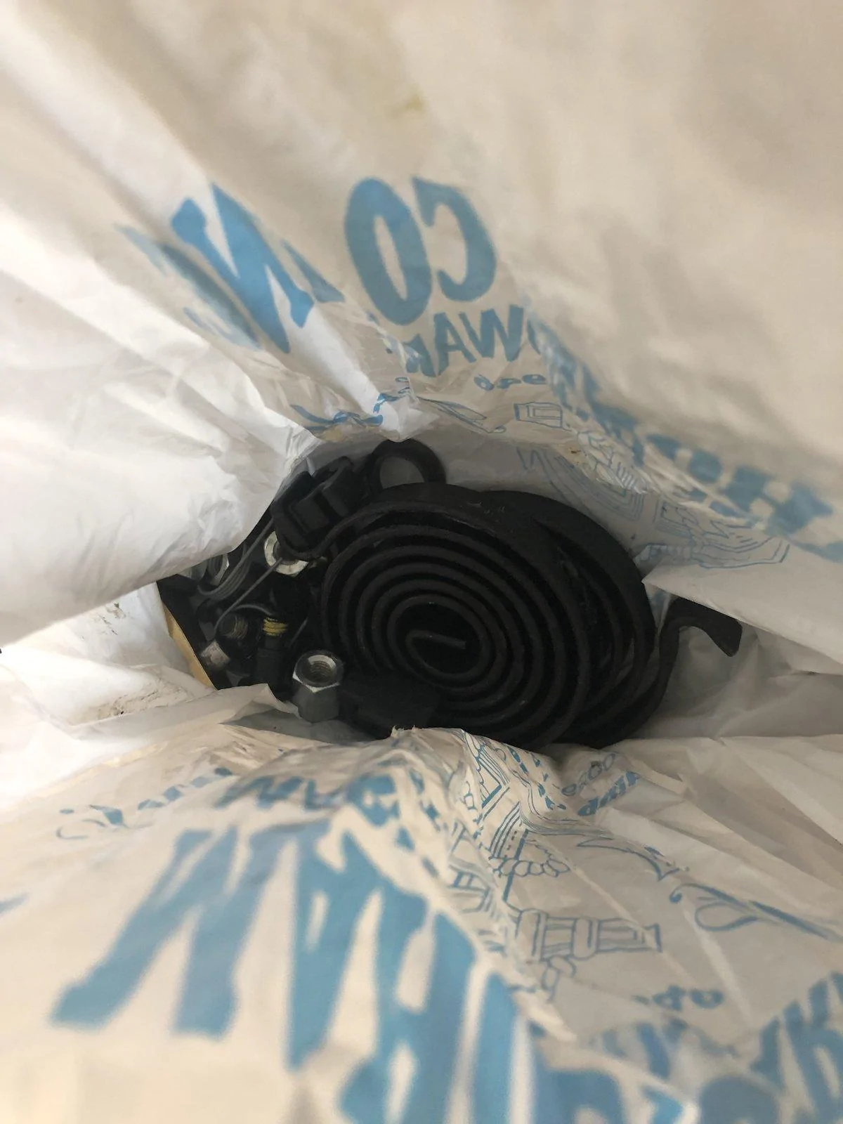

Here is a pic of the internal part of the locking mechanism. Do not even attempt to open yours. Learn from mine

I had the same locking issue installing my new soft top.. i put the top in, and attached with the screws...I was able to get it to unlock by leaning down on the back of the top, pushing it down toward the back of the jeep which let me unlock it. I’m going to follow up with my dealer, didn’t seem normal.. glad I got it unlocked though!

Just had the same issue today and now have a slightly bend bar because i was pushing top forward and it wouldn't go , the mechanism is junk now i was told to bring to dealership so they can look at it and fill out a warranty claim... Anyone else have any luck?

I had the same problem with my brand new softtop today. After trying different things the thing that worked was pushing down on the top itself while pushing the switch to unlock. Must have been upward pressure on the lock from the top not being all the way compressed. Hope that helps.
