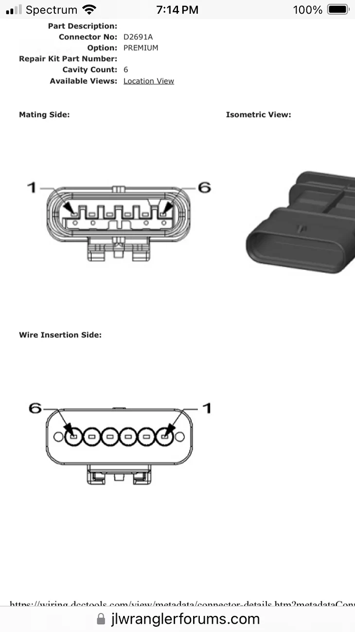

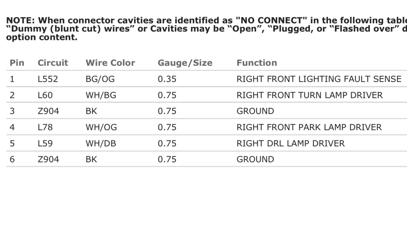

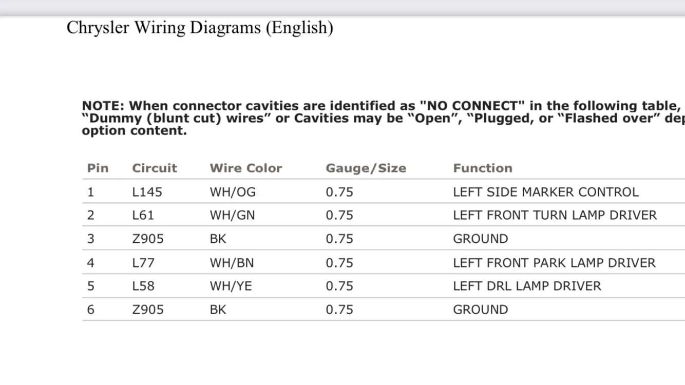

Just making sure you have the correct wiring diagrams-
Jeep Wrangler JL DRL issue, please help. IMG_4434
Jeep Wrangler JL DRL issue, please help. IMG_4431
Jeep Wrangler JL DRL issue, please help. IMG_4435
Jeep Wrangler JL DRL issue, please help. IMG_4475
I dont think I understood any of this … 😭

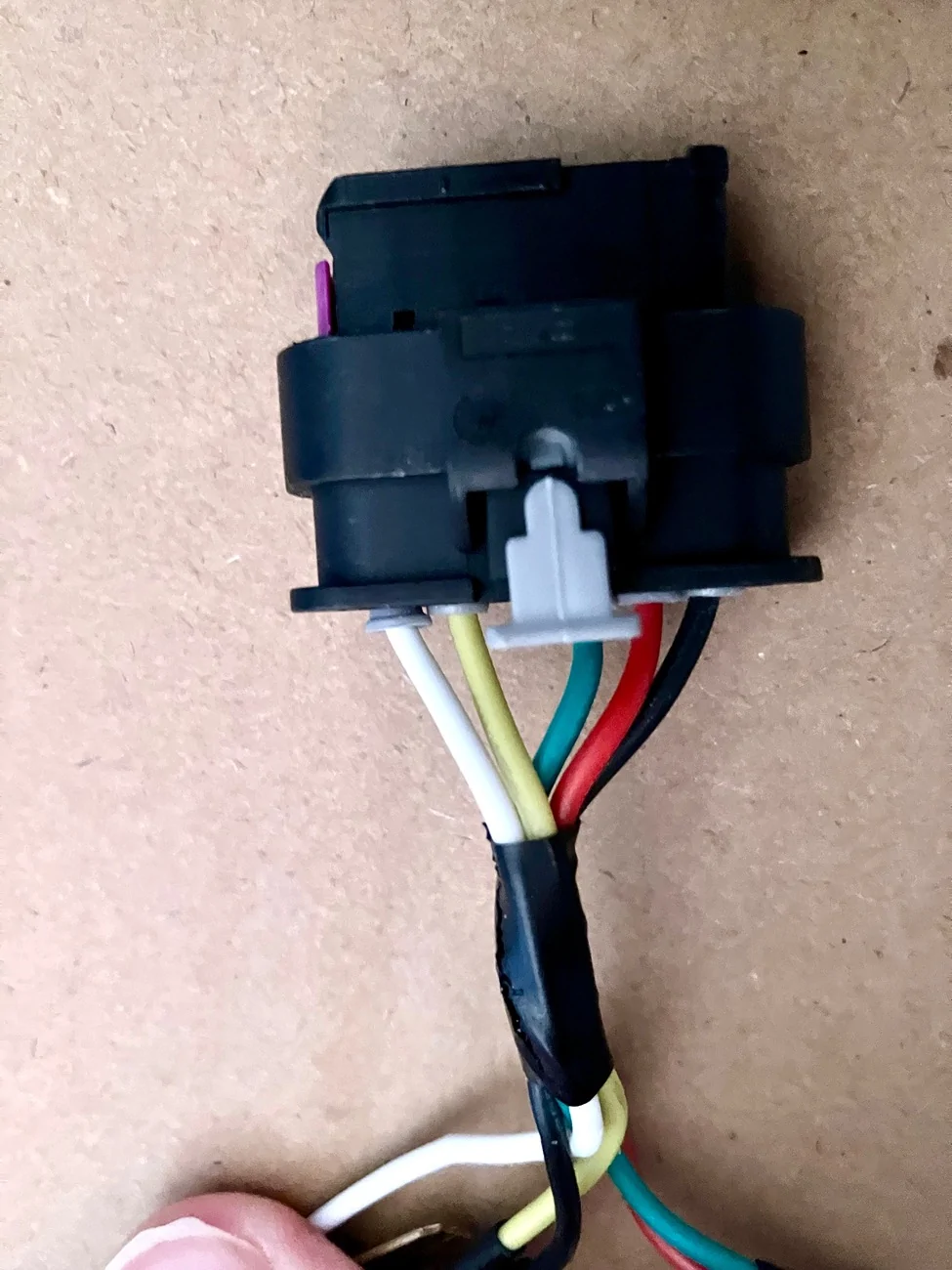

i installed these Skyline headlights following the manufacturer instructions and video, here it is:
I have everything as is. I tapped into the brown/yellow wire for the DRL, green/white for turn signals. Everything works as should BUT when DRLs on, they shut off including the driver’s side turn light.
Those are for the jeep fender lights. Details which light in the fender harness is for each action on the turn signal. Do the reverse of what you were doing. I missed the point on what you were actually doing. I thought you were installing the DRLs.
