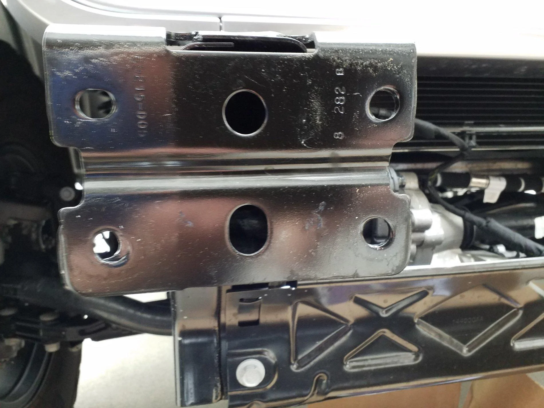

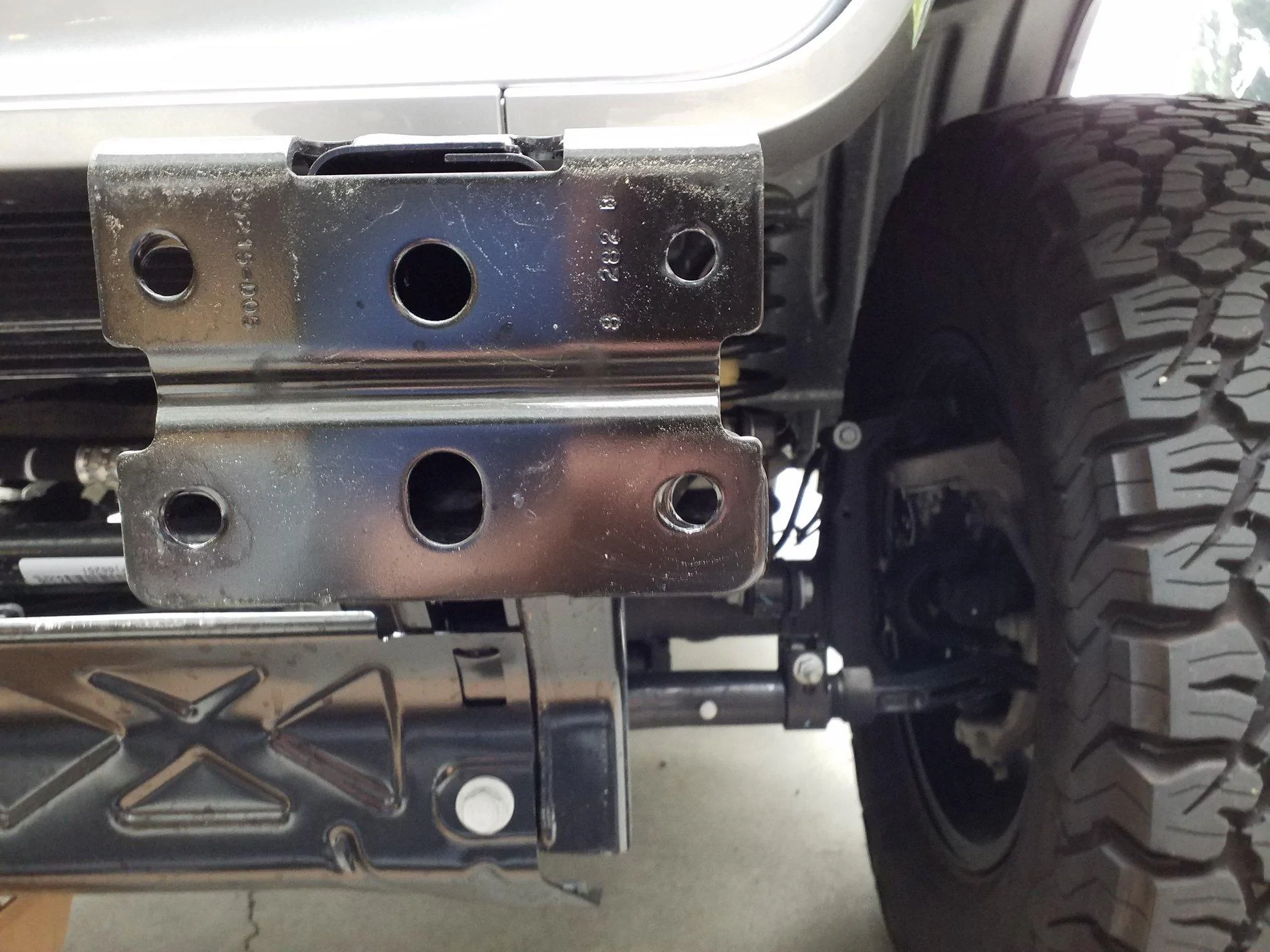

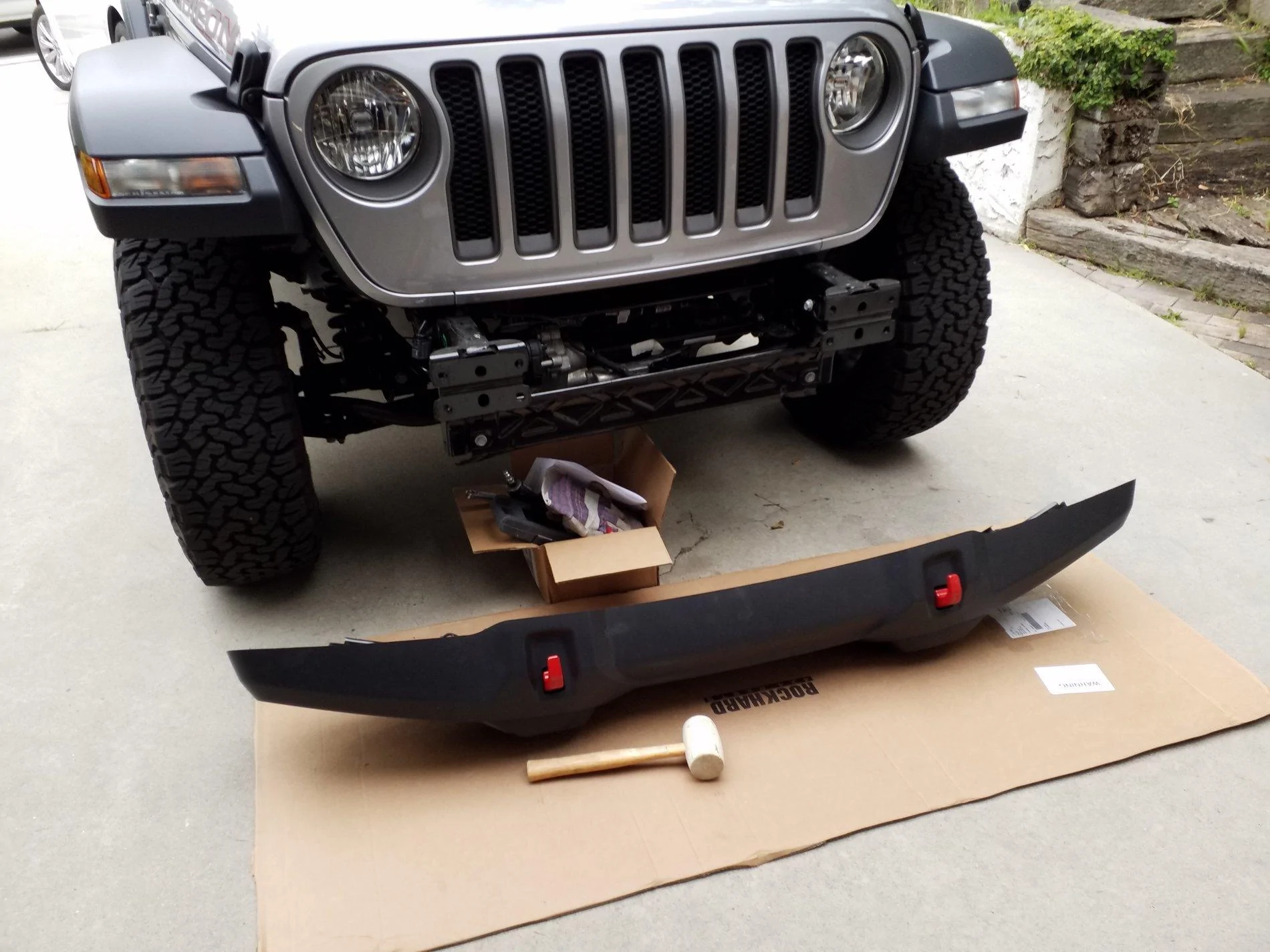

Got it. Just some moderate smacking with a mallet and it started moving right away. The lower holes where the doubler brackets sandwich with the frame were misaligned. I had thought about loosening them, knowing it was a possibility.
Jeep Wrangler JL Plastic Rubi Bumper removal 20190504_074532
Jeep Wrangler JL Plastic Rubi Bumper removal 20190504_074559
Jeep Wrangler JL Plastic Rubi Bumper removal 20190504_074623

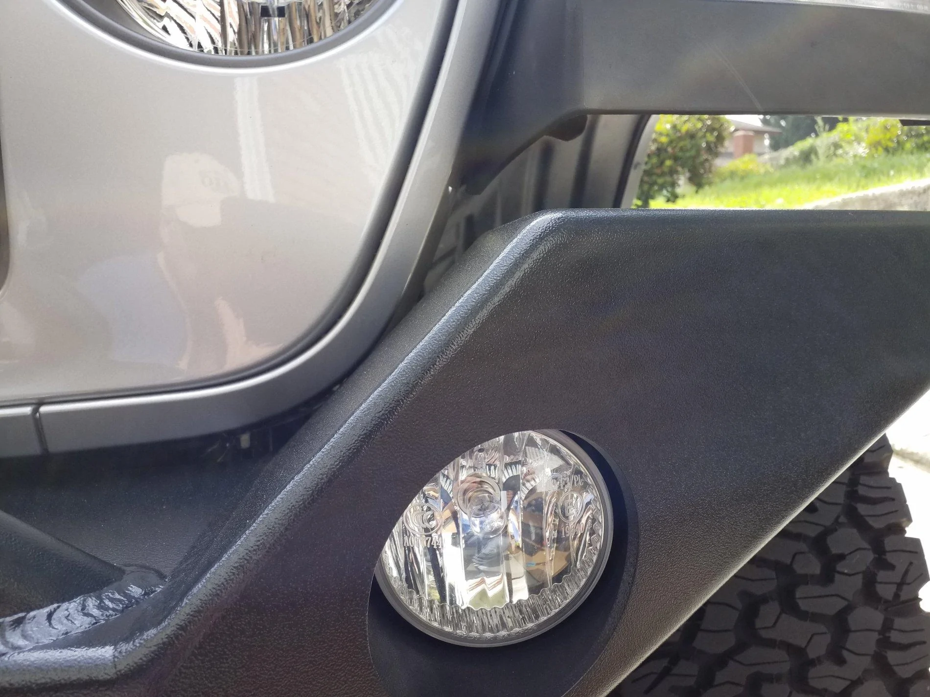

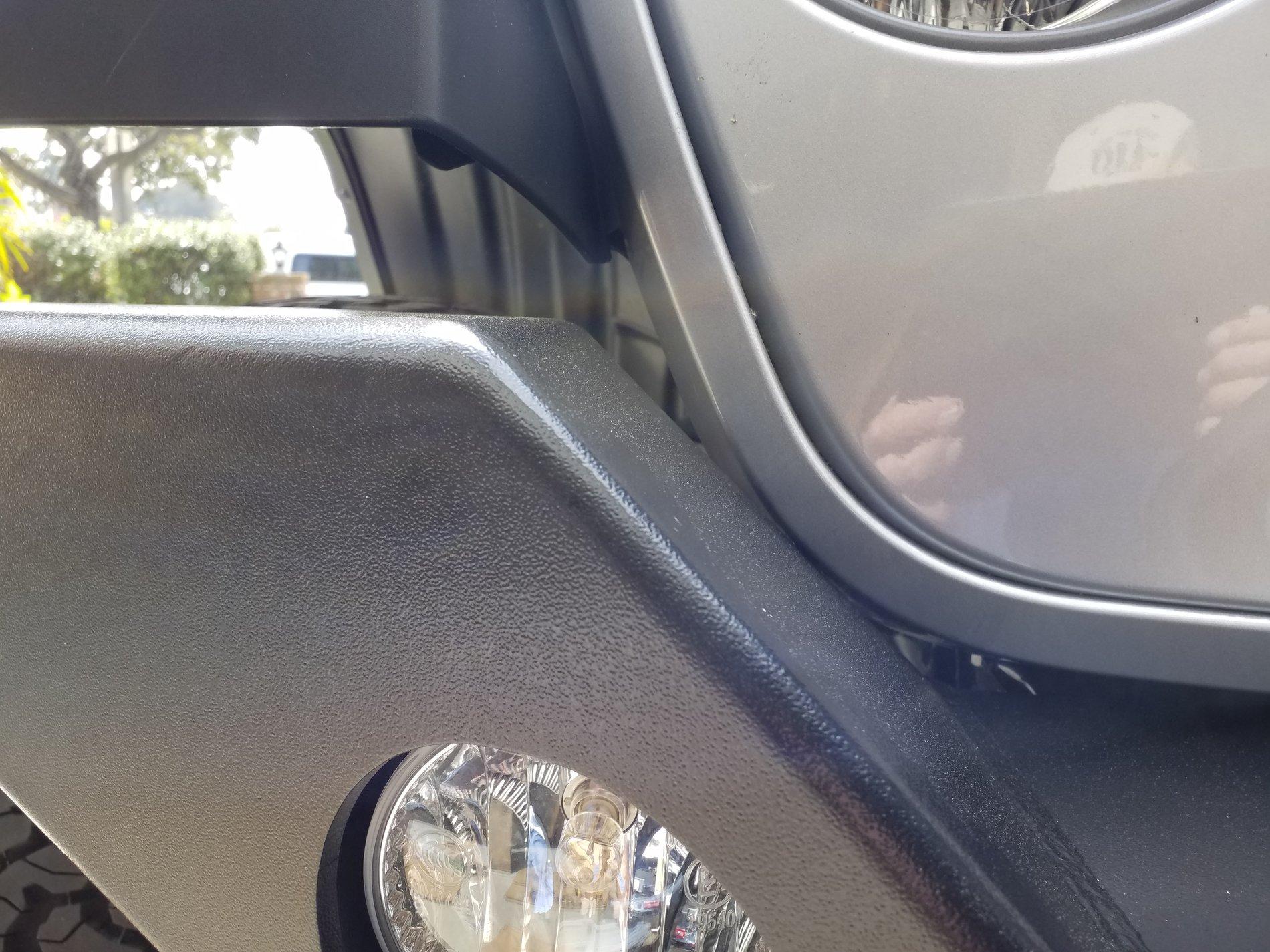

Anyone else with a RH 4x4 bumper have this riding condition? Is it too much to ask for aftermarket stuff to just fit? Looks like it'll saw a hole in the grill facia in a week or two.

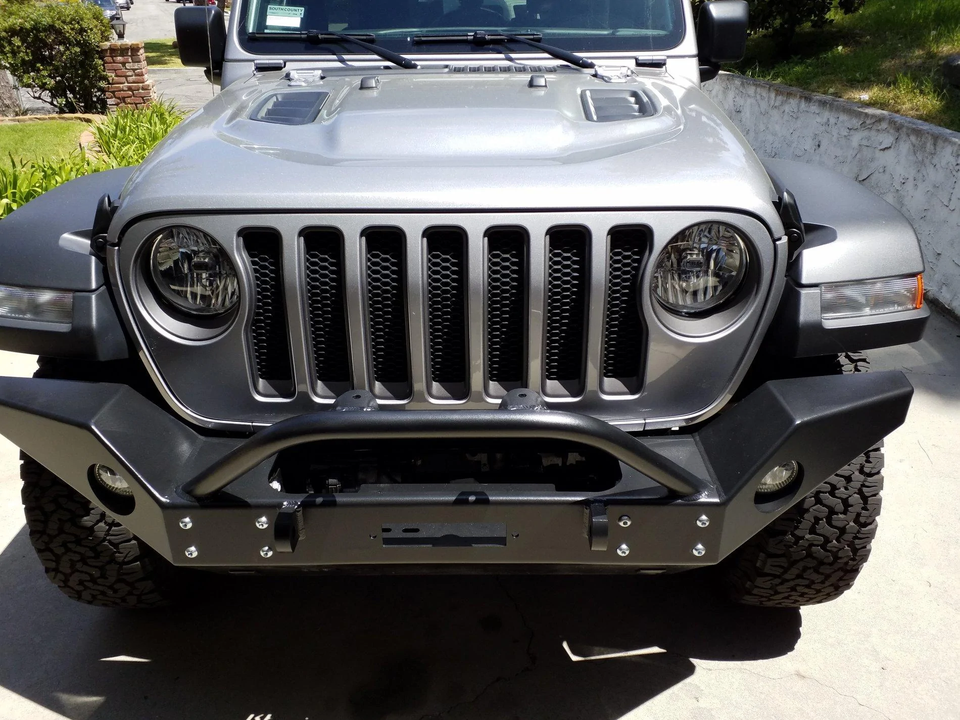

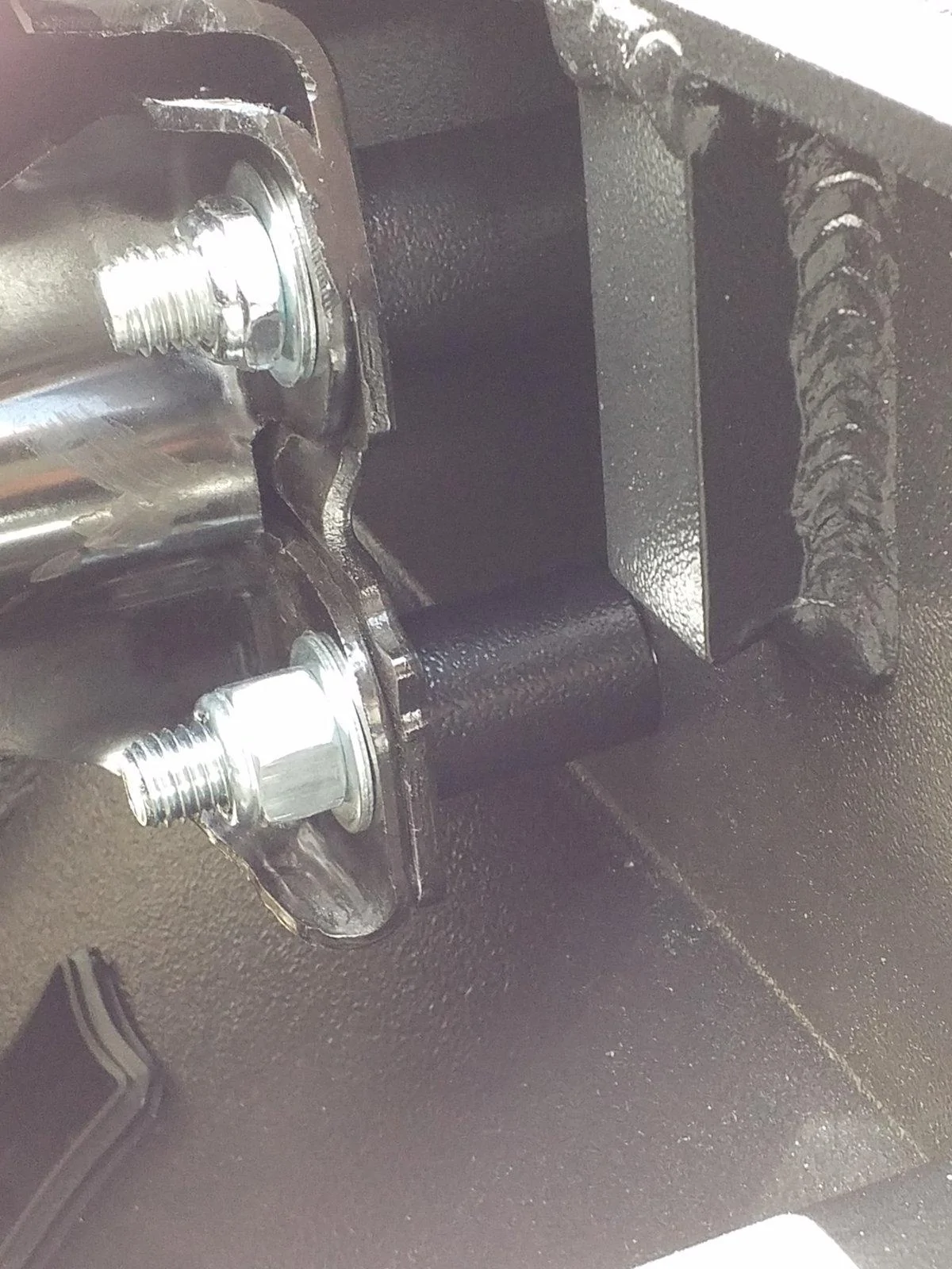

Sorry, false alarm. I got ahead of the instructions where it requires spacers in front of the bumper flange.
Here it is installed.
