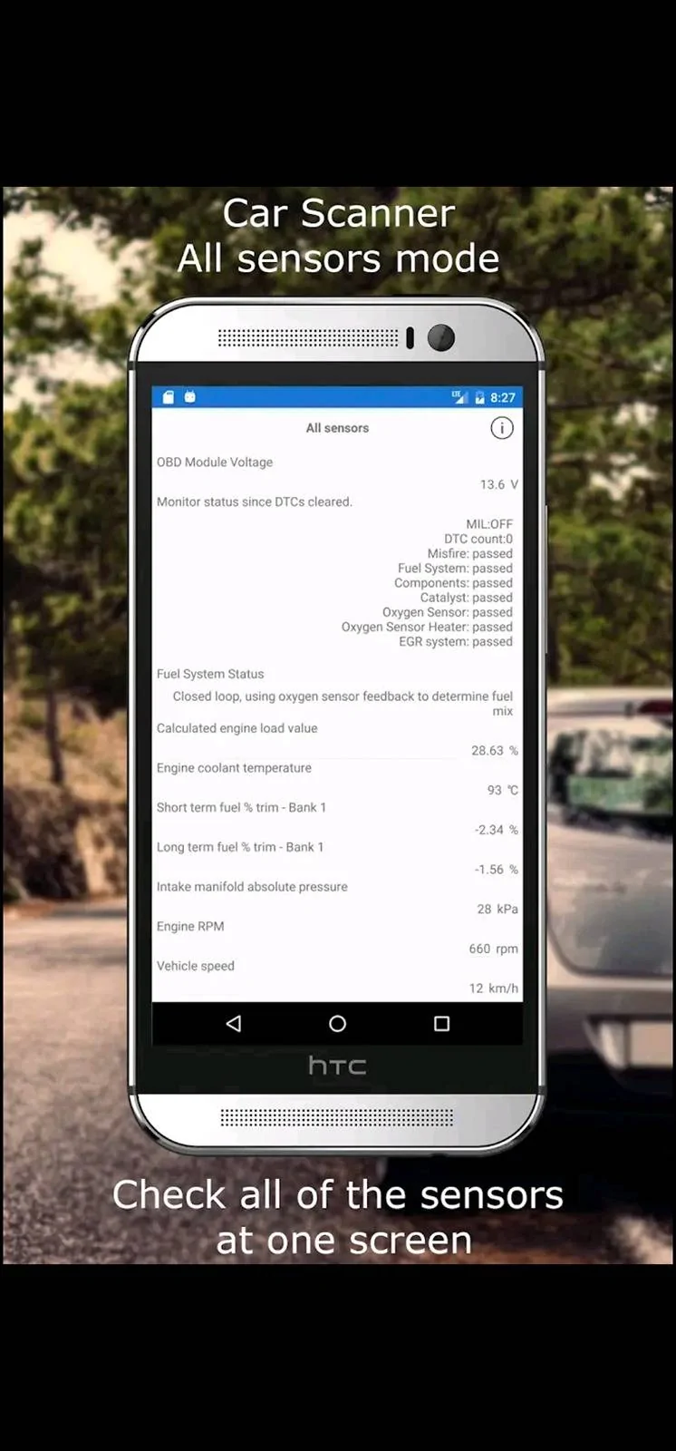

I did this on my WRX. I don't remember the specific app but recall finding it by looking at the images in the app store for readiness checks.
Jscan may do this. Haven't had to look.
Car scanner elm obd2 looks like a winner.

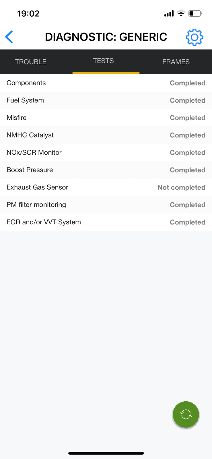

Click on quick diagnostic in the first screen of JScan and then click on tests and you will get the readiness tests.
Jeep Wrangler JL Passing Inspection after battery change IMG_8071
You don’t even have to hook up the bypass.
Jeep Wrangler JL Passing Inspection after battery change IMG_8072
This is the current test on my diesel Gladiator
