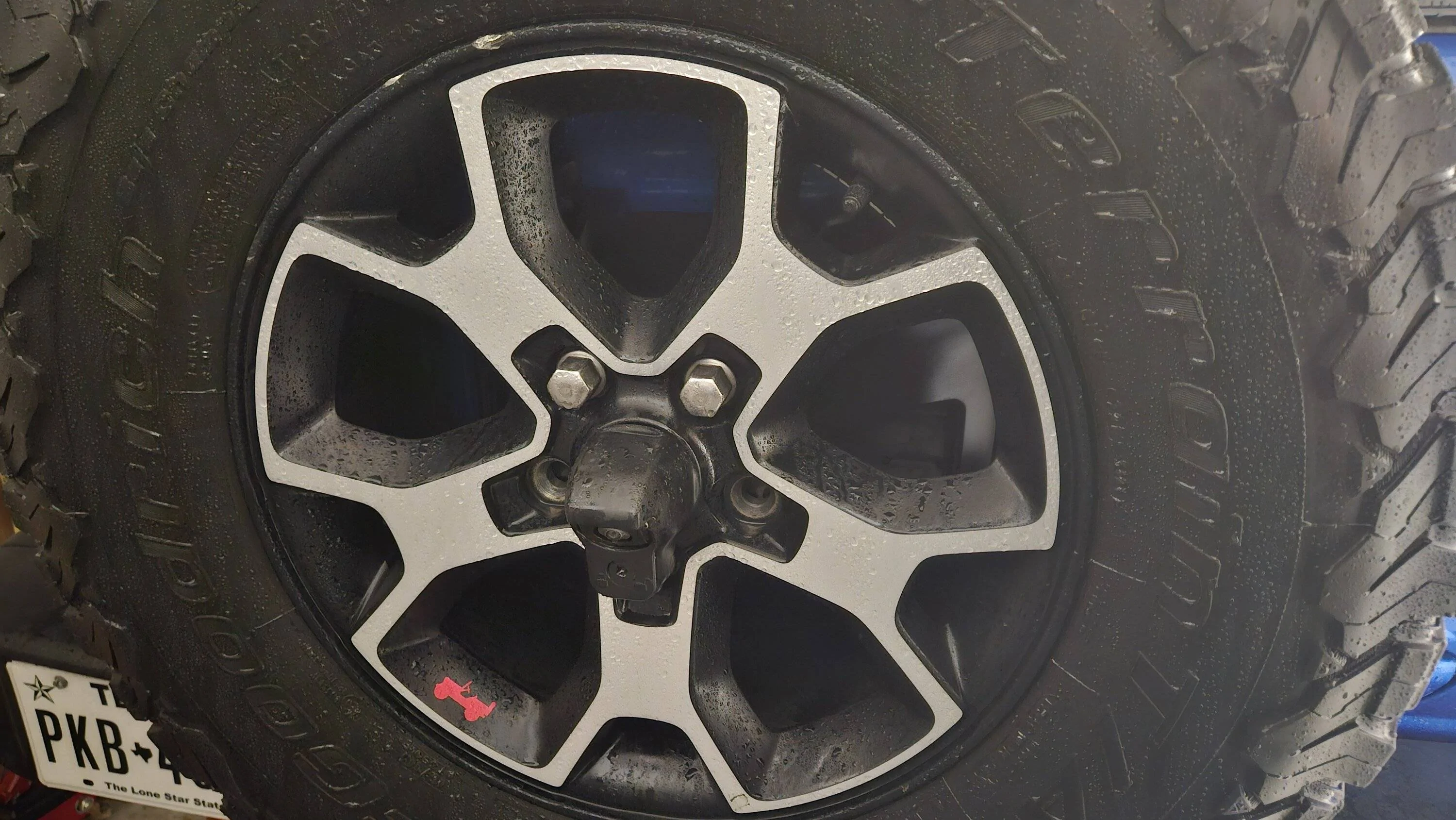

Yeah, I'm still dumbfounded that this worked, and irritated, as well. I know for a fact that until about 10K miles ago, I *always* had the spare tire valve stem at the 6 o clock position, because my OCD would have demanded it be so.
However, I rotated it so that the valve stem is above the centerline, and lo and behold, all is well. I just have to pretend to not remember that it's off kilter back there.
