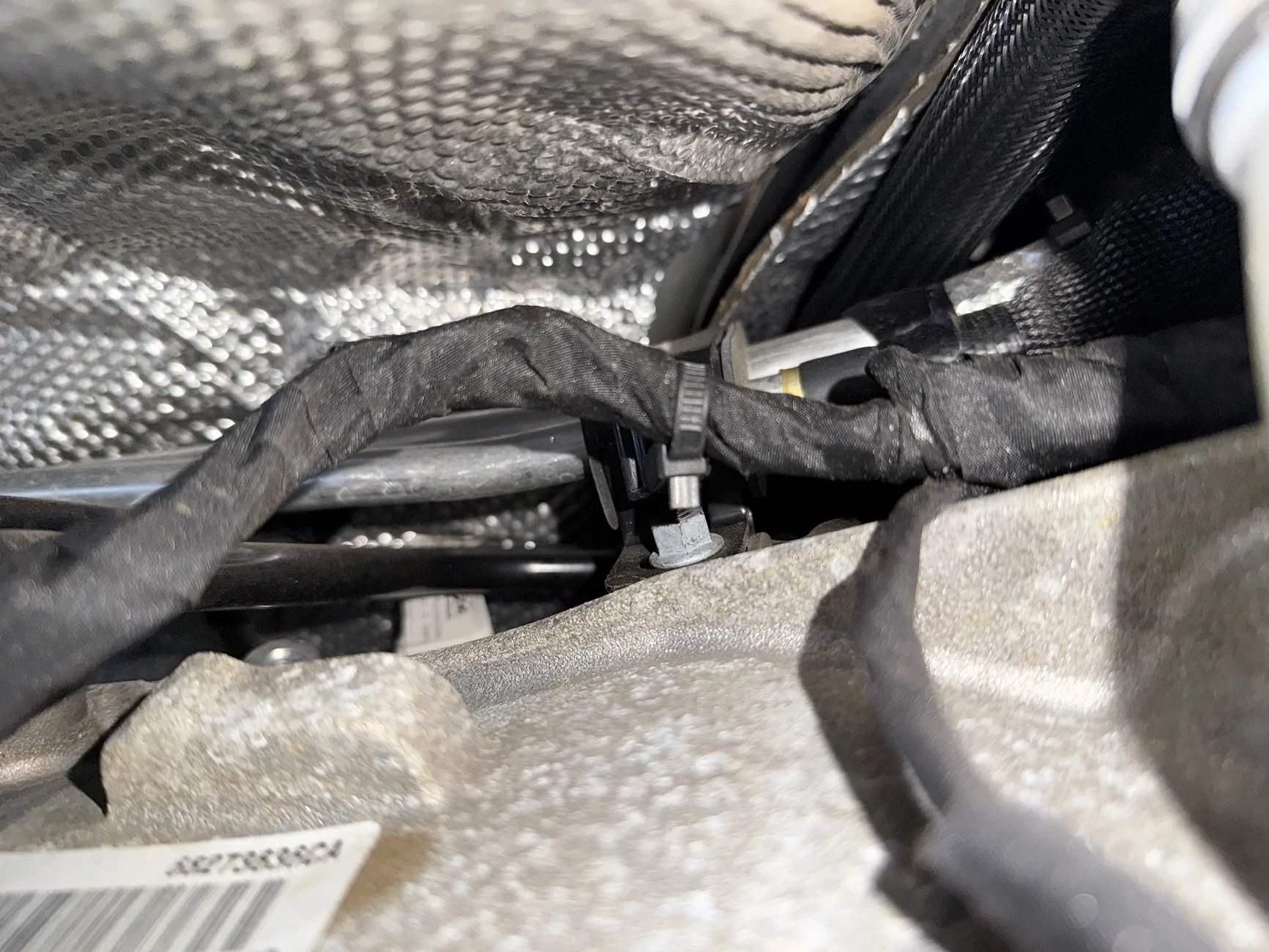

i really hate posts like this, i understand you're trying to help but its just filled with wrong information. neither the battery nor fuses could cause this concern, nor the symptoms, and comparing it to a completely different make/model is always a bad habit.
Anyway, check the harness alongside the passenger side of your bellhousing to see if it's rubbed through. There's a tech 2 tech thread with this exact DTC and similar symptoms and that's what they found. It would explain the intermittent nature of it as well. If nothing is found replace the fuel pump

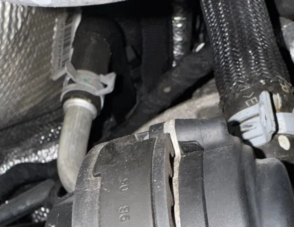

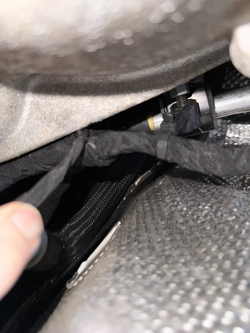

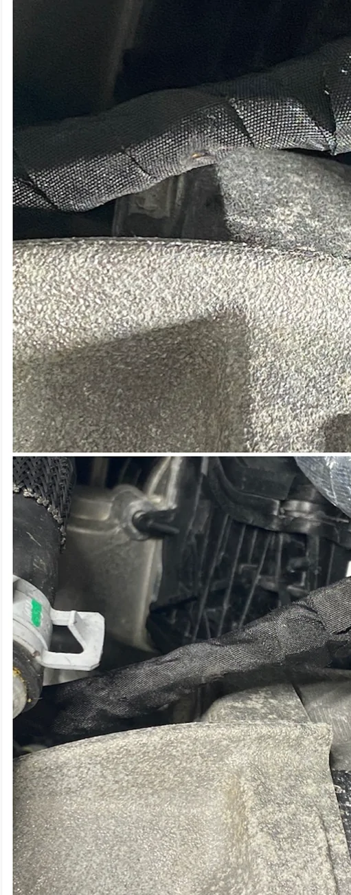

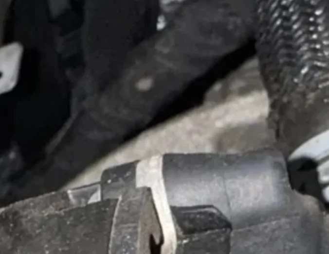

@alphawolff Okay it was hard to get in there and tell, but immediately upon looking up, this smaller wiring harness was laying right on the sharp edge of the bellhousing just like you said. It almost does look like it has a little cut in it, but hard to tell. It goes into that black solenoid looking thing. Could this be the issue? Thanks!!

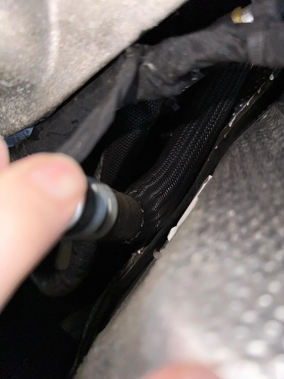

Take a closer look at this area. That white mark on the harness indicates it could of possible been resting on the bellhousing. Make sure nothing is exposed and push the harness up and off the housing if you can. That broken retainer you mentioned isn't noteworthy.
sorry @alphawolff in my first pic I was just referencing where that smaller wiring harness is laying right on the edge of that sharp bellhousing area. I wasn’t sure what that actuator/regulator whatever that black circular part is that set of wires runs to.
I will get under there again with a better light and do more searching. Probably take my glasses with me too. 😀
I was wondering, I am assuming if it is chafed it’s grounding out on the bellhousing right? That is the only thing causing the issue? What if I tape it and wire loom that harness up?
