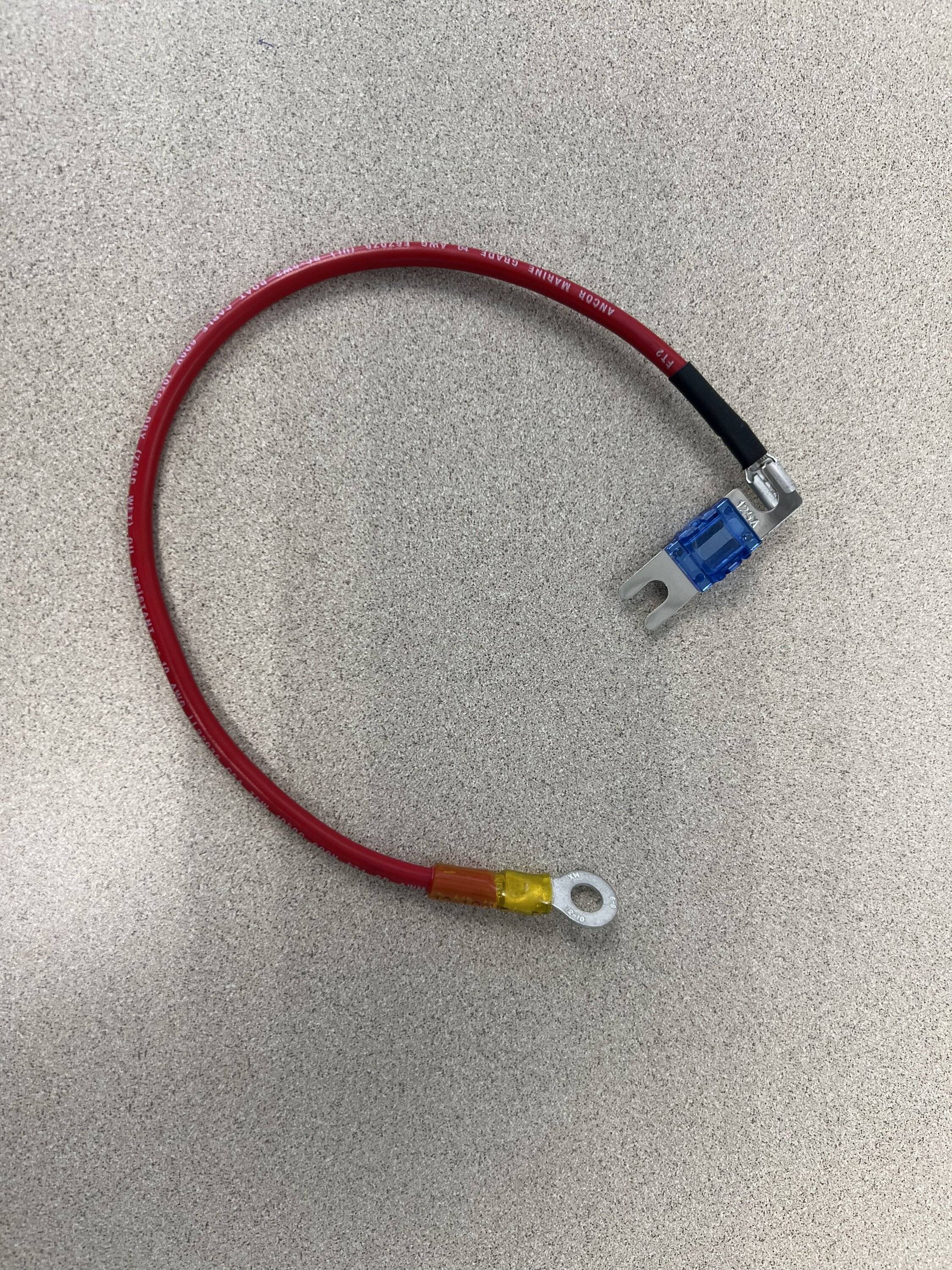

For about $20 total, you can pick up a few fuses and make your own emergency spare.
Jeep Wrangler JL Own an extra High Amp Fuse Array F9EA1FB9-2D99-4A00-90D8-60FA1EC4C63F
Connect one end to the PDC power feed and connect the other to the blown fuse stud. Much quicker, and no chance of wasting $60-$80 bucks on a fuse array if it blows right away.
