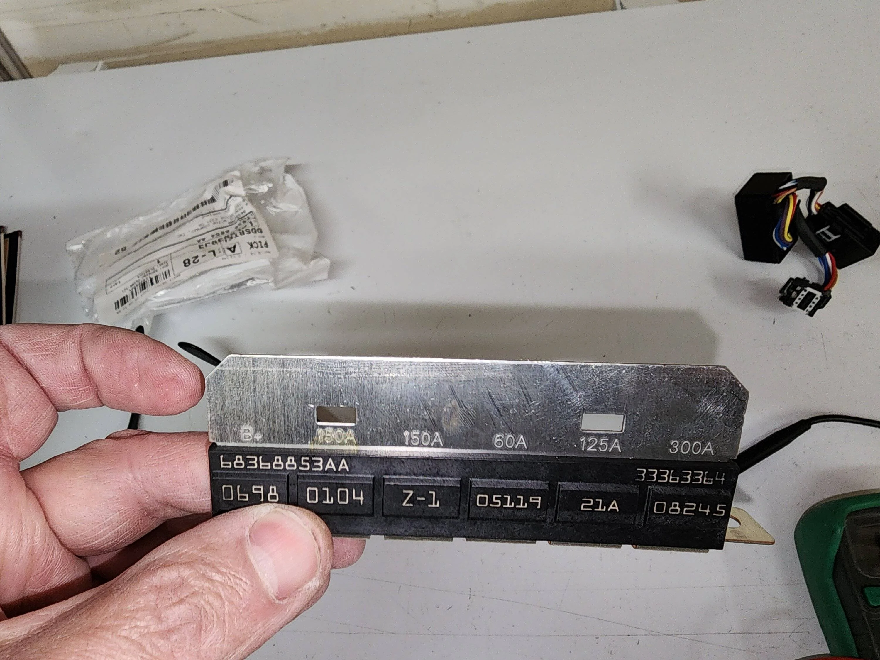

FYI - the towing package DOES NOT guarantee that you have the 100A version of the fuse array. My 2019 Rubicon has the "Trailer Tow and HD Electrical Group" option, and it had the 60A version. I discovered it when I replaced it with the 100A version.

Hmmm...the one in my photo is a 8853AA and it is a 60A. I bought two 100A fuses (one for a spare) because I plan to change my fan to a Gladiator model which requires 100A.
The 100A array is part number 68368854AA

Good idea! I just remember someone advising me to match the numbers as one did have a higher amp. I guess that makes sense since you’re upgrading the fan tho. Have you already installed it? Any issues?

If you have the tow package you would want the high amp fuse array with the 100 amp fan fuse. Probably because of supply chain issues some JL's with tow package inadvertently left the factory with the incorrect high amp fuse array.

Yes; it has been installed since 11 June with zero issues and it is 100% plug and play.

True; but just a note to remind everyone not to assume, but to verify if needed. I bought my Jeep before the COVID madness/supply chain junk happened, yet, FCA hosed up the fuze size.

Same for me.
