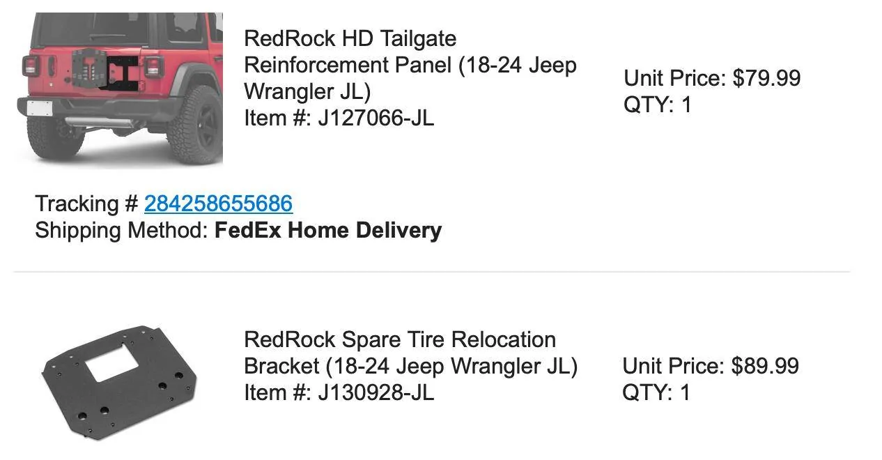

I was looking for the weight on the RedRock but didn't see one. I would appreciate a link for the TF aluminum one if you have it.
Jeep Wrangler JL Oversized Spare Carrier 4A326288-1C86-4AEC-8079-967FA73BDAF6
these, just go to TF, ET, 4WP, etc and search Teraflex relocation brackets. Simple install, I didn’t even unplug the inside the gate wires, just set the carrier on a trash can to bolt them on. Bump stop spacer kit included.

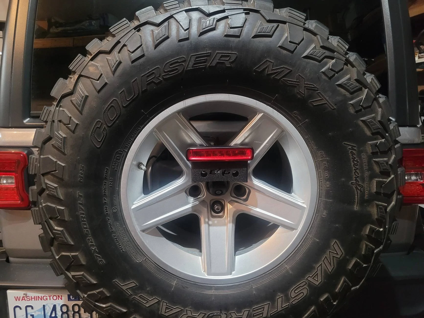

Mopar oversize tire carrier and tailgate reinforcement. Blocked the 3rd brake light when I went from 35's to 37s a few years ago. I bought an EAG relocation bracket. Mopar copy at half the price, and does not block the camera. Solid. No tire movement. No worries. JLUR is a 2018 so it's been carrying big tires for awhile.
Jeep Wrangler JL Oversized Spare Carrier 20240126_145130
Jeep Wrangler JL Oversized Spare Carrier 20240529_114857

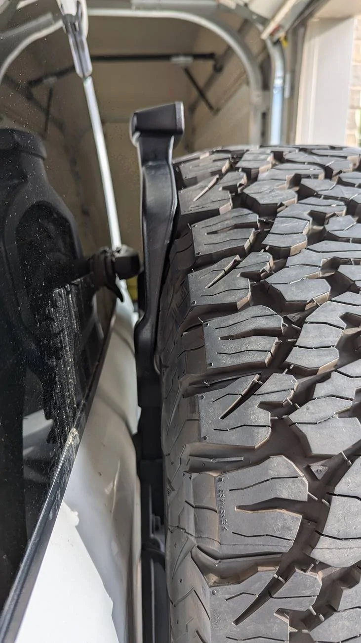

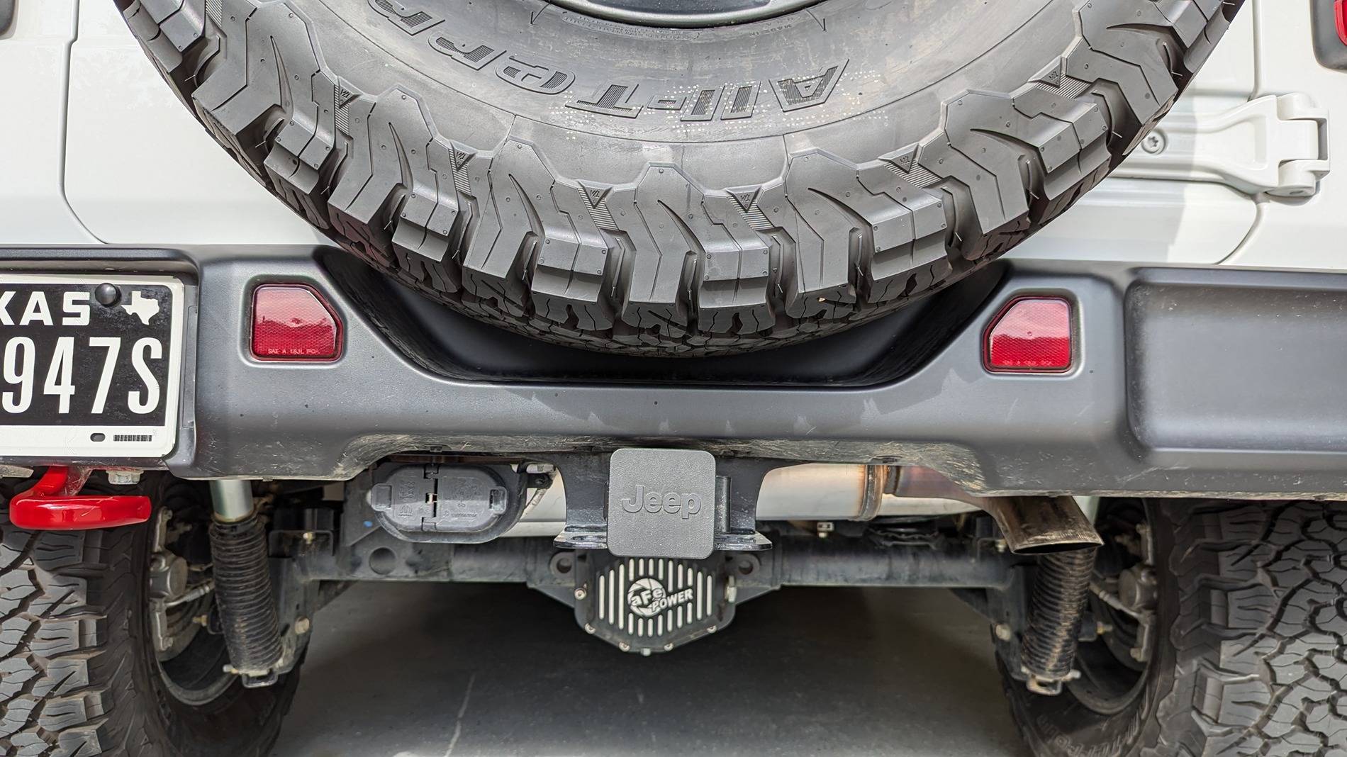

Stock carrier with 35 KO2s:
Jeep Wrangler JL Oversized Spare Carrier 1000002233
Jeep Wrangler JL Oversized Spare Carrier 1000002234

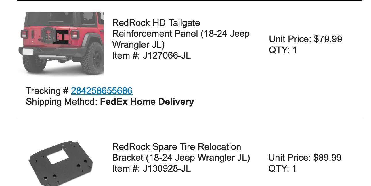

Sorry, but don't waste your money. I had this set up my JL and the spare made the tail gate bounce. You want something that will support your tail gate.
Jeep Wrangler JL Oversized Spare Carrier Screenshot 2025-02-09 at 7.28.13 AM

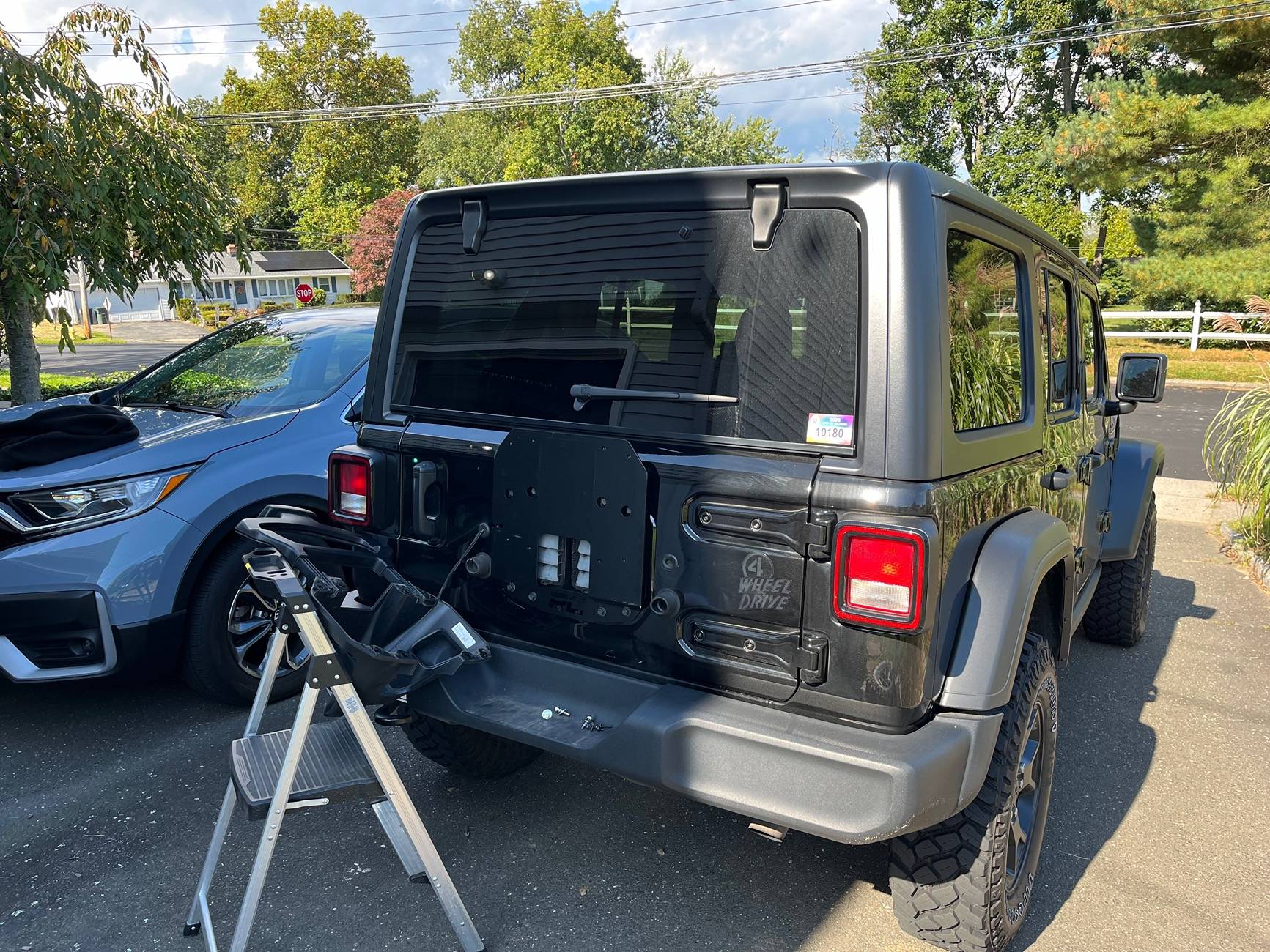

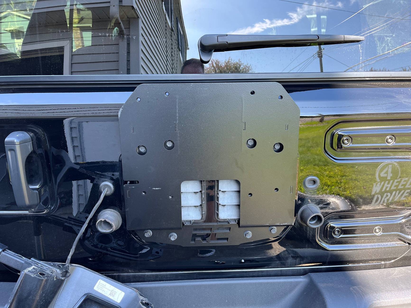

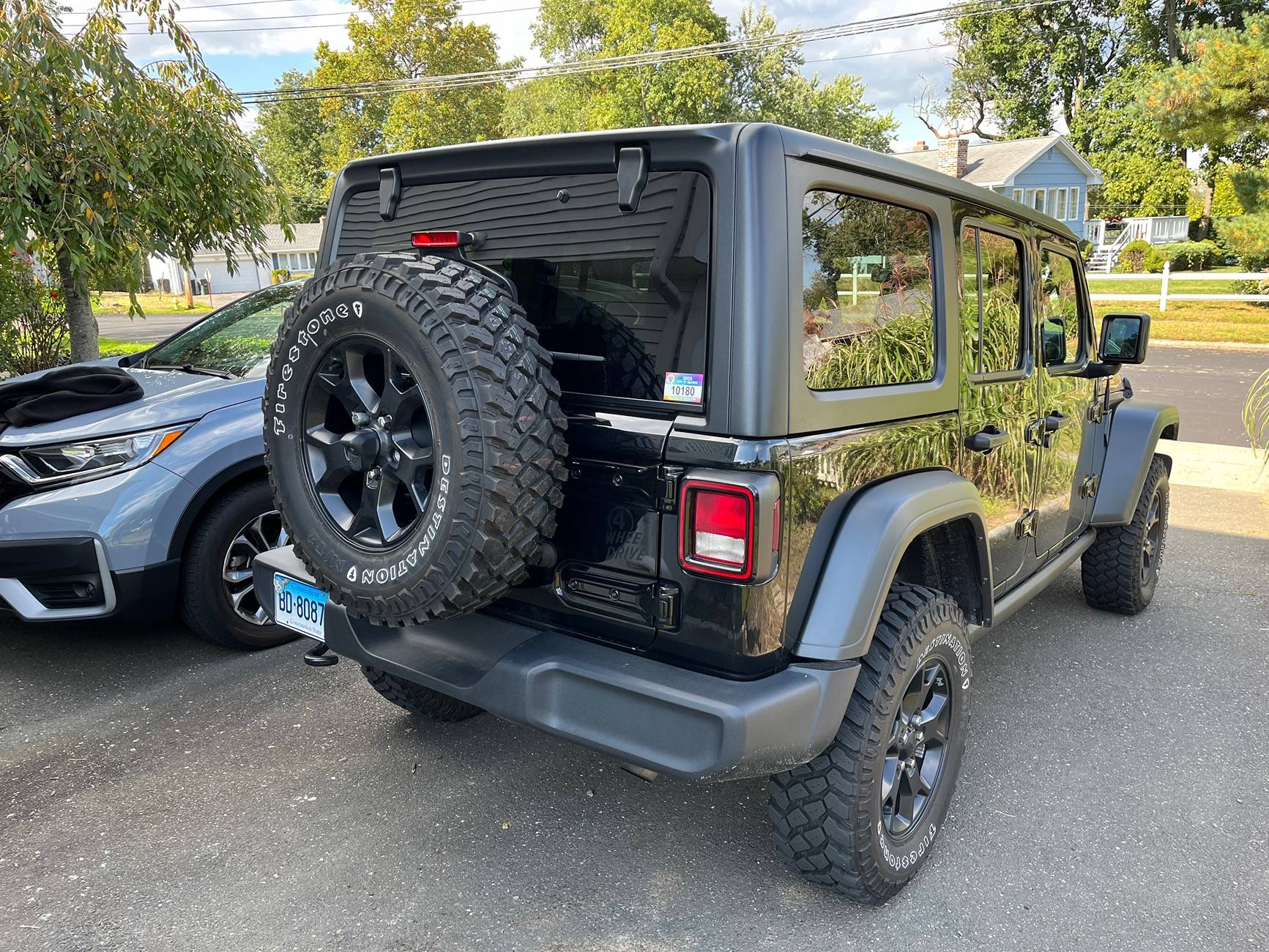

Where are you located? I have a bracket I’d let go for $50 bucks. I’m in CT. Fits a 35 easy. Will lose some vision out the back
Jeep Wrangler JL Oversized Spare Carrier IMG_7050
Jeep Wrangler JL Oversized Spare Carrier IMG_7049
Jeep Wrangler JL Oversized Spare Carrier IMG_7051
