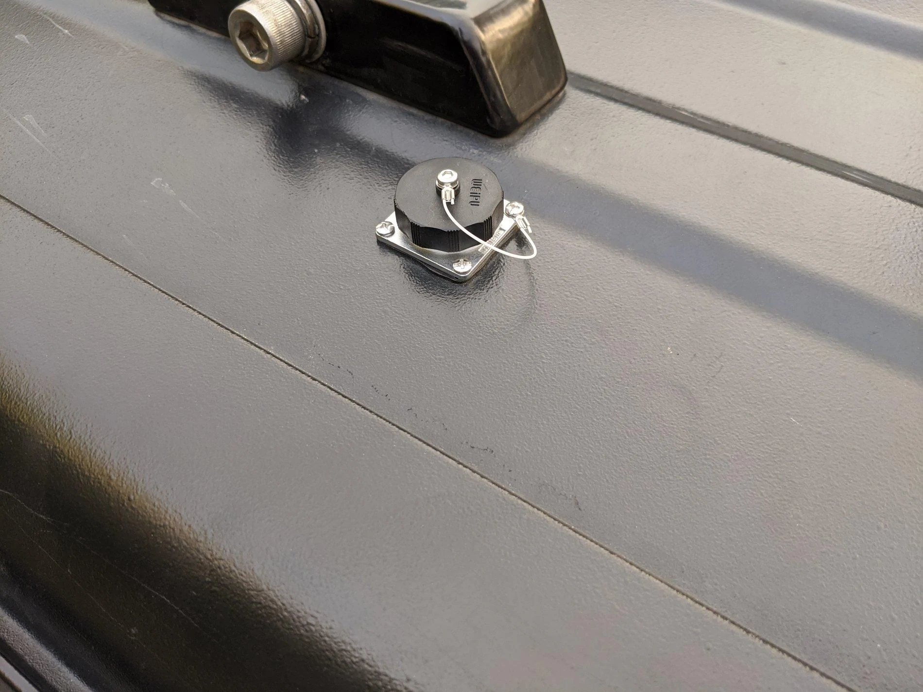

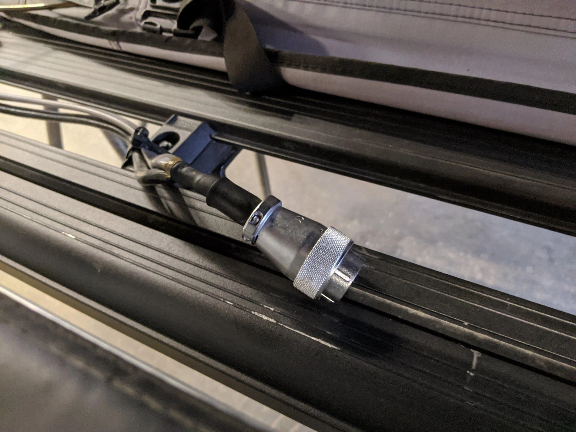

Oh so it would be very similar then. Here's the rack connector. I probably could've routed the cables better but it works for me. You don't see it in the picture but it goes directly to the LED bar and underneath the rack to the tent. The connector is a 7 pin, each pin can handle 25amps. So far I'm using 4 and might use 2 more to route 120v AC off an inverter to the tent so I can charge a laptop up there.

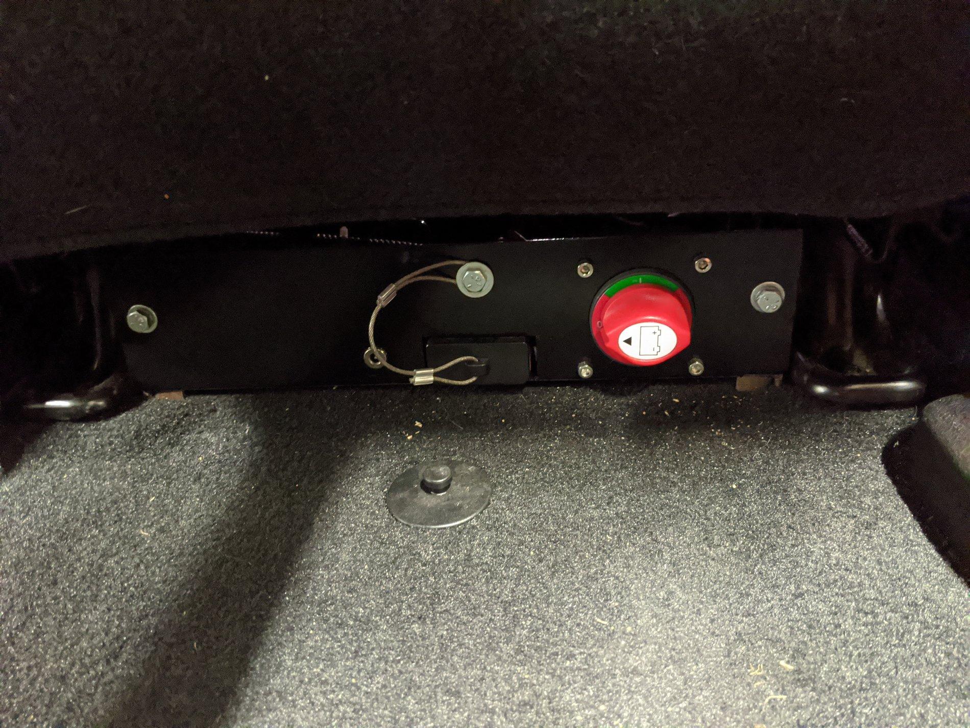

Before you ask, the block with the bolt on the side is my quick roof rack disconnect. I made 4 of those that bolt to the maximus-3 brackets inside and "L" brackets on the rack that bolt to those 4 5/8" SS bolts. Let me know if you need more pictures.

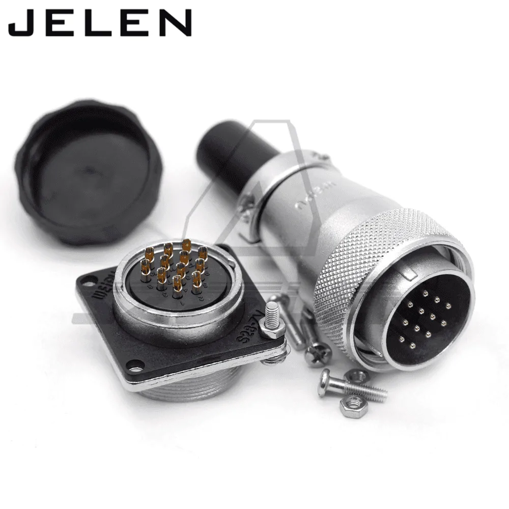

Thanks this is giving me some great ideas. I do have a question about the connection you used. I was going to order it but I'm confused. I see it sold as a set with the through hull connector (socket) and the plug but from some of the pictures I'm seeing it looks as if there is a plug connecting to both sides of the socket. Is this correct? If so what would be the other connector. I tried getting help on the site without luck...
Are you talking about the roof connector on aliexpress?

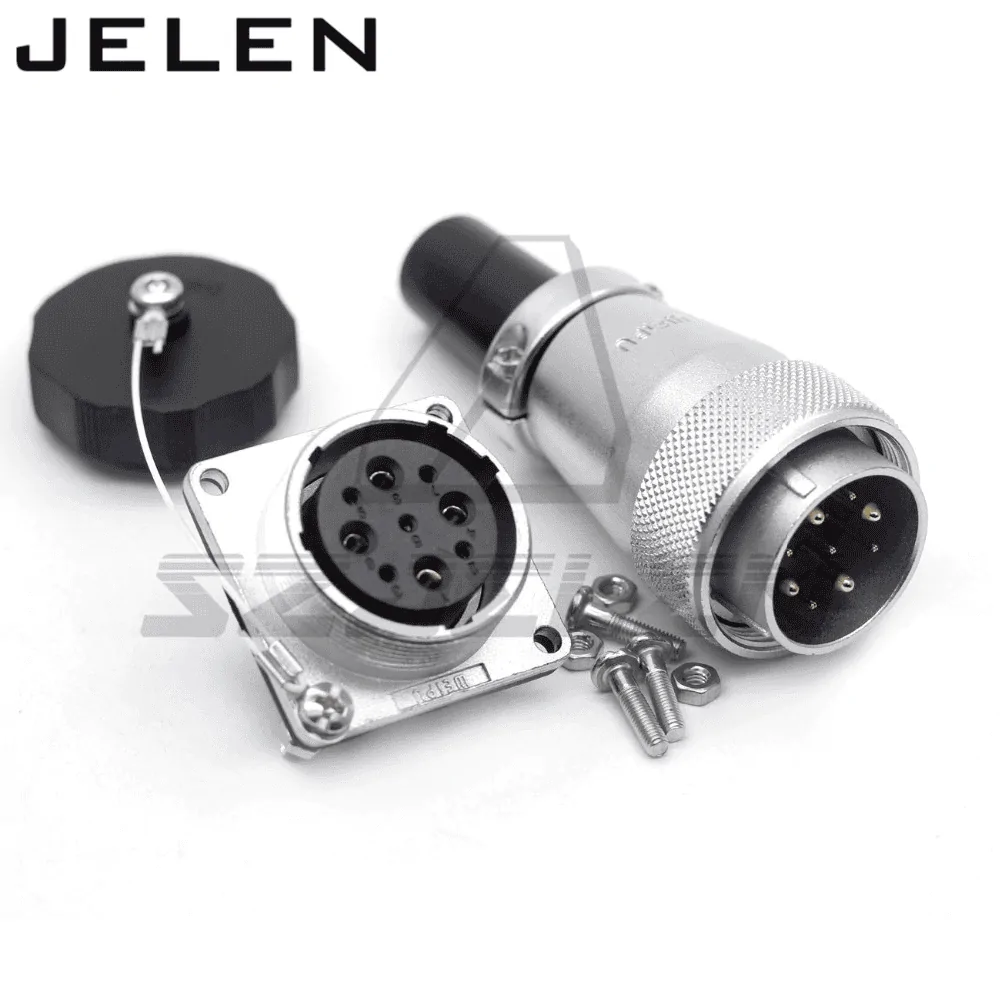

Yes that's the connector I was talking about. From the picture it looks like it could use a plug on both sides. There isn't really a description. I may just be getting myself confused since the inside portion of the roof connector looks like it would also accept pins and there is no boot to cover the connections if these are solder connections. Similar connectors I've seen don't have exposed solder connections.

The part on the left on both pictures show the same part of the connector which gets bolted to the roof. The top picture shows the side facing the roof with the gasket and the terminals that you solder onto your internal wiring. The bottom picture shows the exposed side with the cap that screws on to protect it when not in use.
That makes sense was hoping for a boot on the side where you solder the connections. It seems they do make one but it's not on the AliExpress website. It's only on the Weipu website and I can't seem to find an easy way to order it. I'll just have to make my own boot to cover the connections.

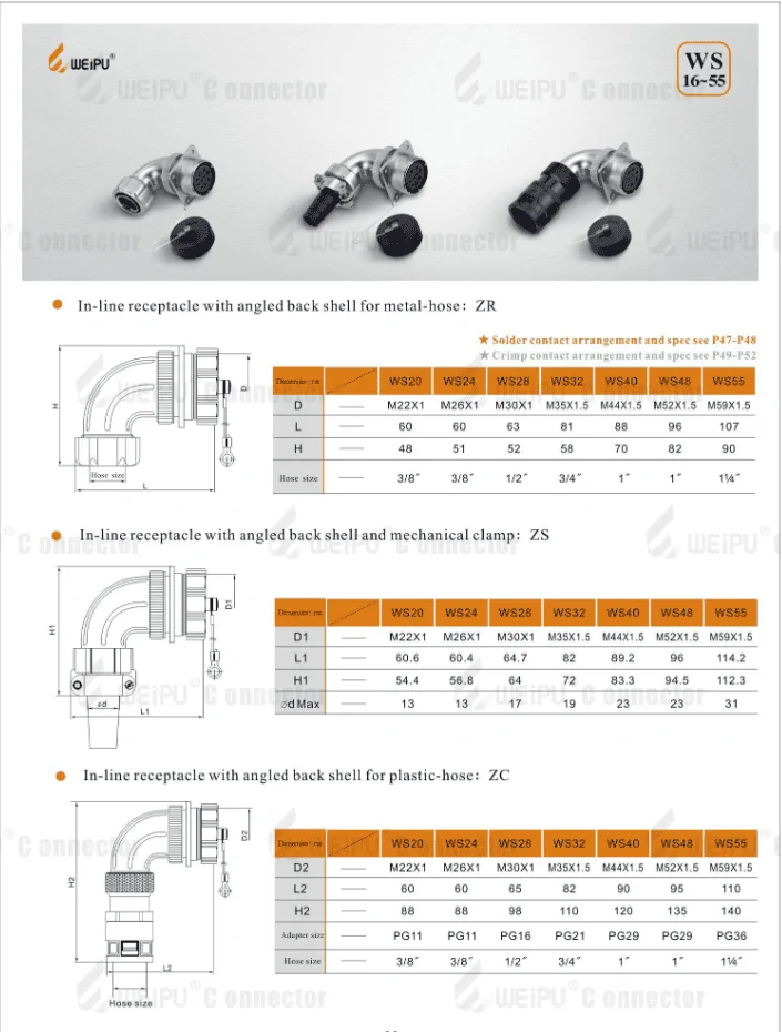

Just for your information this is what I found on the Weipu site.
