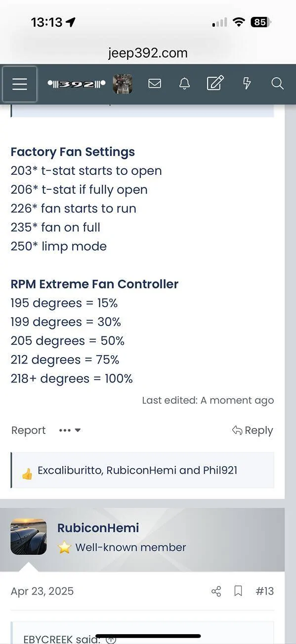

If your Jeep truly hit 258 it would go into limp mode. And you would recognize that if it happened.
Jeep Wrangler JL Overheat Condition 258* IMG_1285
