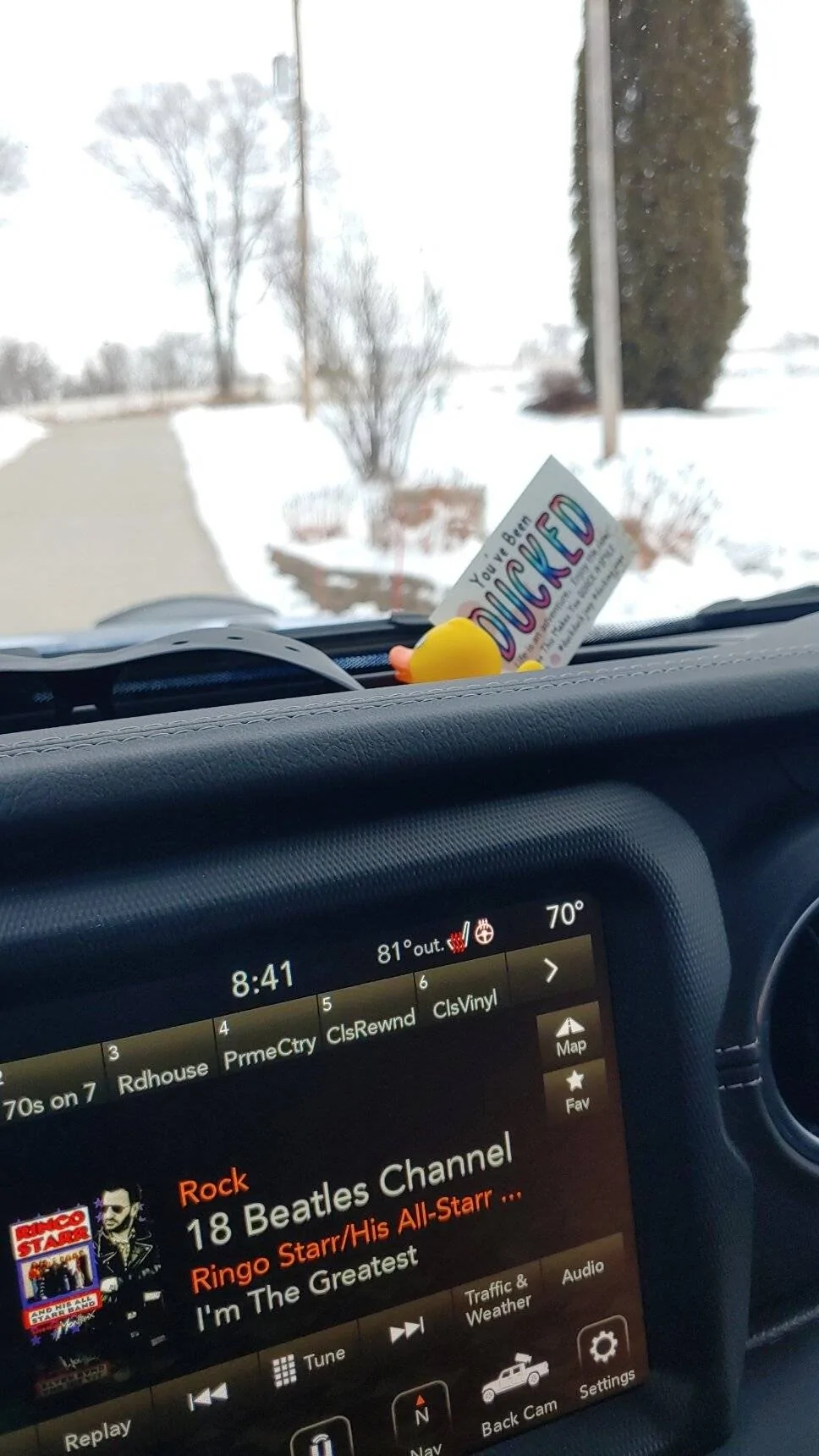

81 degrees out with snow on the ground?

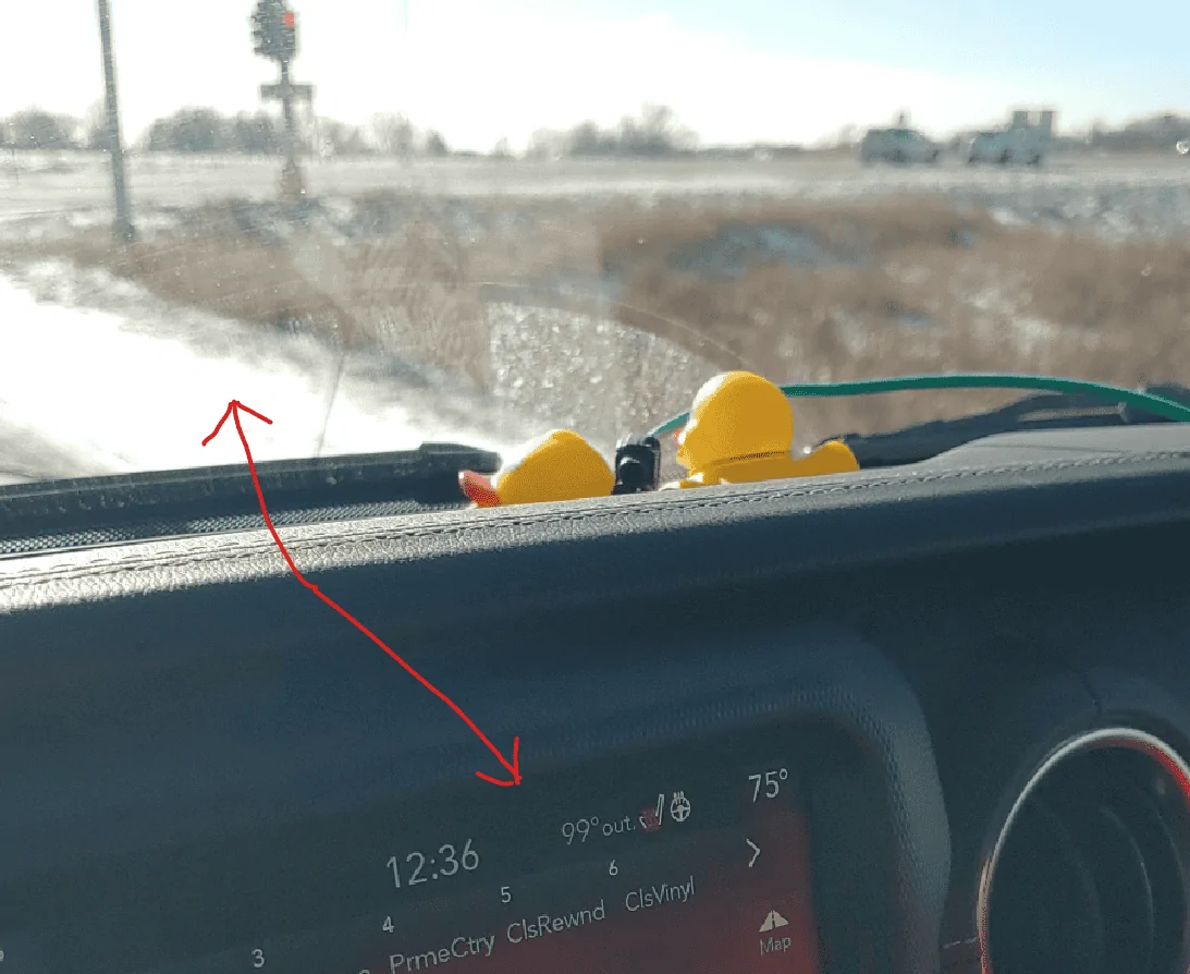

Or maybe you'd believe 99 degrees with snow (and that's down from the 101 it was when I pulled up to the light)
