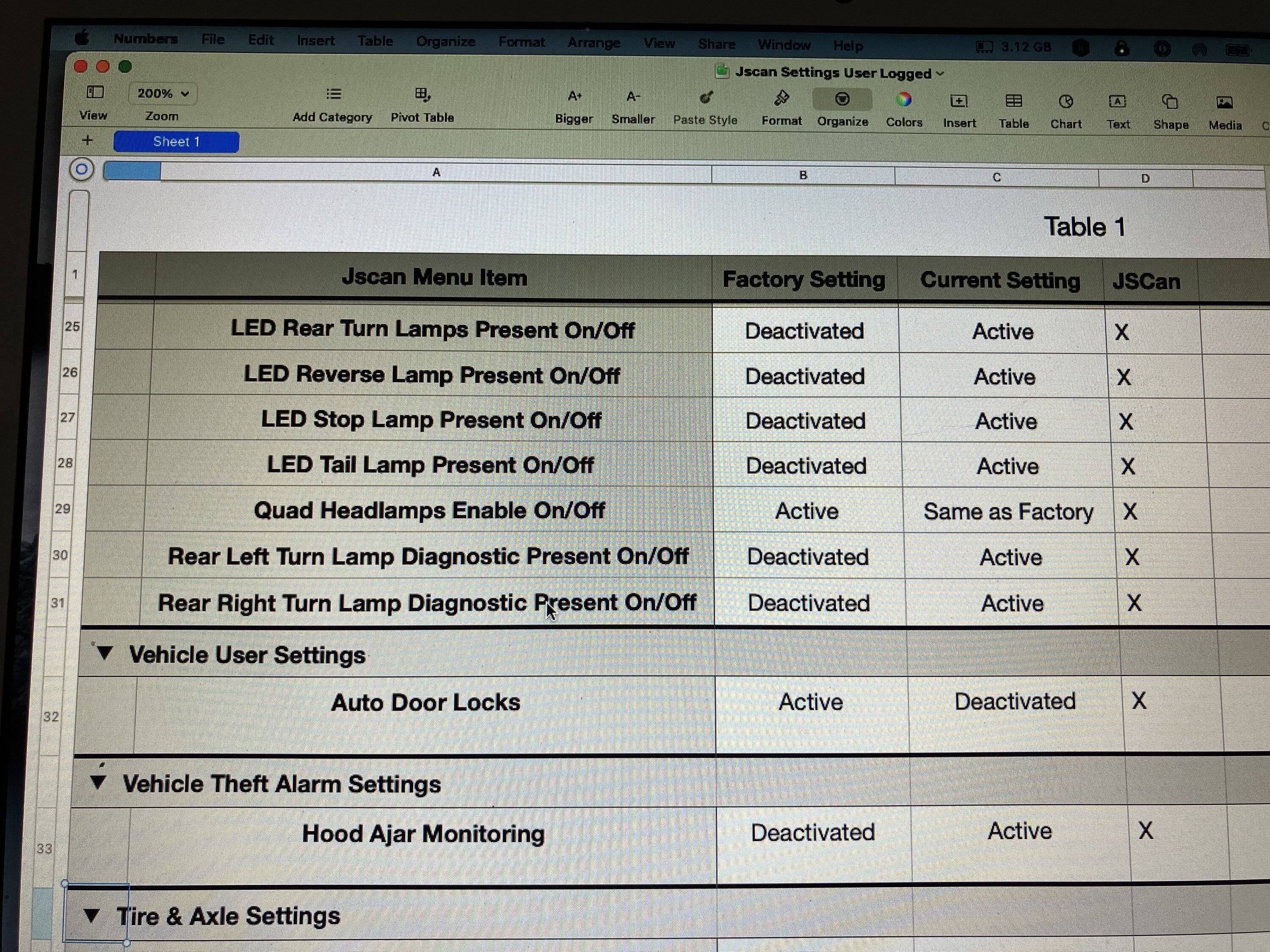

Set the JScan as follows under current setting no and restart all ecus. I’m available for questions

If you ditch the resistors, and don’t change the LCU to LED, you will be sending too much voltage to the light, which will result in a shorter lifespan. But hey, you’ve gotten 4 years out of them already, so that’s damn good.
I edited my post to reflect that I did change settings using Jscan, my bad. Thank you for the catch.

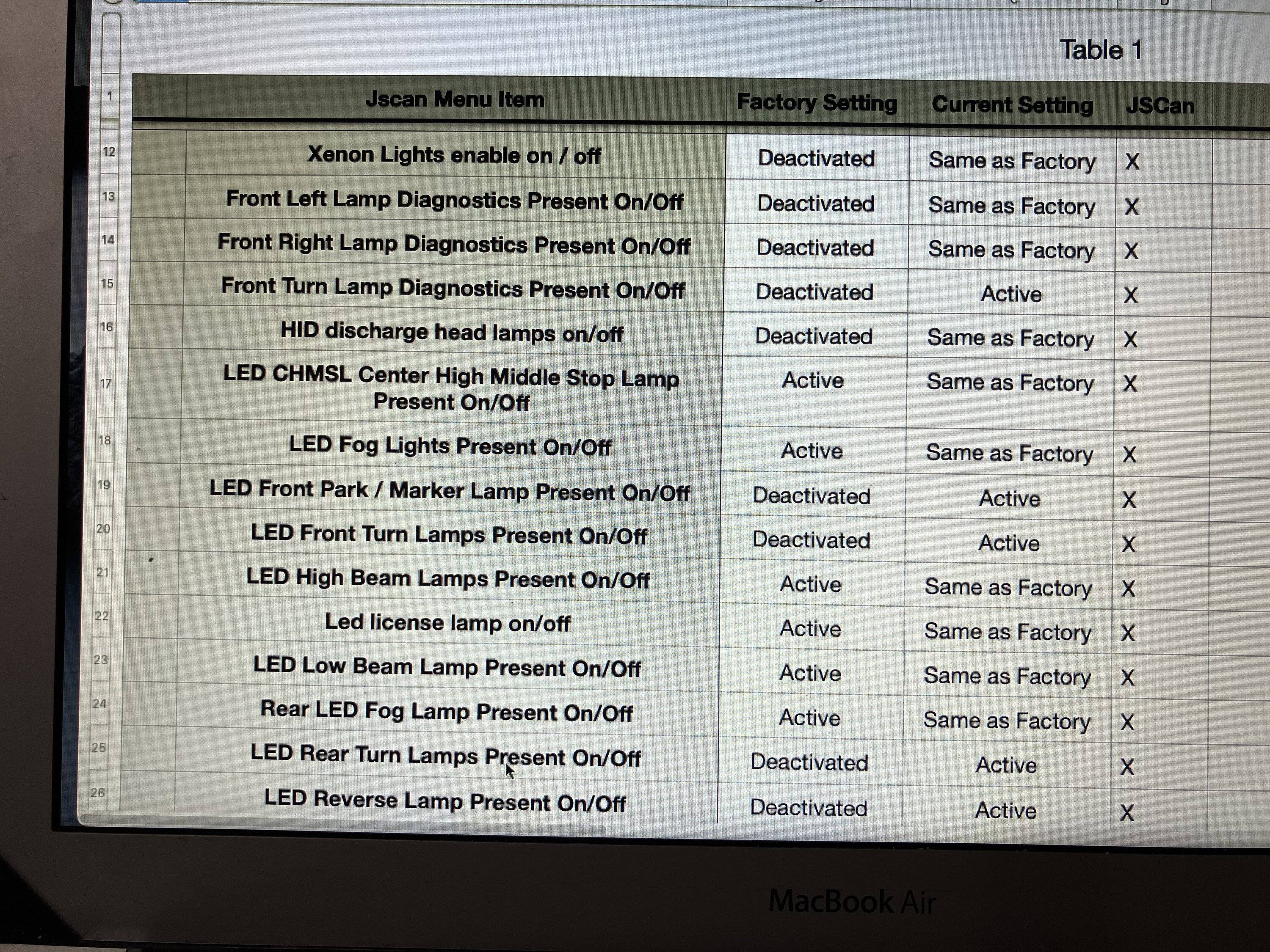

I have for turn signals. I didn’t do the DRL as uI don’t have the premium wire required to make them white. I know how to make them for amber. But anyway here are my settings for a sport with front turn signAl’s. The brand I bought threw a turn signal bulb out even after changing to led, so in my settings the bulb present is deactivated . I get no errors with these settings. The oracle may work with those 2 activated.

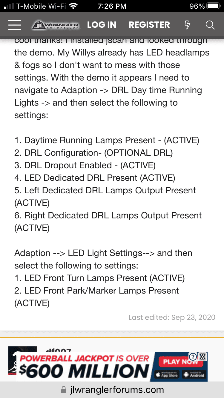

Here are the settings for DRL

If you have a sport when you pick location choose turn signal. It’s been a year since I monkeyed with this, so be patient
Thank you! I have a Rubicon and it didn’t come with BSM or LEDs. I’ve already added the Mopar LED headlights. Got them to work including the halo no problem with JScan. Next, I’m adding the OEM turn signals and the Oracle tail lights. I’ll keep these settings in mind.
