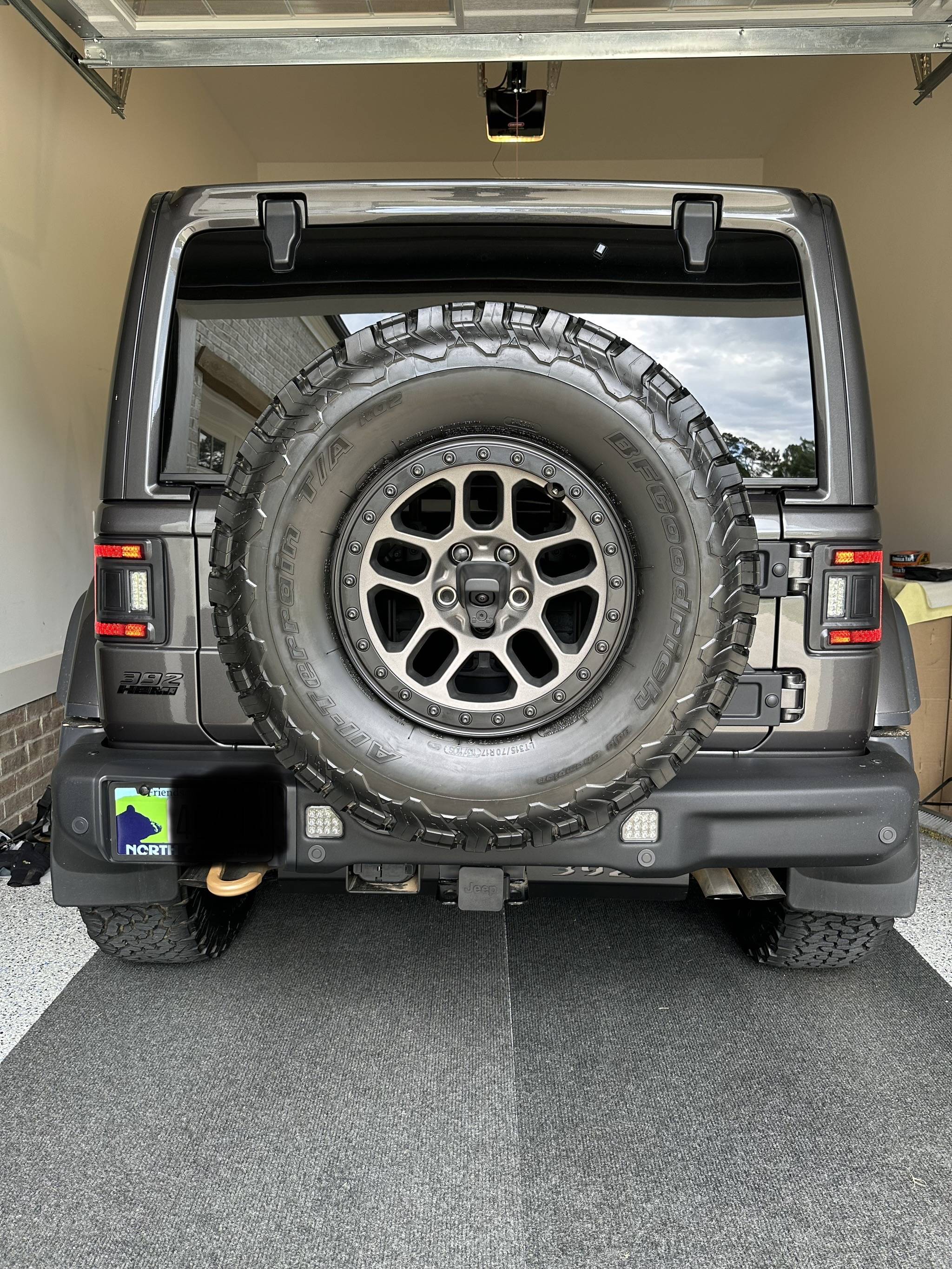

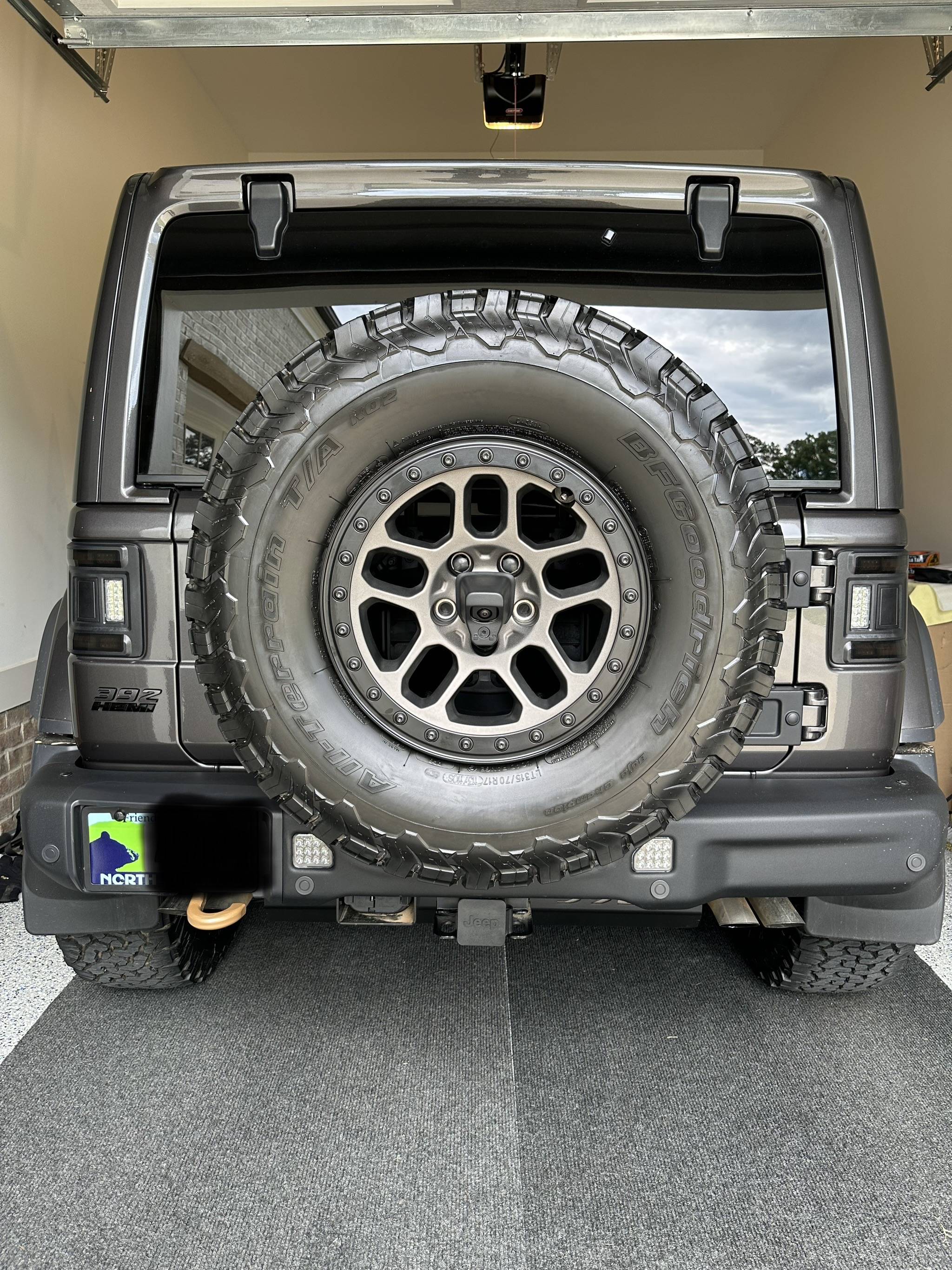

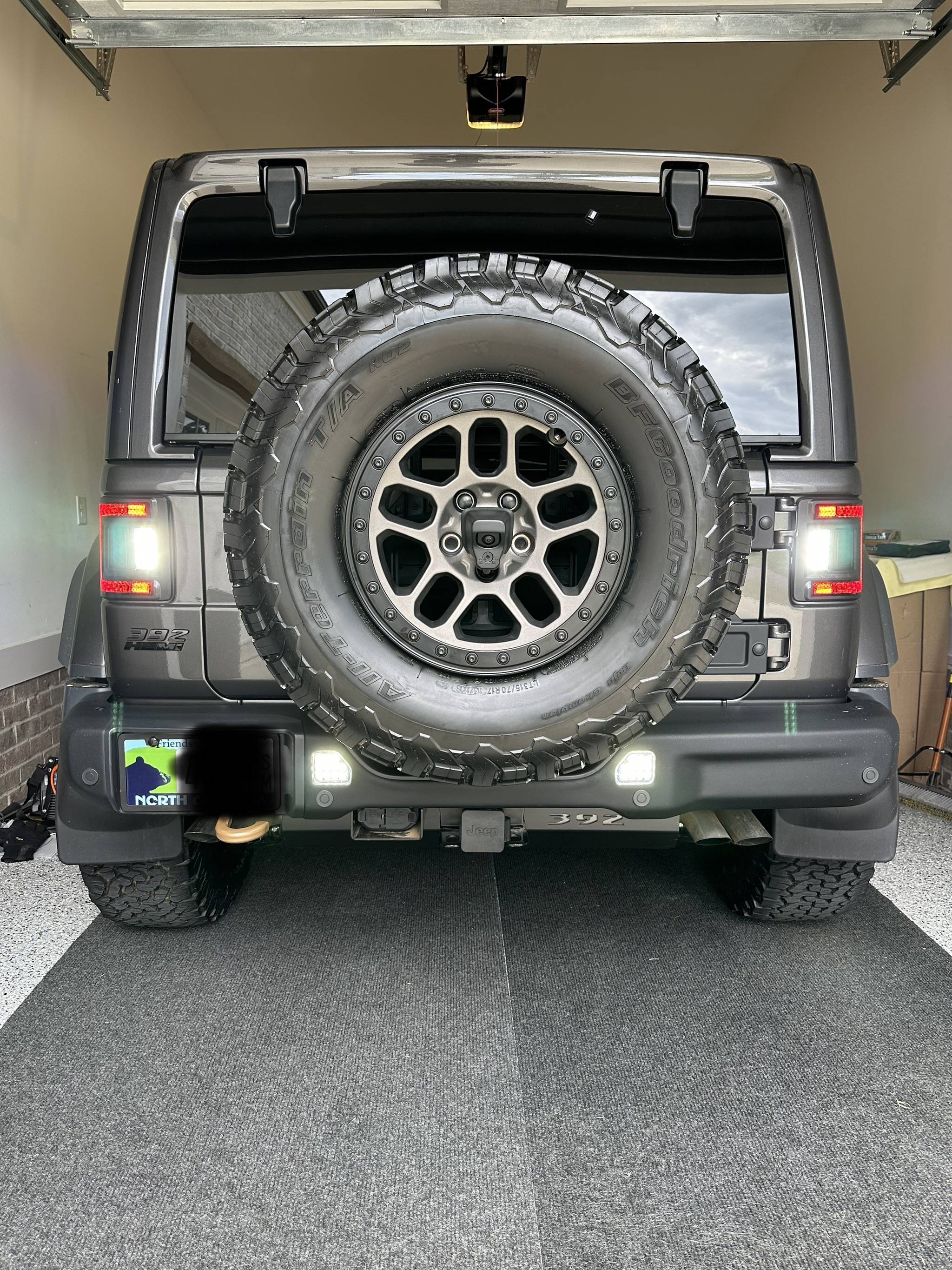

I decided to bite the bullet and install the Flush-Mount Tail Lights. I used some foam tape to adjust the aim on the BSM sensors more downward and outward as much as the housing would allow. Will see how they perform once I have more time with them out in traffic. I’m sure the BSM will be diminished to some degree no matter what and honestly I’m fine with that. . . I love these new lights. Went with the tinted version (with Threedom beveled inserts). I already had the bumper-mounted reverse lights. Those coupled with the reverse lights in these new tail lights are blindingly bright, even in daylight. Here’s some pics. . .
