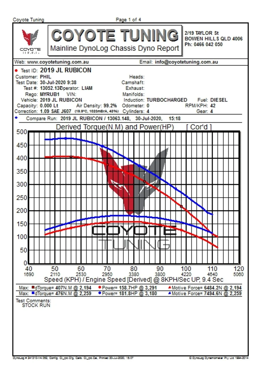

IJust an update on my previos post. I've now had my ECU remapped with a custom tune since 2020 when it had under 10,000km.
It's still running smoothly, it has heaps more torque and tows a big 2.4 tonne caravan with low 14 lph fuel economy and there's no turbo lag.
I love the remap. (Pls note the attached figure are taken from the rear wheel whilst Jeep figures are from the flywheel. )
