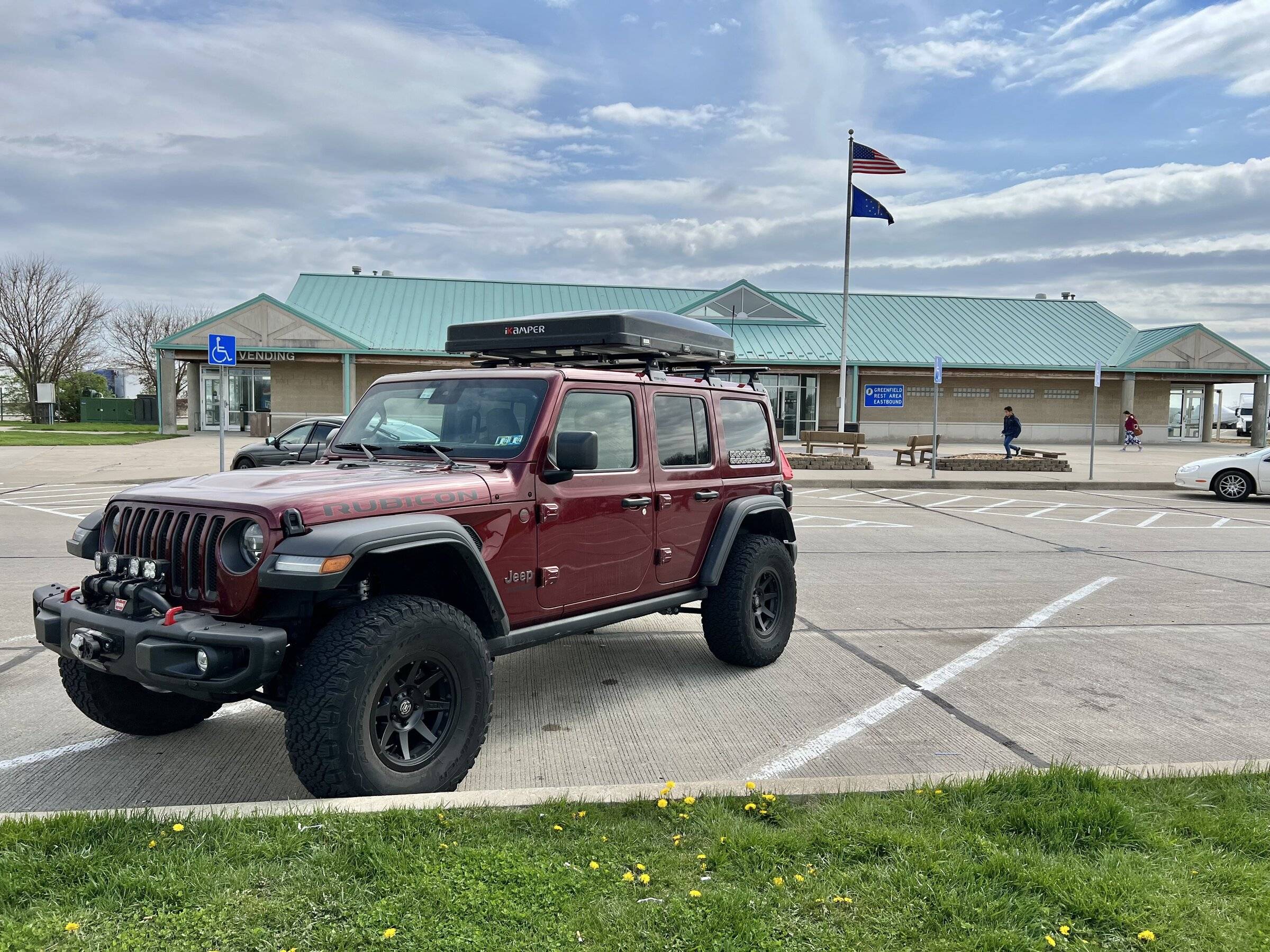

All three of my Jeeps (my two previous and my current) were new and given to me with tires inflated to 40 psi. When I asked about it, the dealers told me it’s a requirement. Strange response, seemed consistent between the FL dealer (first Jeep) and the PA dealer (second and current).
I set mine to 37 for long highway driving. No real reason other than the door jam label recommendation. I’m 1,000 miles from home (returning from EJS) maybe I’ll try the chalk test to see how far off I might be.
Hoping to avoid a “paper trail” of tires being slightly below 37, that might work against me if something happens. With that said Jeep is of course aware that when our tires are at 10-15 we’re off-road. :)
