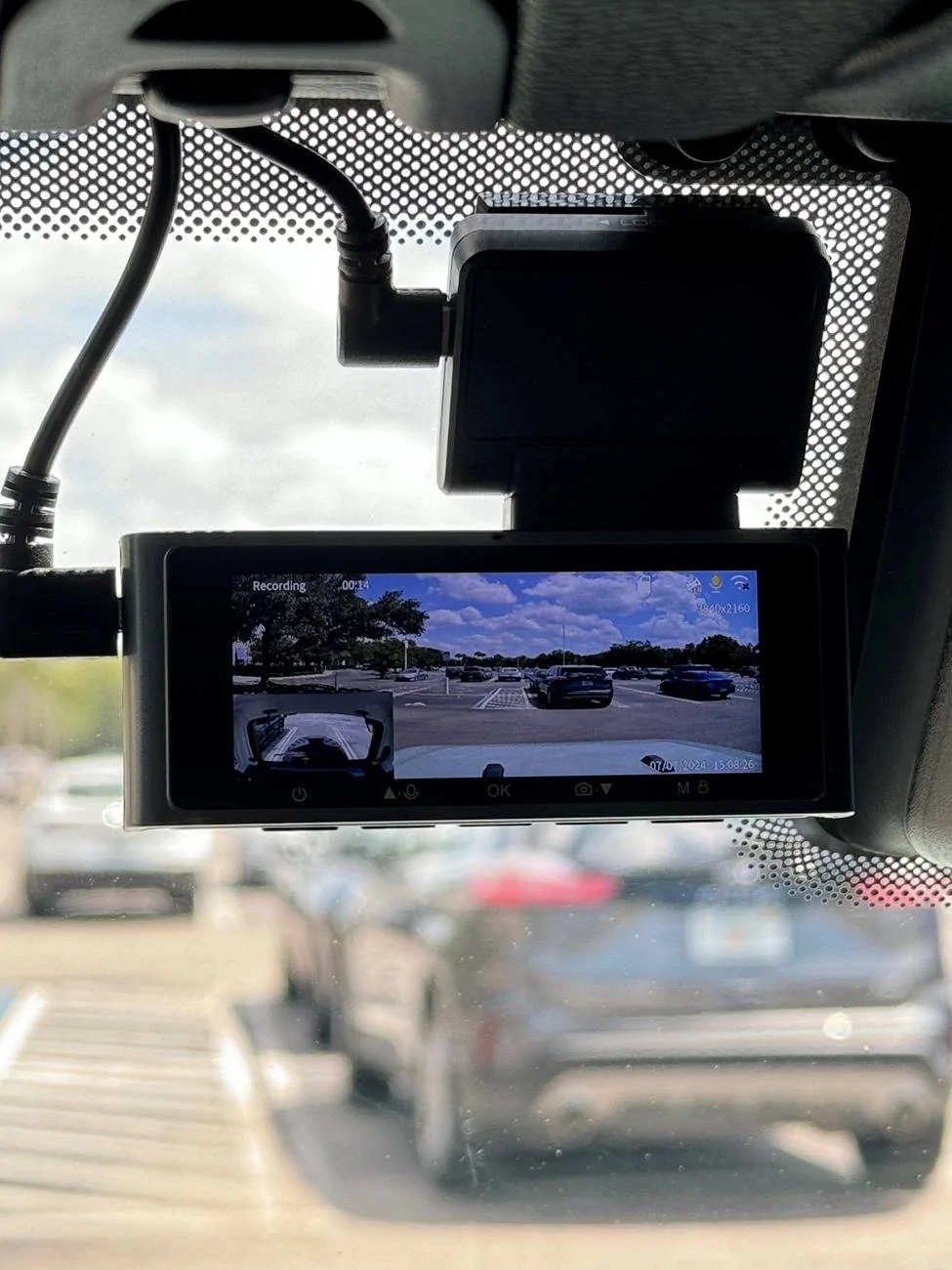

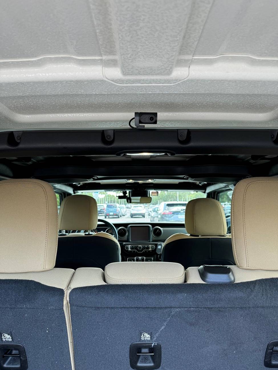

This weekend I installed this dash cam Ombar Amazon. I loosened the black panels on the roll bars to hide the wiring to the rear camera. The rear camera is not in an ideal place but will see a vehicle if it hits me from behind or is too close. I didn't want to run it attached to the hard top to attach it to the rear window because then I would need to disconnect it every time I remove the hard top. For now I am using the cigarette lighter and I hid the wires under the dash with small zip ties. I might hard wire it to the fuse panel in the future as it has a 24 hour surveillance feature. The only issue I had was finding the correct micro SD card as I first ordered a U1 and it needs a U3 speed. I then ordered a SanDisk U3 256GB from Amazon and it could not format the card for some reason. 3rd time was a charm as I found a 128GB PNY at Office Depot that worked perfectly.
I decided to install a dash cam because I am driving a bit more for work and drivers in FL suck, to be blunt.
