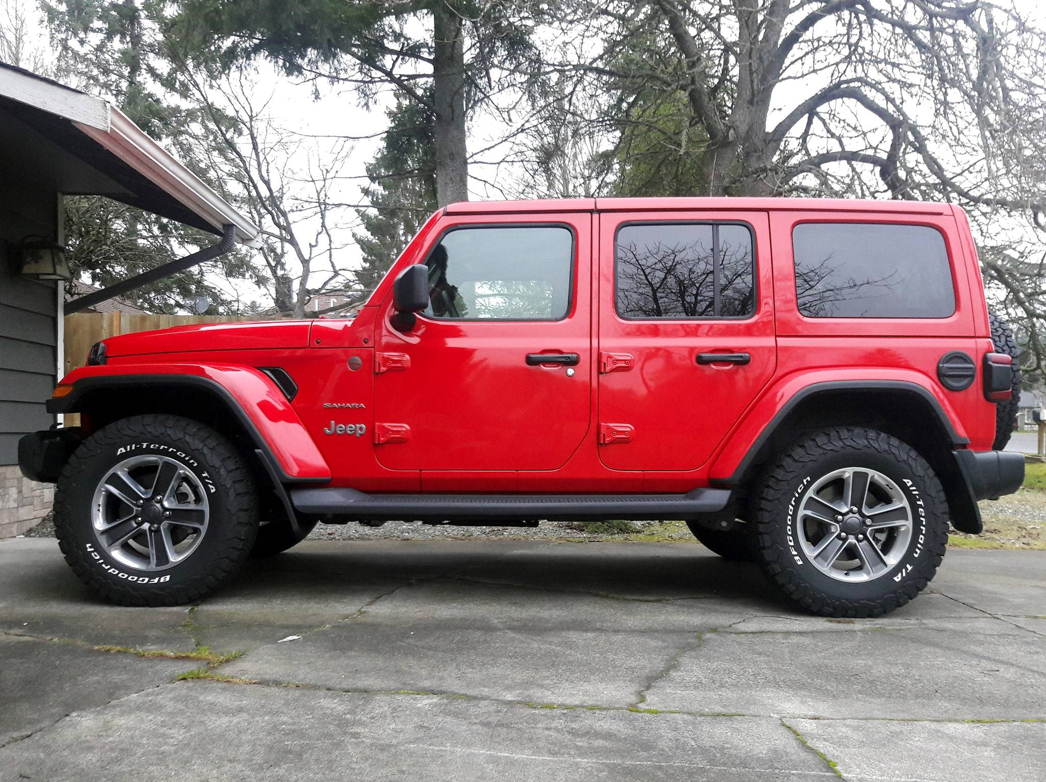

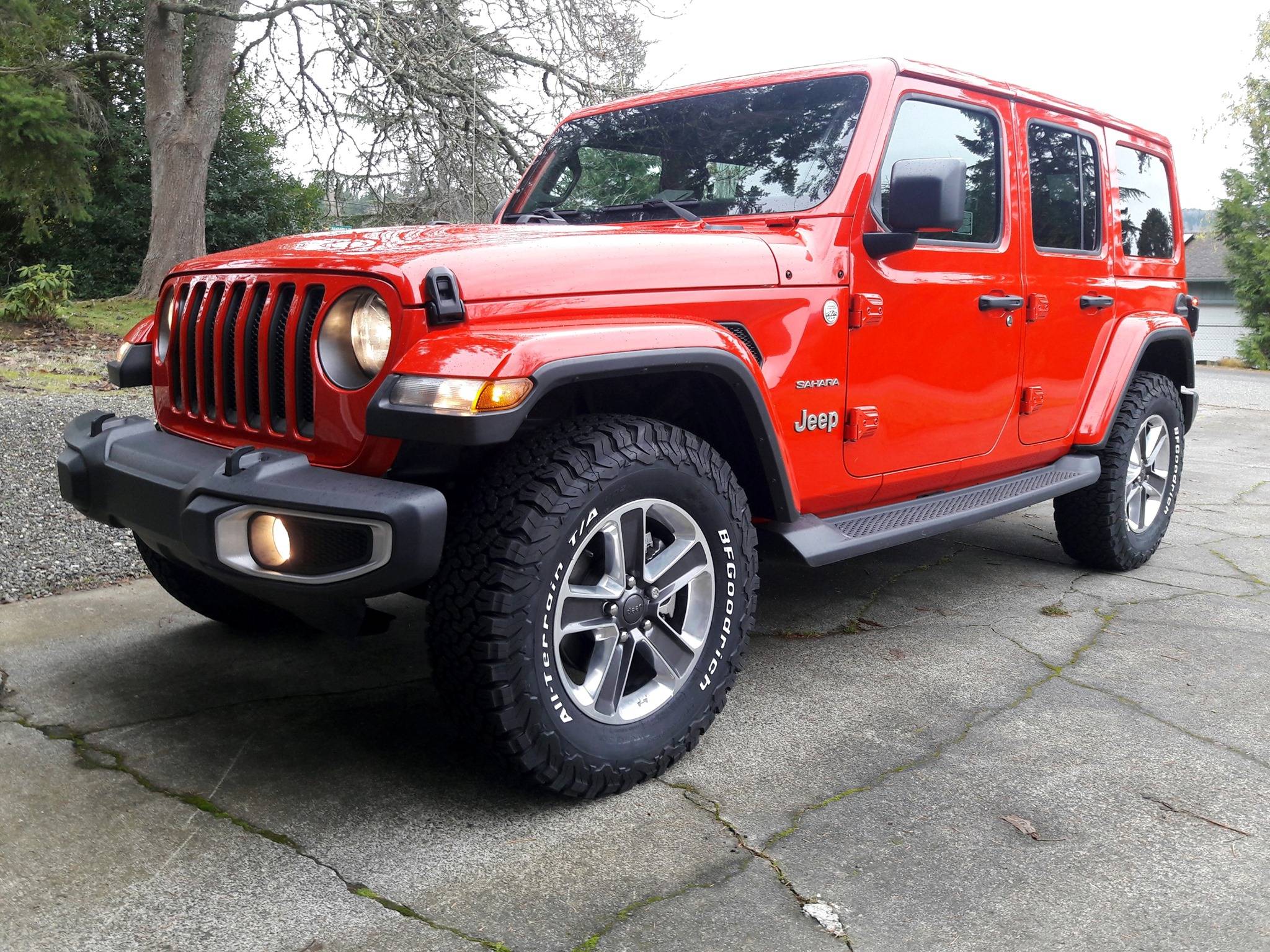

275/70R18 measures 33.2x10.8 inches. I had this size on my Sahara at one point —see below. It’s the ideal size if you don’t plant to regear. But you might want to add a 3/4-inch spacer lift to make sure you don’t rub at full flex.
