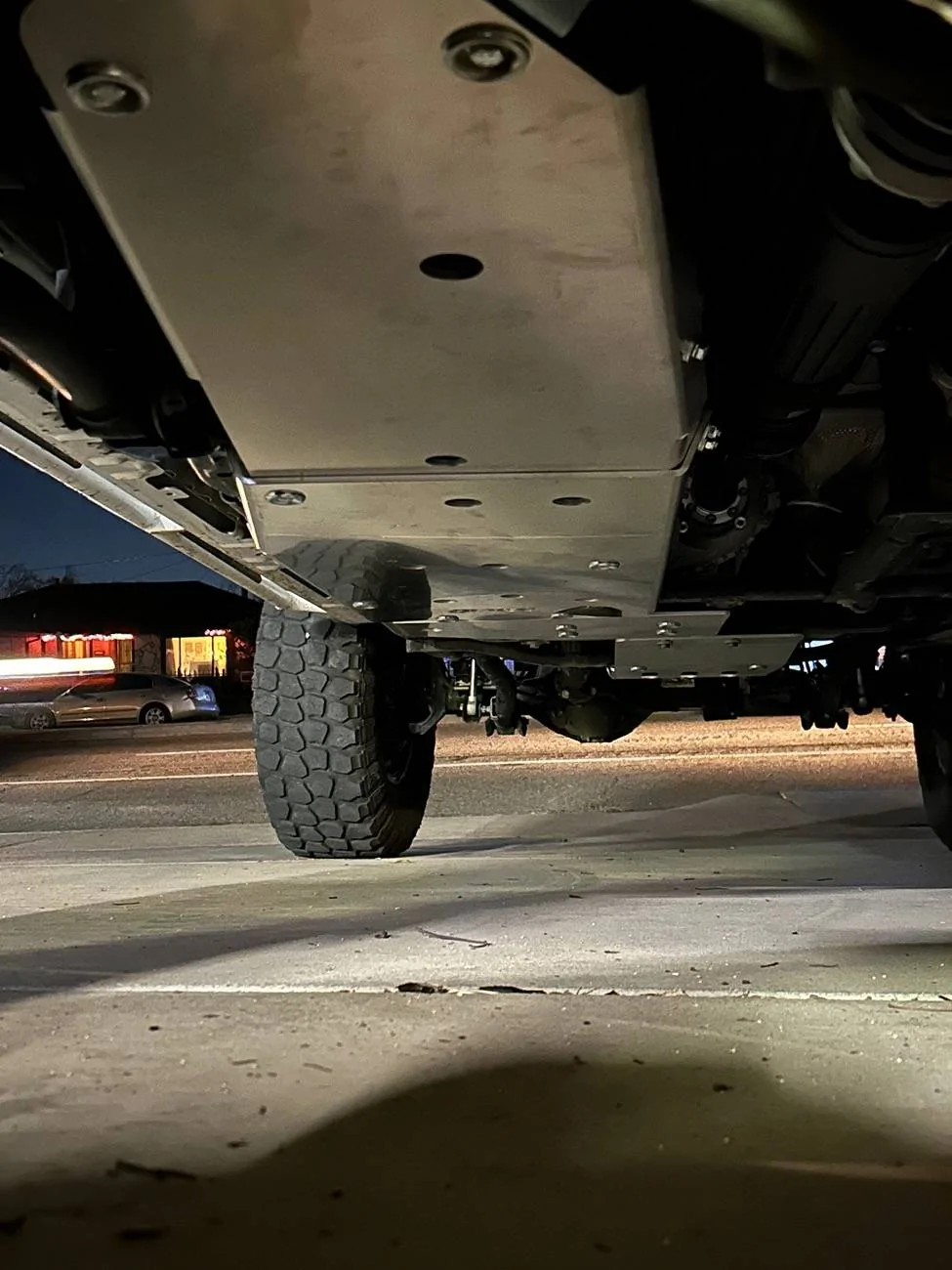

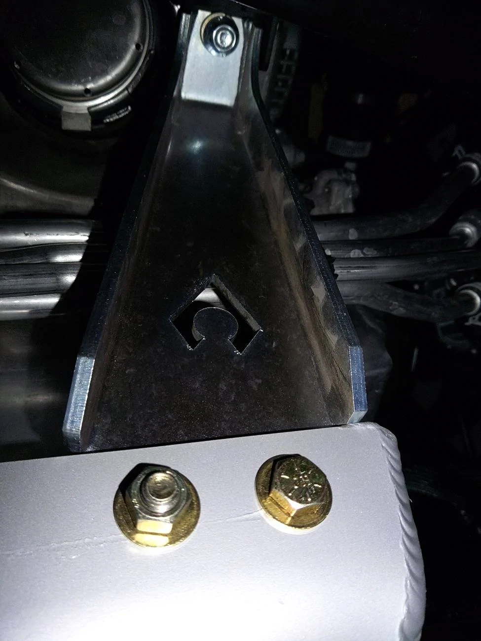

I have a 2 door 2.0L. I wanted the Quadratec aluminum skids from mother Russia I had on my JK, but not an option. On my JLURD I went cheap and bough steel skid plates from M.O.R.E. Worst decision ever. Not only fit issues but heavy as hell. On this one I went with an Artec engine/trans skid and a M.O.R.E. transfer case skid. Works well together. Bough Rock Hard 4x4 slide washers to augment. I did fix what Artec missed regarding the cut out for the filter. I grew tired of a huge mess each oil change. I make the slot larger and just in far enough for the gravity drip to clear the skid into a pan. I painted the hatch red and the skids with silver aluminum paint. I run a Fumoto and it clears it easy. I also ditched the hex bolts Artec sends for G8 bolts on the engine mount brackets, putting one in backwards so it acts as a stud to hold the plate up while getting bolts. Works good.

Got the Quadratec ones. Whatever you get, paint any steel brackets before install. The powder coat failed within a year.

I saw someone post they didn’t like the MORE steel plates. The aluminum ones look and fit great, no issues, and not too heavy.
