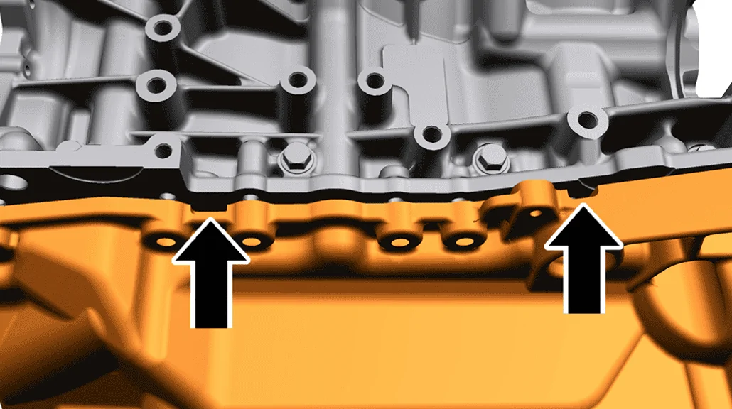

If yours is a 3.6L (no idea if the other engines are the same way) then you need to remove these
bolts before removing the upper pan (these bolts are hidden behing two rubber grommets)

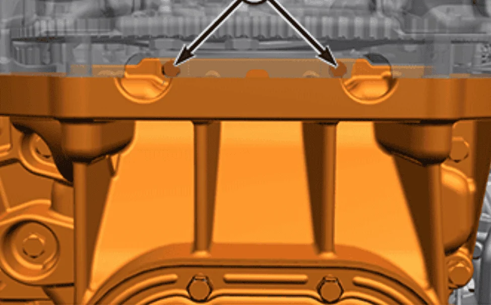

the upper oil pan has two pry points on the driver side to dislodge the pan from the engine block.. here:

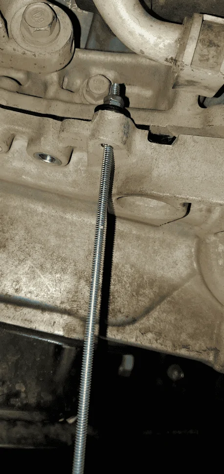

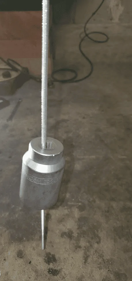

I found a hole in the upper pan that was not in use (I imagine is for another type of engine or perhaps as support for components my Sport does not have)... so I decided to whack the upper pan downwards this way (threaded rod, nuts, washers and the biggest socket I had around) this method is similar to those tools used to remove bearings
Jeep Wrangler JL Oil pan replacement, 2.0 1677640592860
Jeep Wrangler JL Oil pan replacement, 2.0 1677640615518
After whacking it quite a few times (use gloves)... the upper pan finally separated enough to be able to carefully remove it by hand.. The threaded rod's thread will most likely get damaged from the whacking... I used a Wise grip tool to hold the threaded rod and forcibly undo the nuts.. another option would be to cut the threaded rod below the pan while being careful not to introduce metal shavings in the engine
