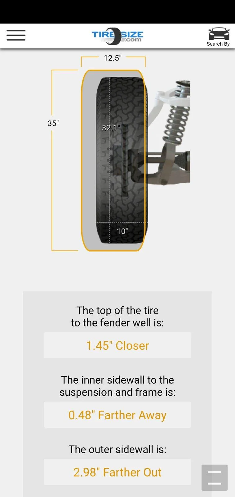

I like tiresize.com
Not sure of your original size, but I plugged in your new wheel and tire size with 0 offset.

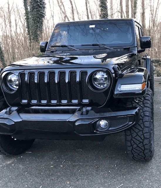

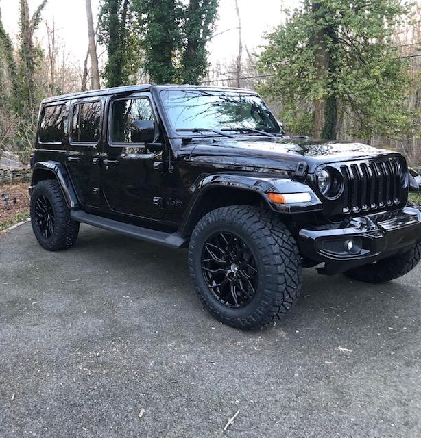

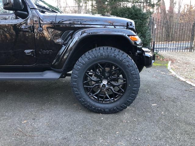

Hey guys.. Finally installed my wheel set.. Went with a 35 by 11.5 and a +3 offset on 20's with no lift..
Jeep Wrangler JL Offset Help 62932676333__B3815CD3-C15D-4631-B05C-22C44BCC2815
Jeep Wrangler JL Offset Help 62932674001__EEBA0F1F-42B5-4027-A629-7E2589F8E702
Jeep Wrangler JL Offset Help IMG_4256
Jeep Wrangler JL Offset Help IMG_4255
Jeep Wrangler JL Offset Help IMG_4254
Jeep Wrangler JL Offset Help IMG_4253

Nice fit @ the fenders, looking good!
