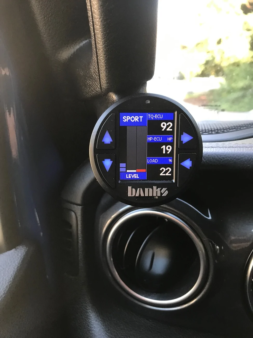

Tazer doesn’t plug into the OBD2, but yes you can get a splitter, it is needed for the Diesel when also running a Derringer tuner. Spring for the I-dash and change levels at will with a button push instead of fumbling with a phone but costs about as much as the PM.

Tazer doesn’t control throttle response or shift points. If you get a controller get the Banks that plugs into the OBD and doesn’t scab power from the throttle, or enhance reverse. He has a comparison video available, yes promoting his product but true nevertheless.
Looking into
Jeep Wrangler JL OffRoad + option.. Is it worth it? {filename}
Dont know how I missed that the Tazer doesnt use the ODB2, well thats good then.
Looking at the banks a bit more, it looks like it can only INCREASE the throttle response?
Looks like there are no options to make it LESS touchy and responsive for offroading?

Dunno, never tried decreasing. My goal was to eliminate the squishy torque managed off idle throttle response and get closer to a mechanical linkage feel. It’s typically set a little higher, but goal achieved.
