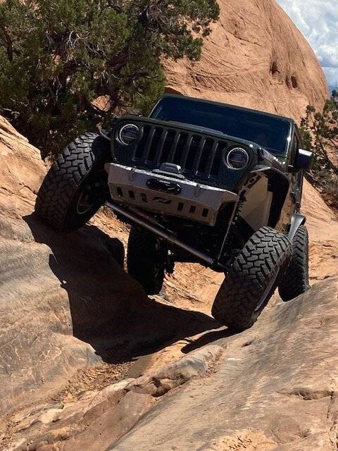

I'm running -38mm offset and I love it. I also built this to rock crawl so I like having a lot of meat out there. I also run KBD fenders fenders so I have a lot of tire exposed but that means a lot of sling up onto the body. Sorry I don't have a better pic to show what it looks like.
