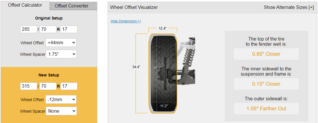

@MonopoliJLUR + @blnewt + @GATORB8 + @Chocolate Thunder - just need your confirmation. Based upon this calculator, I think that a 0 or -6 offset would have me as close as possible to my current set up.
What say you?
What say you?
0 Offset:
-6 Offset:
-12 Offset:
-18 Offset:
I think whoever said something about using the same tires is right and that the extra wheel width won’t affect it too much since the tire is out further anyway, so I think 0 offset will be almost the same as you have now and any more negative offset from there will just add that much more poke
I’d go 0 offset (that’s what I’m going to be doing on my Jeep when it comes)
Chocolate Thunder
Jeremy
Feb 20, 2018
221
5,353
10,512
If you’re trying to keep suspension clearance and minimize poke, I think I’d choose the -6. Are all of those offset options available on the wheels you want?
