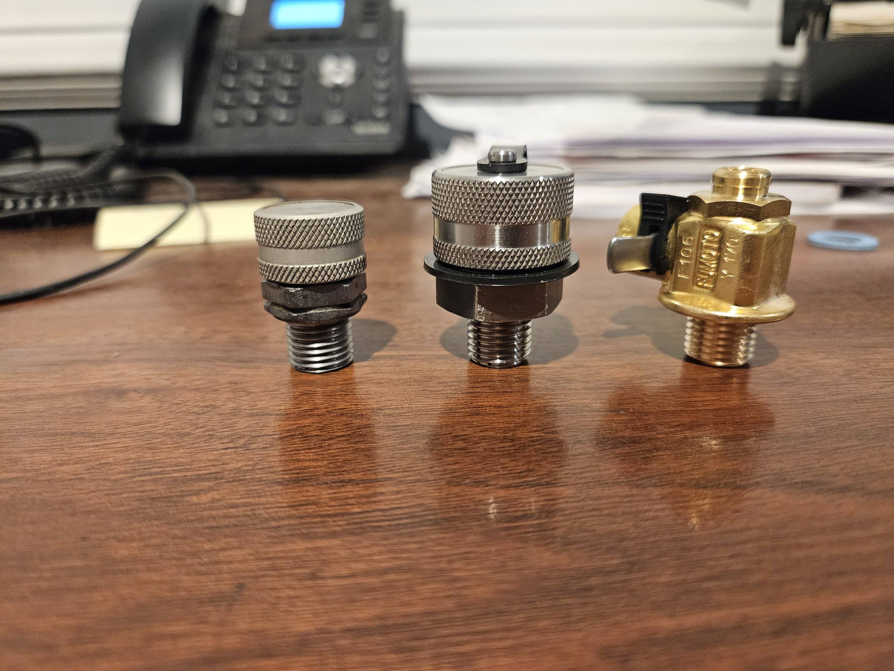

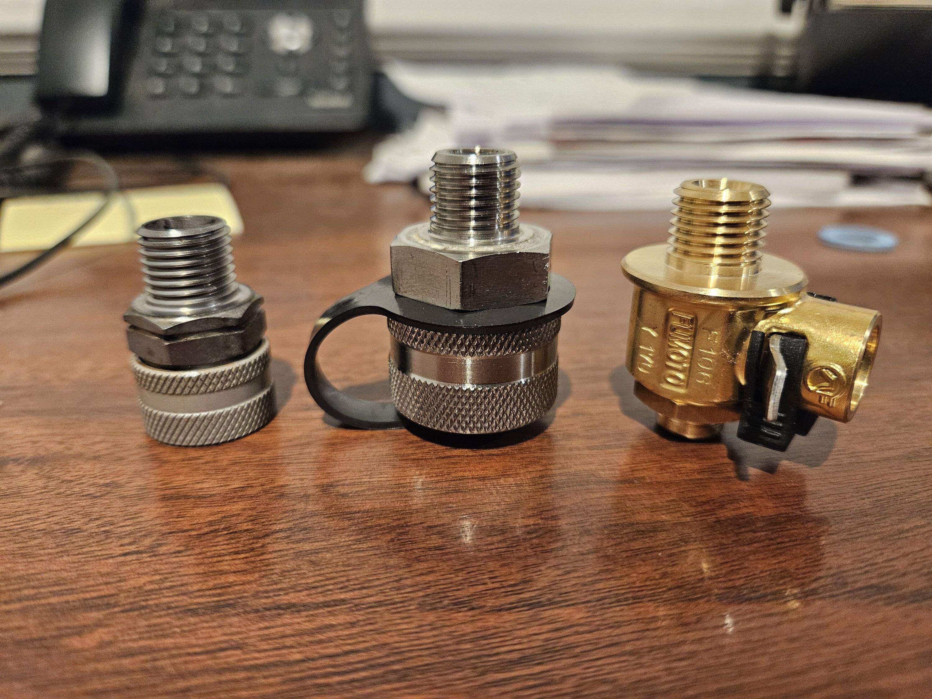

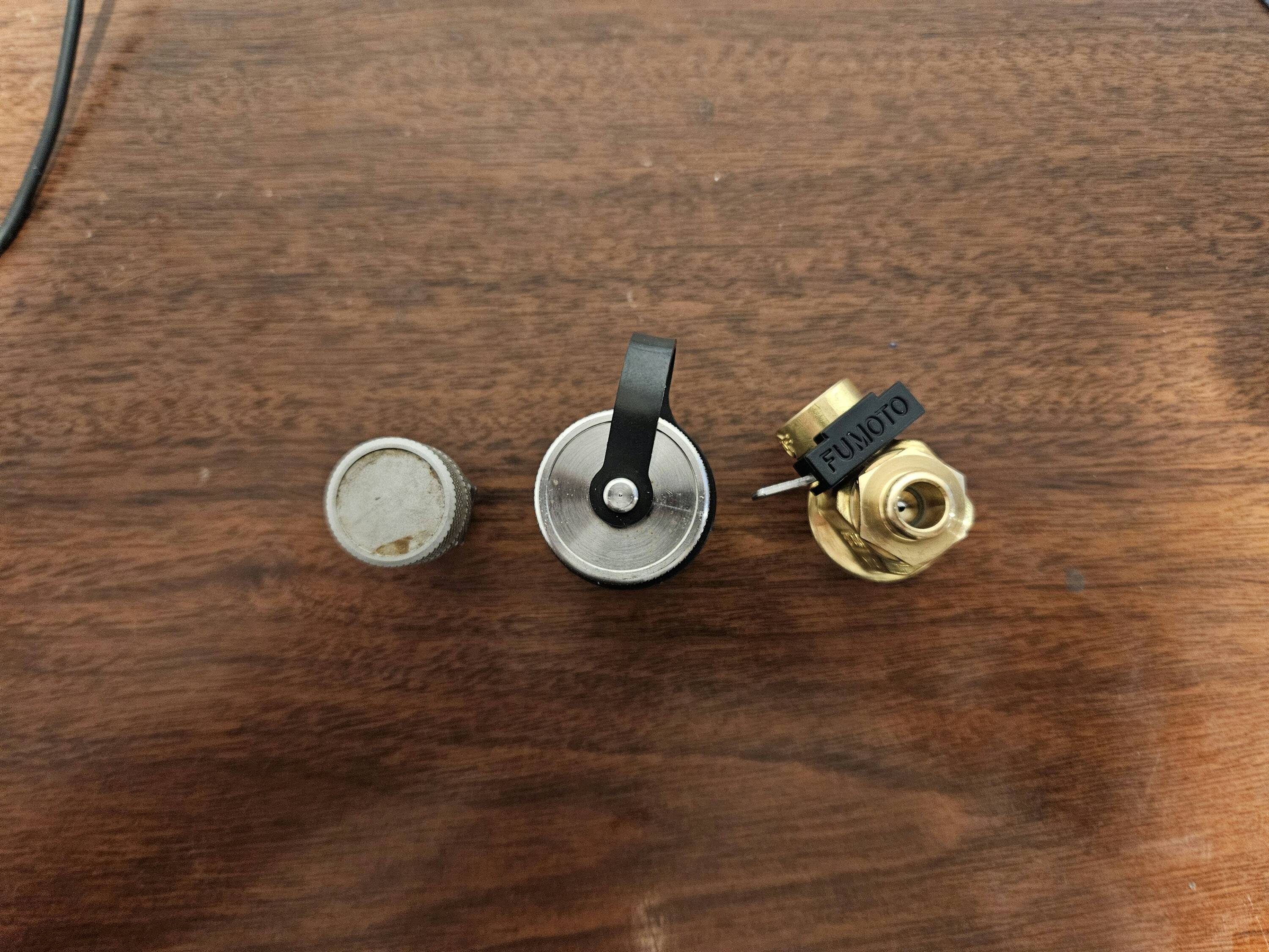

personally after noodling with the three of them i'm gunna have to say the Fumoto is the cleanest choice, pop a hose on the end (or not), flick the lever and drain it into an old 5 quart container. i've read people praising the small size of the Valvomax, i'm not seeing that, it's actually considerable larger that the Stahlbus for really no particular reason. it doesn't matter how beefy the valve is, if you hit it, it's breaking at the threads - stainless or brass. i like the clean open port of the Fumoto for an open drain, as opposed to the other two that flow through a spring and around a ball. i like the capped off look of the Valvomax and Stahlbus and agree that it's nice to keep the valve from getting covered with road debris and drips if the ball ends up leaking.
i originally assumed that the threads in the pan held back full drain when i used the Stahlbus, but i used redline oil for that change and may have burned a little and my collection method wasn't exactly scientific.
as an overthinker... as irking as the lever, open valve and "size" are, i vote for the Fumoto and will be installing it on my next change.

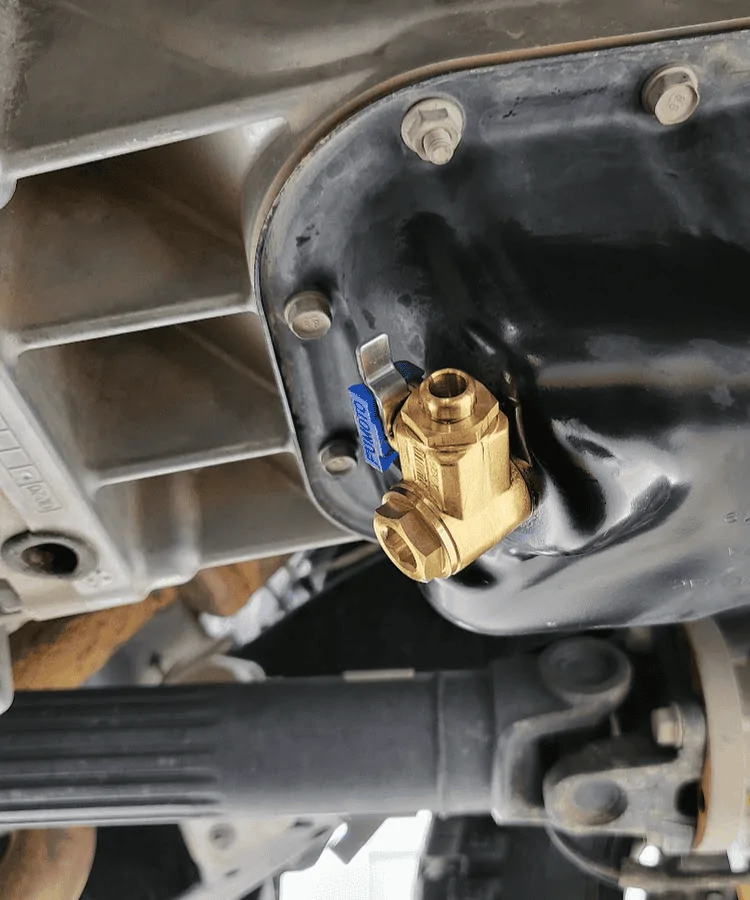

Fumoto installed today. I'm looking forward to the next oil dump in 5,000 miles

I just installed this one yesterday while doing my oil change. Looks different than the one above as it sits a little higher? Maybe that's a good thing. Also got the hose kit for draining. Have one on another of my cars and makes oil changes a breeze and not to mention less mess.
Jeep Wrangler JL OEM Drain Plug Part Number 1708967357055
