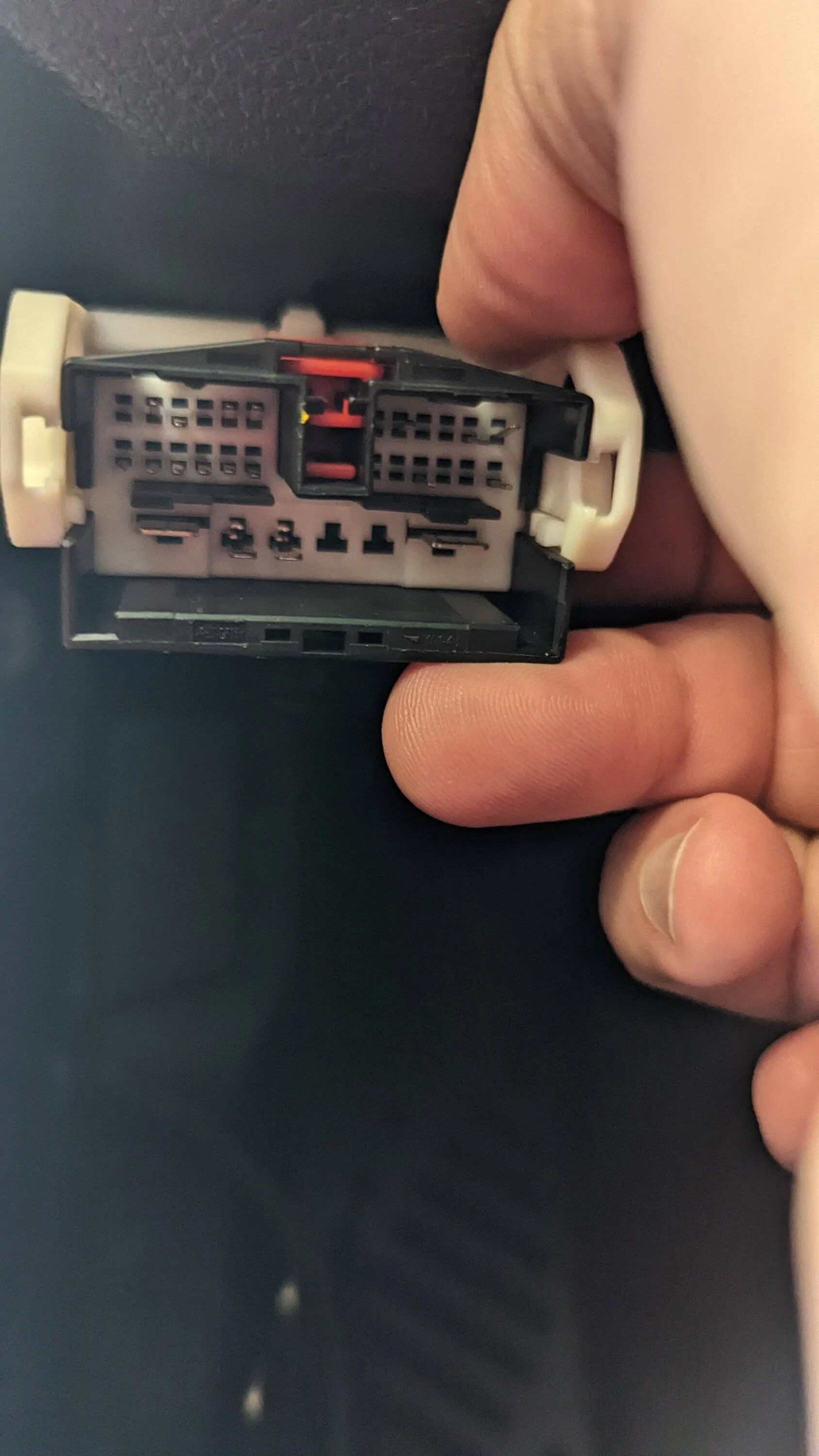

Problem solved. Here's a pic of the bent pins. Crazy that they don't break off. I had 5 of em.
Be super careful when plugging your door back in.
I see one bent pin top right. I'm having a problem with my drivers side rear passenger door.

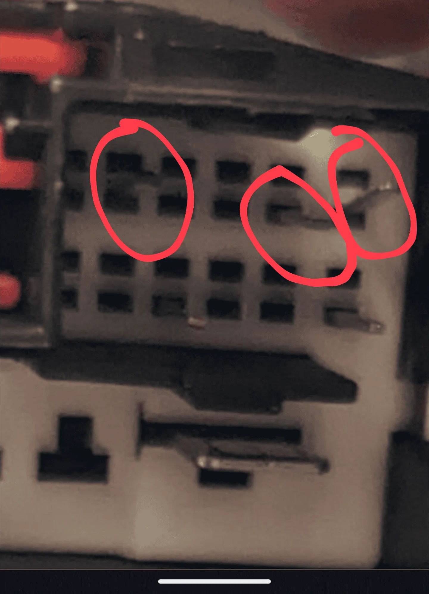

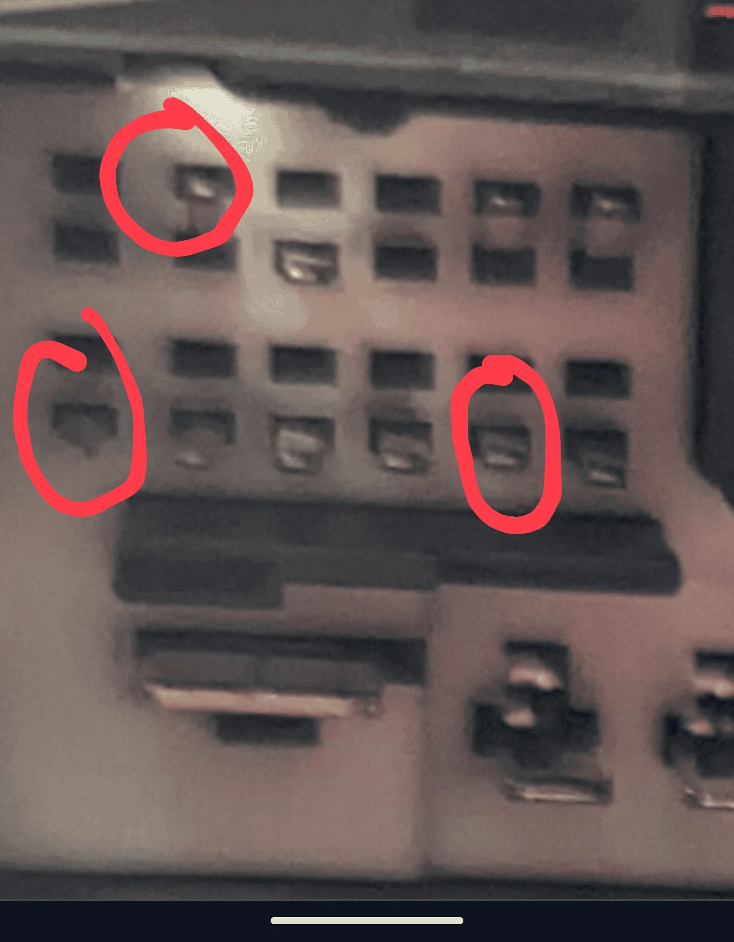

It's been quite a while since I saw this post, but zooming in I see 5 or 6 that are bent.
Even being off the slightest bit they won't seat properly. It's amazing how shoddy the design of this is.
