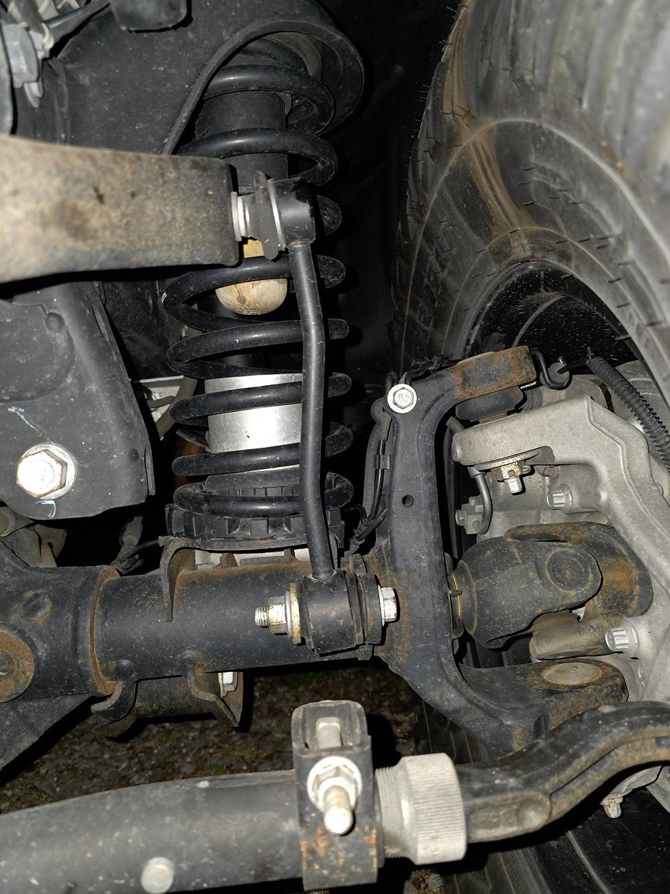

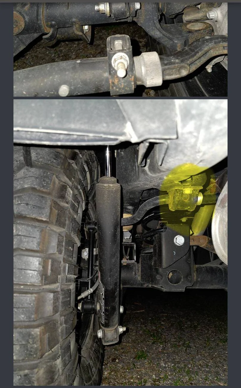

This may sound like a ridiculous question..so bare with me.
Im going to order new rear sway bar end links, but Im a bit confused. The OE style (both greasable and un-greasable) im finding online are not straight up and down, but the links on the Jeep now are straight up and down.
Now, it has Terraflex shocks on it, and the Terraflex links are straight up and down, but it is my understanding they are for lifted suspensions. I have not found evidence of a lift having been installed. (Though, Im running 35x12.5s and only rub at full lock). So, should I just order the TerraFlex links, or just get OE style? Now..the front door have the curve, but that's a separate concern at the moment.

Might be too late but after looking over your pics, I can say you are definitely lifted. Your rear sway bar links are not factory and it appears the original rear sway links have been moved to the front. Plus the aftermarket bump stop extensions are an easy tell.
brotherGood
brotherGood
Apr 21, 2025
61
OH
2021 Jeep Wrangler Willys
Not too late, but I have wondered that since we got it (whether it was lifted or not). The links being flipped is something I've found over the last day or two in digging, but I thought it was odd doing that without concrete evidence of a lift.
I know it went to a semi-local shop (according to the Carfax we got when we bought it) and had thought about calling just to see what was done. But I wasn't sure if, since I wasn't the owner at the time of services performed, Id be able to obtain that information.
