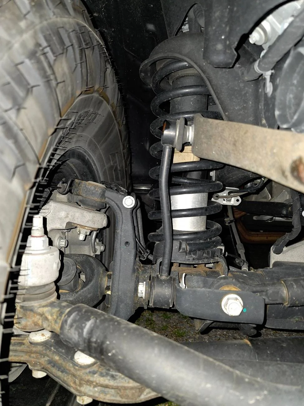

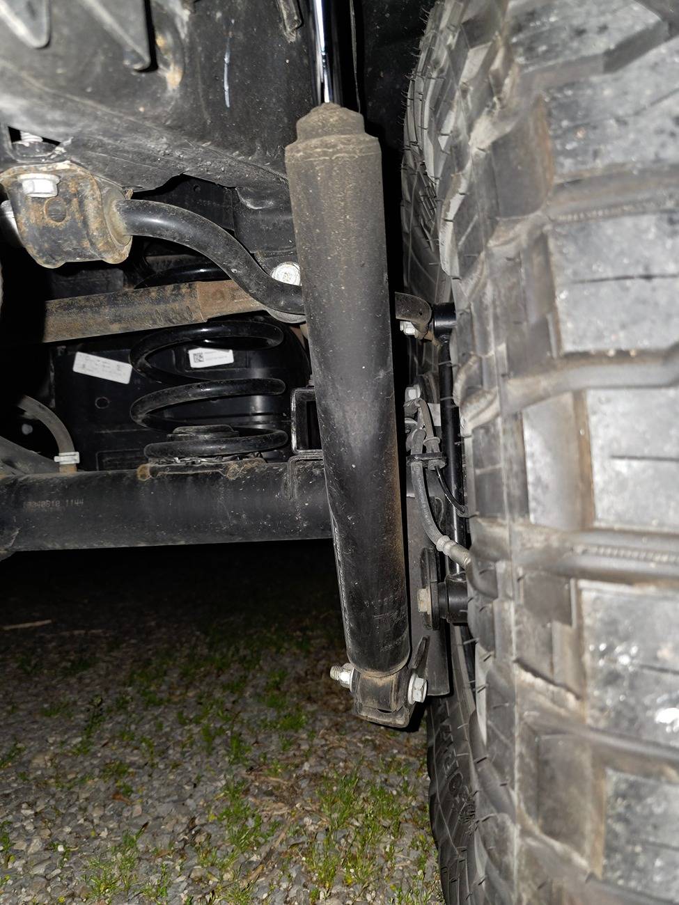

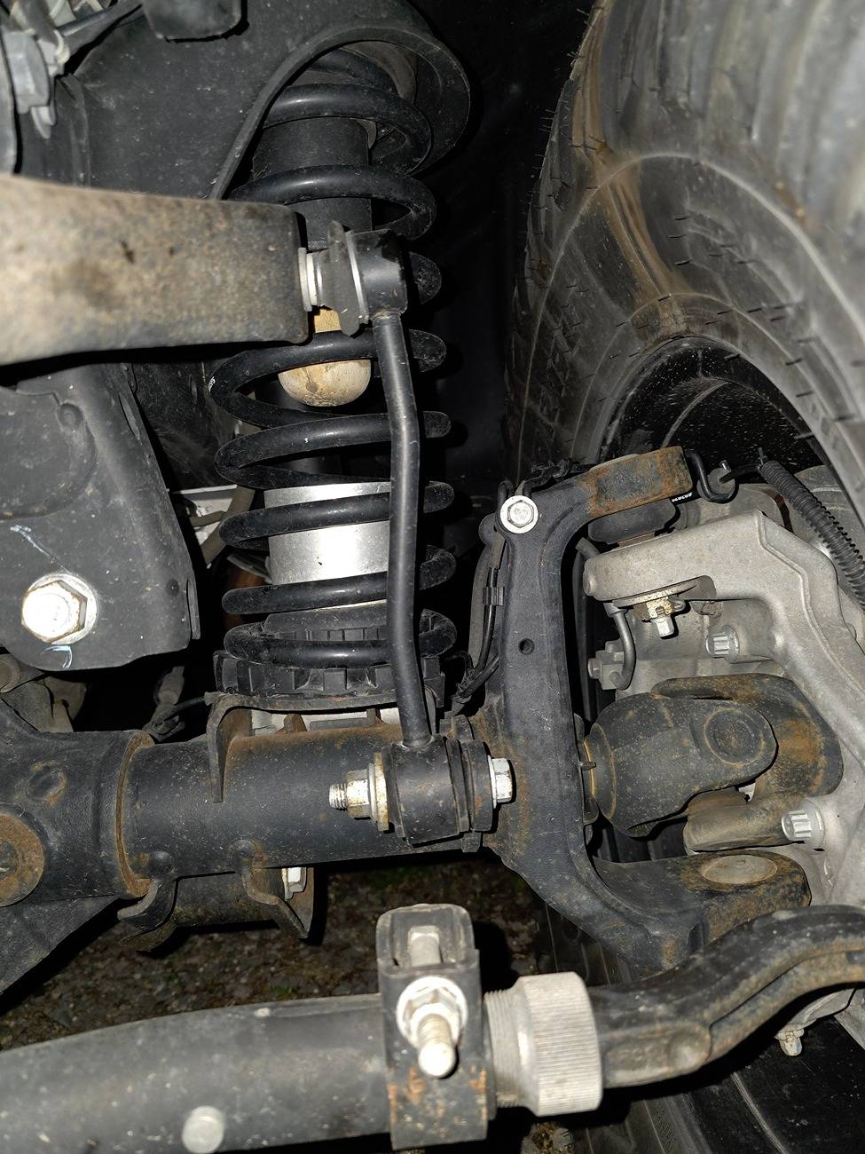

Now that Im home, I ran out and snagged a picture of each corner (as best I could without getting underneath). I also bounced a bit on each corner and the most noise is from the rear. In fact, when I pushed on the hook below the bumper, it gave me the most noise.
Coming from torsion bars, and late 60s tech..and not having put a wrench on anything yet. Does anything stand out? (Other than where the 12.5" tire is rubbing)

Next-day update: The creaking has gotten substantially quieter. I sprayed some silicone on the sway bar end link bushings and so far-somewhat better. I'm still hearing a clicking that sounds like its coming from the front (I had heard it, but figured it was related to the rear noise). Initially, the thought was it did it while turning, but as we were driving down the alleyway to park last night (holding the wheel straight) it would still make the noise over bumps.
As long as the weather holds out, I'll get back under there in the next couple of days and just hit all bushings with the silicone. The clicking is odd, and like I said earlier I'm scarred by a history of steering/suspension failures in the past with other vehicles (control arm snapping while driving, wheels falling off due to broken studs, separate instance of wheel falling off due to lug nuts backing out, ball joint falling out, ball joint stripping off the castle nut). If its a normal noise, it is what it is..I'd just like to be sure based on my past history.

Retorque your track bar bolts. I had some creaking on mine and this was the cause. Even though I torqued to spec when I installed my lift, after a while I was getting a creaking noise and the track bar was the culprit.

Sway bar bushings look pretty tired. I have replaced them once and as mentioned by @sydwloose loose track bar but mine was more of a clunk when stopping.

I second the Front track bar. It has a pretty hefty torque spec.

Alright, I finally got some time to get underneath to check the track bar..and that bad boy was wicked tight. I started to shimmy out and bumped the drag link and noticed this..
So..my brain initially said "if the track bar is solid, then maybe its the aluminum knuckle theory"..but now Im struggling trying not to go down a rabbit hole as I've already got one vehicle apart..ha!
