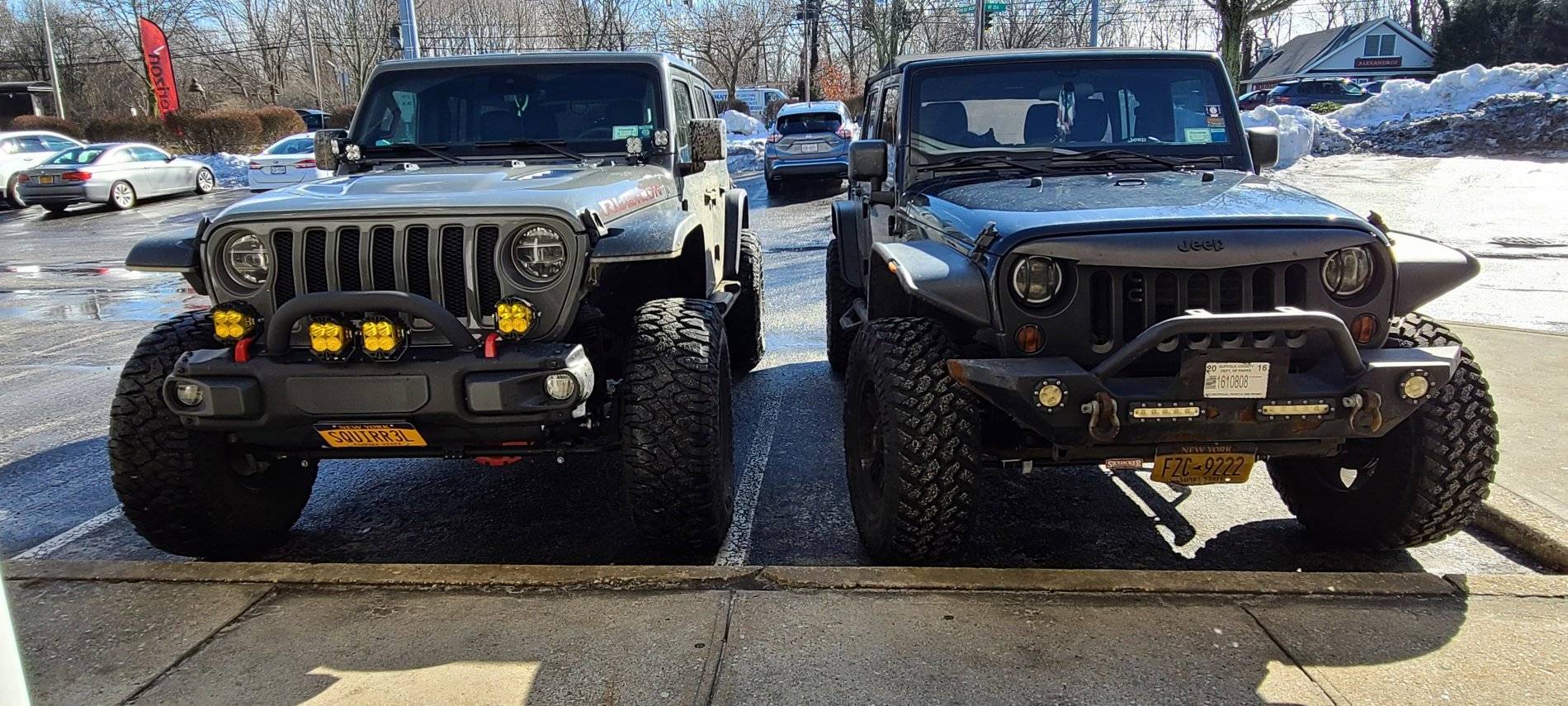

JL's start off taller than JK's and earlier generations, so lifts don't need to be as big to get the same effect. When my JLUR was bone stock, it was only an inch shorter than an acquaintances JK with a 4" lift and 35's. Now I'm on a 3.5" lift and 38's, and still have a tad more fender to tire clearance than his.
Which lift are you using for a 3.5?
