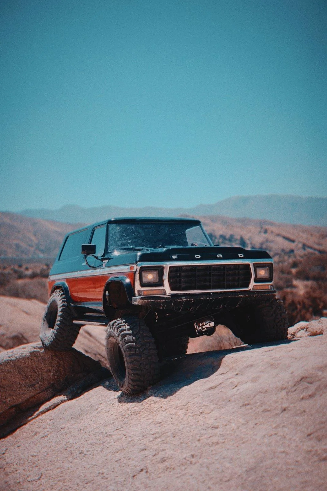

Got it, thanks for the info! I build scale rock crawlers and get to be hands-on with tiny transmissions, diffs/OD, portals, etc but it doesn't quite translate to the bigger stuff since they're usually set up single-speed for a specific purpose. Excited to get my hands on some of the real deal drivetrain stuff in the future. Pic below is my gateway drug that ultimately has me moving from an Audi to a JL.
Jeep Wrangler JL Silly noob question. 4 to 1 transfer case? IMG_7738 2

Wow a '78/9 Bronco!
edit: you should probably hang a 100# weight on that to scale the weight. And make it REALLY underpowered to mimic the 351M or 400

Just to put things in perspective, a real 78/9 Bronco woulda been 2.46 1st gear in a C6, 2:1 low range in either the NP203 or 205, and 3.55 in the diffs. The 351M made a whopping something like 152hp from a V8
So, 2.46x2x3.55 = 17.47:1 crawl ratio
A JL Rubi would be 4.71 first gear, 4:1 low range and 4.10 in the diffs while putting out 285hp from the 3.6. Of course torque curves and powerbands are different from a V8 to a V6, but still you can see which might be better for, well, almost everything
So 4.71x4x4.10 = 77.2:1 crawl ratio
I love old iron but there's a reason it's old sometimes
