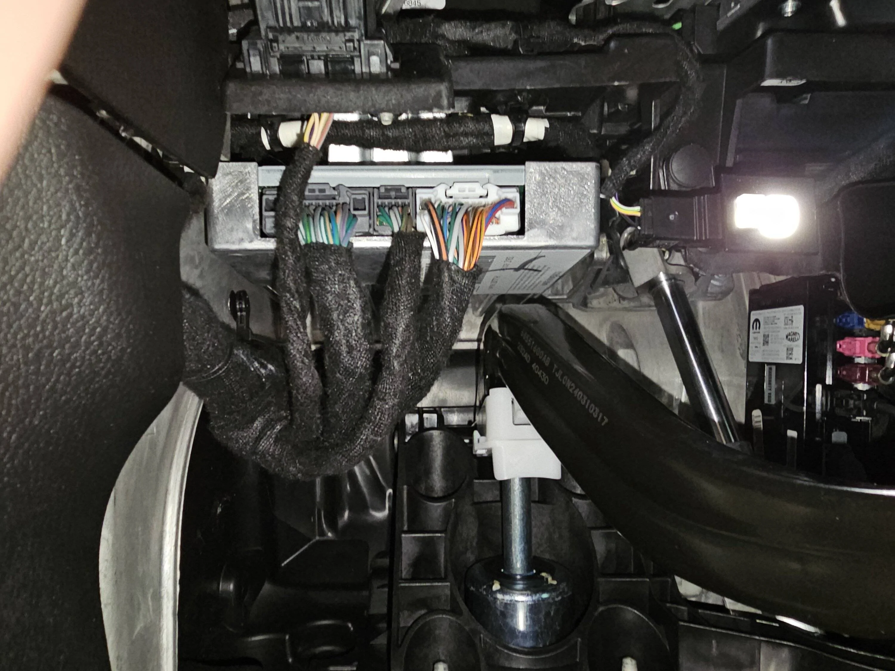

So I have a 2024 Rubicon X 4xe and tried to find the security module under the drivers dash to re-route the cables to my chrylser bypass module and simply cannot find them. Ive watched several youtubes on where the module is and how to unplug the two cables, I simply do not see a module like that under my dash. Did something change with the 24s?

Well that sucks. Behind glove box doesnt look promising. I hope the 2024 4xe supports Jscan / tazr. that would blow

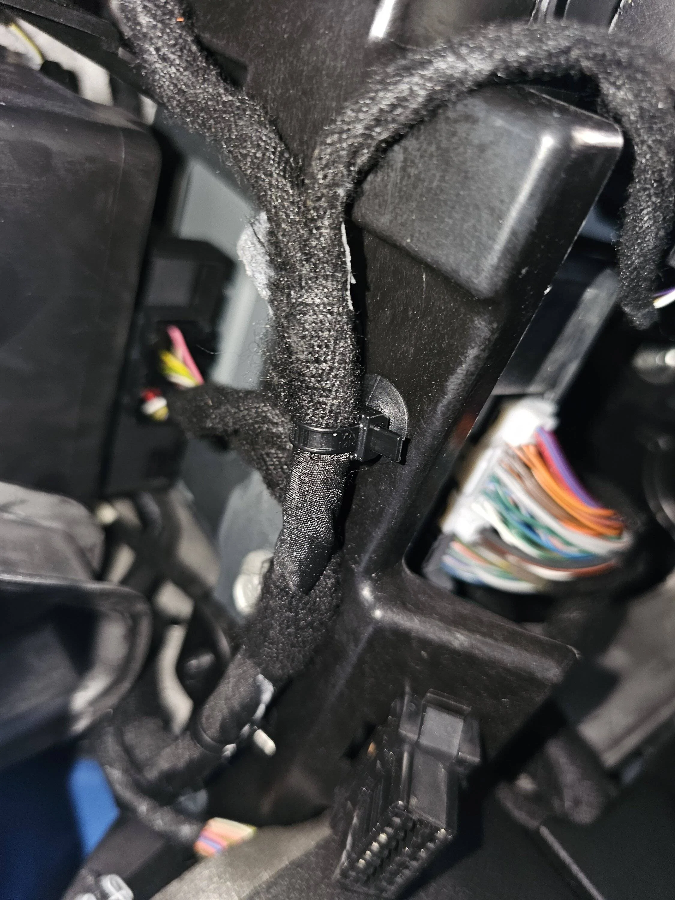

I assume you've pulled off the driver's side knee panel under the steering column? Looks like you're taking pics from the floor. You need to get behind that panel.

Yes Im an idiot. Pulled off the knee panel and found it. Thanks all!

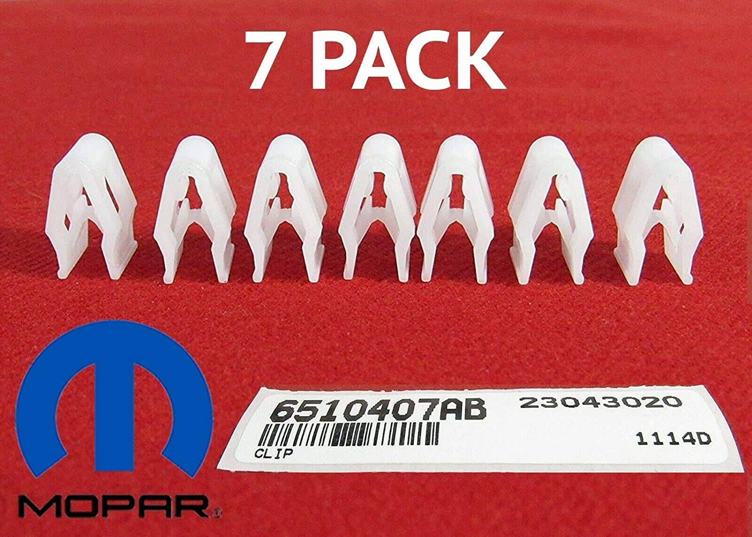

General FYI for anyone reading this thread, The little white clips used on the back of the knee panel are also used throughout the dash assembly, among a few other types of clips. If you plan to do any other work under/behind the dash, it's good to keep a few of these around as they don't always hold together when removing the panels.
Mopar part 6510407AB
Clip, Cluster Bezel to I/P

I know I keep a few handy... I have posted a few times in the past about this white clip. You can get a 7 pack of Genuine Mopar one's on Amazon for a decent price.
Jeep Wrangler JL No security module in 2024 Wranglers? 71gPSDaoqLL._AC_SL1500_
https://www.amazon.com/Mopar-CHRYSLER-DODGE-Instrument-Center/dp/B07BFKBD13/ref=sr_1_3?keywords=6510407ab&qid=1698338637&sr=8-3
https://www.jlwranglerforums.com/fo...anel-under-steering-wheel.118471/post-2466757

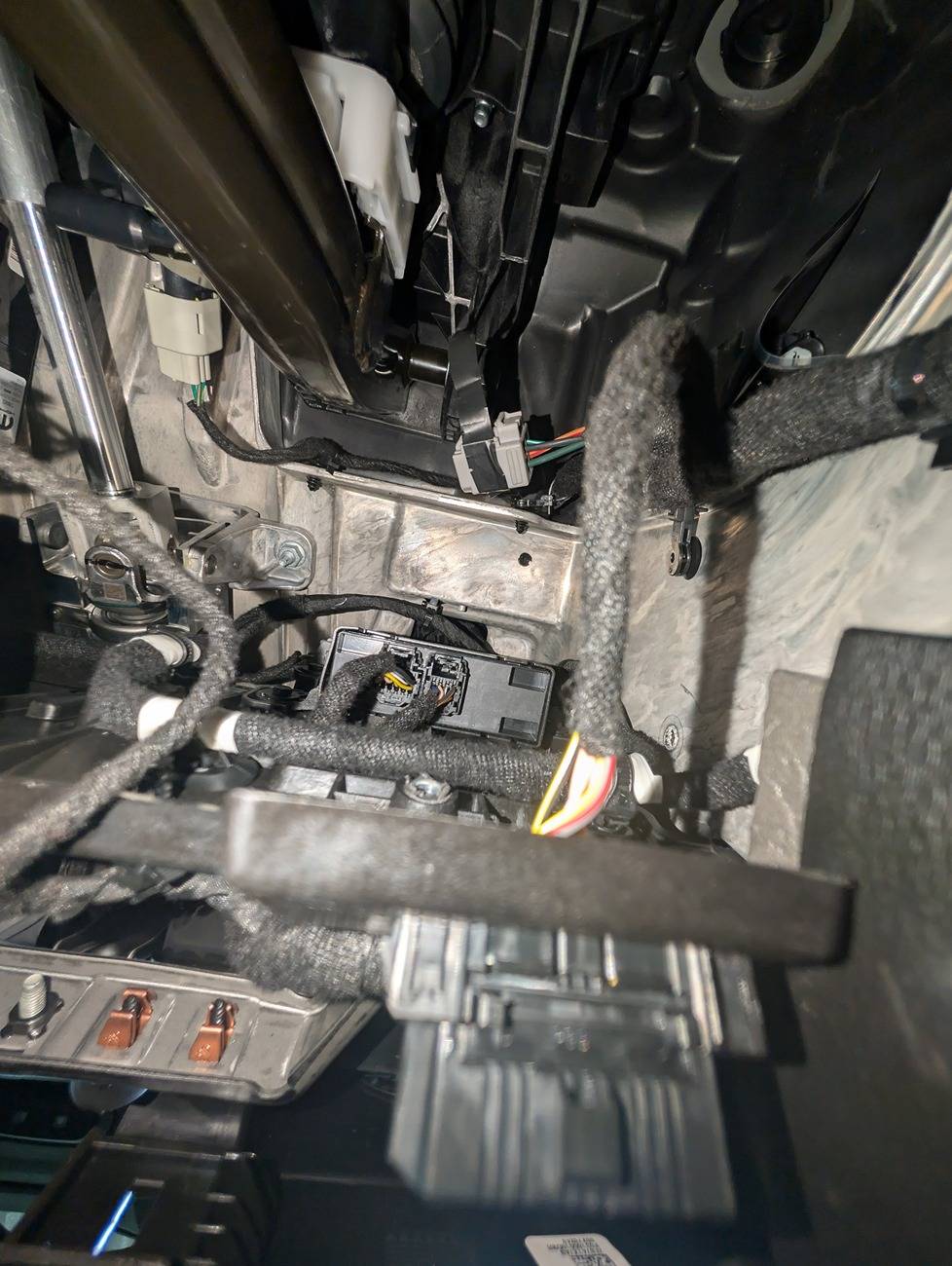

Finally found it on my '24 Willys 4Xe (no surprise it's in the same place as the Ruby) thanks to this thread.

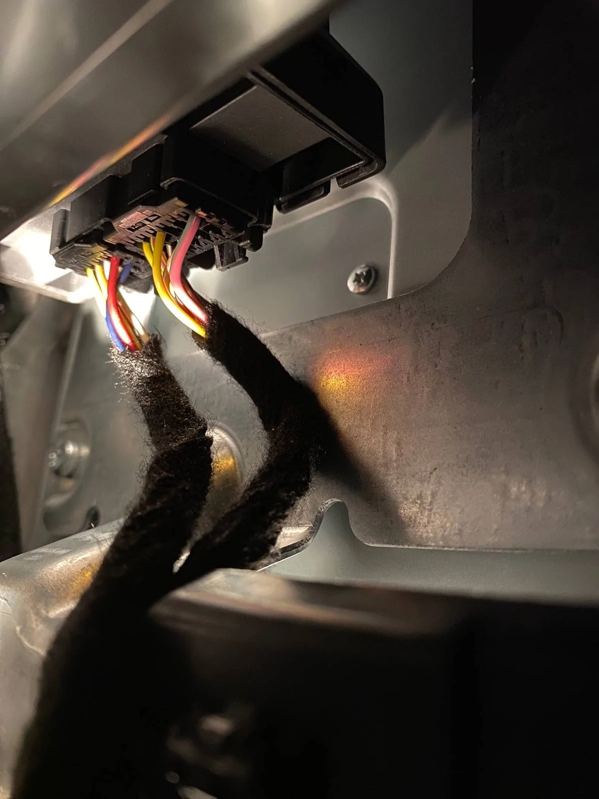

Another picture for you poor bastards with new 2024 builds haha. I don't think it's actually necessary to remove ANY panels if you practice yoga on a weekly basis or are strong in the ways of the force and can feel the two plugs. The box is directly above the Old Dirty Bastard 2 port and attached to the back of the speaker pod. Sidenote: after watching the removal of the speaker pod from a braver dude than me I'm not going to be upgrading these speakers myself, much more difficult than pre-2024 JL's.
This is a .6 lens shot, it's literally directly above the OBD2 port.
