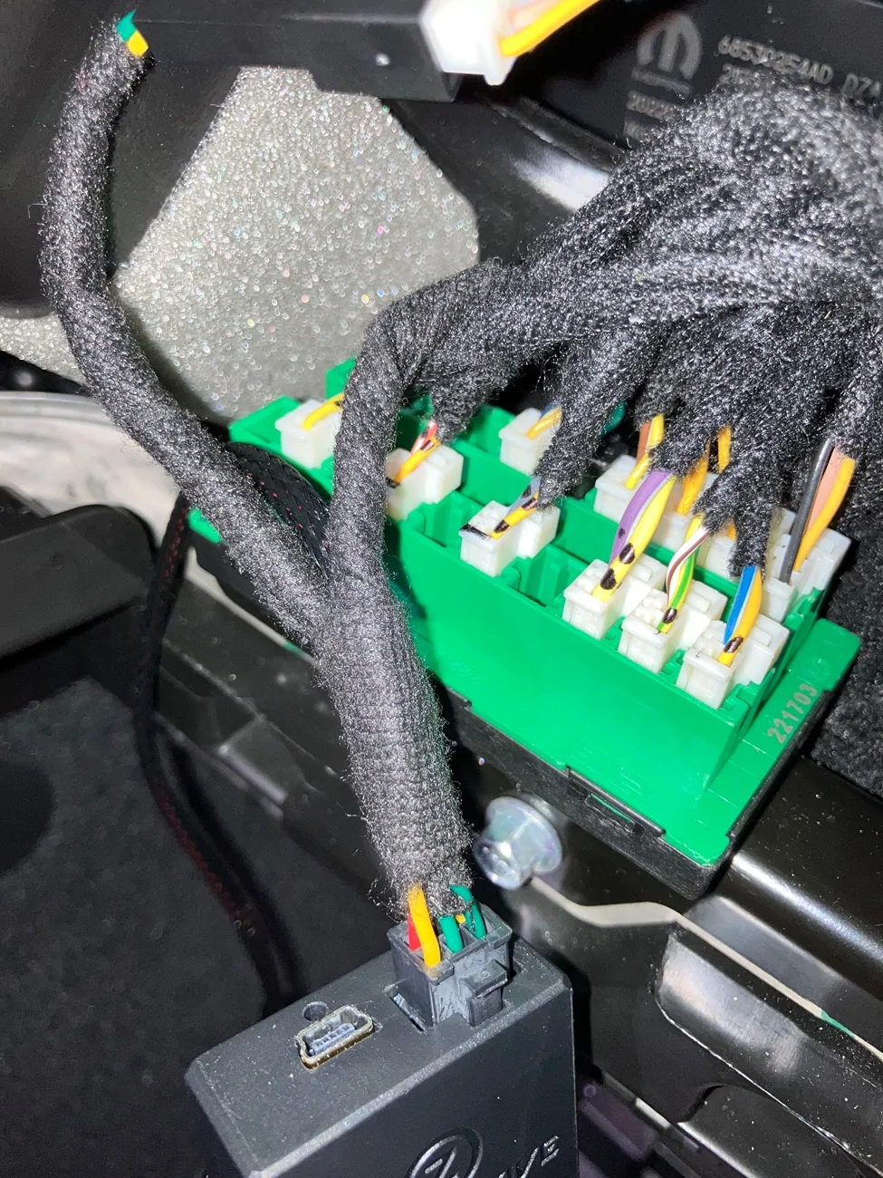

I did install the unit today, very easy. Will program and set new password tomorrow, as well as figure out how I’m going to use the box

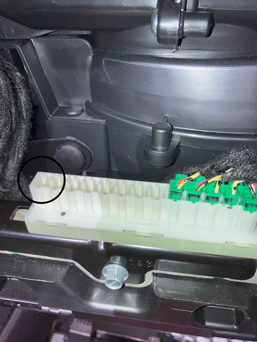

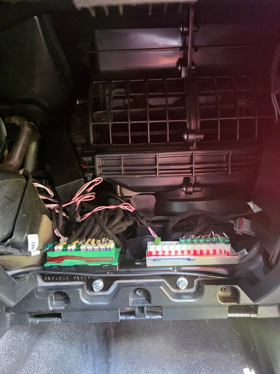

Was Thinking about how to use the security enclosure box. The White CanBus can Fit inside the box along with the NoLimitz Unit. I installed the unit by Plugging the NoLimitz into the green Connector. The instructions say to use any open CanBus Connector. Anyone Know if it would work on the White CanBus? I have e-mailed Z automotive, but have not beed successful so far in connecting with them.

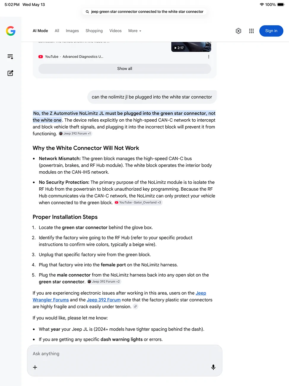

Found the answer, and the white cannot be used.
. The device relies explicitly on the high-speed CAN-C network to intercept and block vehicle theft signals, and plugging it into the incorrect block will prevent it from functioning. [1, 2]
Why the White Connector Will Not Work
  • Network Mismatch: The green block manages the high-speed CAN-C bus (powertrain, brakes, and RF Hub module). The white block operates the interior body modules on the CAN-IHS network.
  • No Security Protection: The primary purpose of the NoLimitz module is to isolate the RF Hub from the powertrain to block unauthorized key programming. Because the RF Hub communicates via the CAN-C network, the NoLimitz can only protect your vehicle when connected to the green block. [1, 2, 3, 4]
