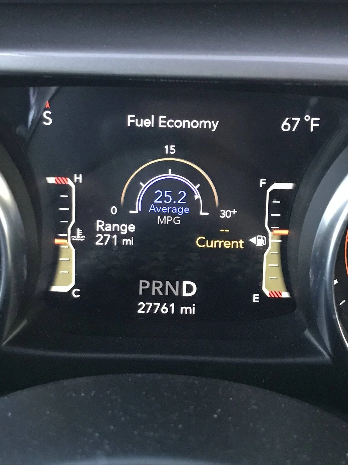

I will add one other item. As mentioned in my previous post, I do have a 2.0 with 35’s. I also have the 2” Mopar lift.
At nearly 30k miles I am setting at 24-25 mpg.

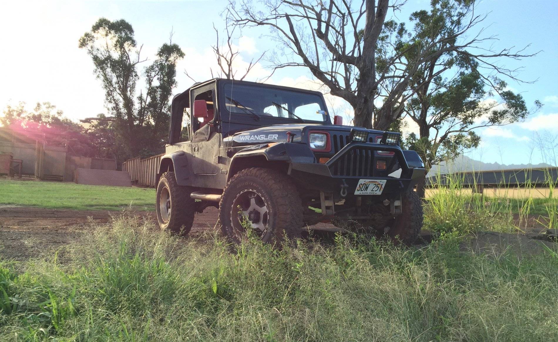

That’s utter nonsense, disregard those Facebook posts. The only jeep I ever had issues getting up to highway speed with was my old 1994 YJ with 3.07 gears, 35” tires, and a vacuum leak that made it bog when applying the throttle.
