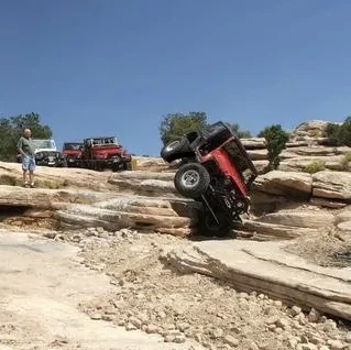

53-degree lean...that said this Jeep is HIGHLY modified and when I engineered it and included off-camber in the rocks...Big plus is NOBODY will ever ride with me.
The everyday Jeep, dunno. I will tell you this building to attain this was not easy, took a lot of shifting weight. Using a 4 corner weighing system I am +/- 25 lb all the way around at each tire

OMG!! That looks INSANE! I think that’s a ways off for me…
