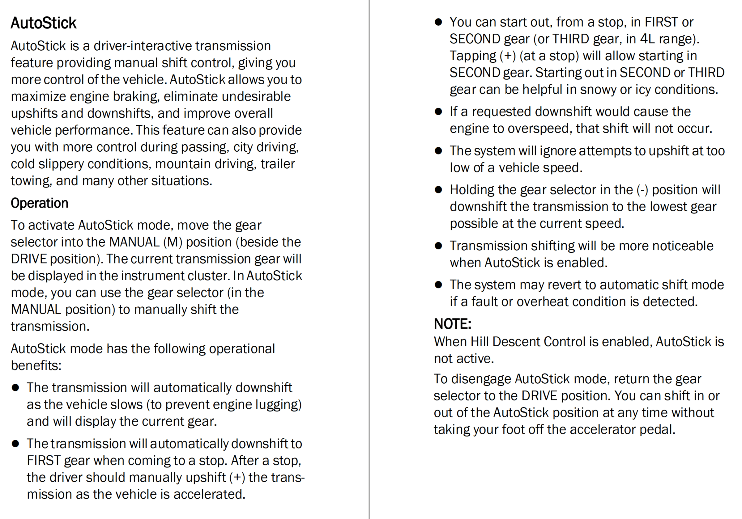

Oh, no, don't let off the throttle completely when shifting an automatic; that'd be dangerous and would be rough on the drivetrain (and possibly your neck).
Manual/Standard transmissions have a clutch that disconnects the transmission from the engine--that's why we let off the gas when engaging the clutch; otherwise, the engine would rev up quickly, having its load suddenly removed with throttle still applied. cf. power shifting
Regular automatics (not the dual-clutch transmissions--a completely different animal) such as ours have a fluidic connection via the torque converter. Since the engine and transmission are always connected, completely letting up on the throttle will completely reverse the momentum in the entire drivetrain and suddenly decelerate the vehicle. Up-shifting at this time (where downshifting would be what's called for, depending on how much the vehicle decelerated) would exacerbate the stress within the transmission and the (lack of) responsiveness of the vehicle.
If your concern is smoothness and being easy on the drivetrain, just up-shift with a moderate-to-low load on the drivetrain, pretty much as it does on its own, not in manual mode.
If your concern is performance, you wouldn't want to let up on the accelerator anyway and that is perfectly fine.
Definitely read the manual. pp. 162-163 explains Autostick:

@Maverickxeo,
Modern automatic tranny's all have a dedicated Transmission Control Module (TCM). The AutoStick (manual mode) feature is primarily a function of software.
It works by using the shifter or paddles to 'request" either an up or down shift from it's current gear overriding the computer (automatic) control. However, this manual shift is still just a request.
The TCM continues to monitor for any and all transmission fault conditions. It WILL step in and temporarily shift into an appropriate gear (automatically) to prevent any potential damage, to either itself or the engine, such as redlining (if it can).
It will however try to 'honor' your requested gear as best as it can. And overall, it is pretty good at honoring your manual selection.
Also, as per the post above by @Initial-Jeep, the torque converter is always still in-play. Do you ever let off the throttle in full automatic? Can you anticipate when the TCM is going to shift and compensate with the throttle? Of course not.
AutoStick mode is no different. In fact with a well implemented TCM and Engine Control Module (ECM), these two controllers perform a very finely coordinated ballet. They dance an intricate choreography over the internal CAN bus with lots of electronic information exchanged while performing the art of shifting. The throttle can be altered by the TCM, thus overriding the value from the accelerator pedal.
Recall here that the JL, as with almost all modern vehicles, no longer have a mechanical throttle linkage. The accelerator pedal is nothing more than a sophisticated potentiometer which simply inputs a requested throttle position to the ECM. The ECM however is the ultimate authority on where it chooses to get it's throttle data from. When shifting (of any type), the TCM can alter this digital throttle information.
When in AutoStick when you manually shift, the TCM receives your request and will do all of the same things it would normally do just as if the computer decided to do it. This digital CAN dance unfolds without any regard to where the gear selection request came from. Even better, all this happens in typically a few hundreds of milliseconds.
Try that with your left foot on the clutch!
So no, there is absolutely no need to perform any throttle management. This intricate digital dance is all accomplished without any intervention required on your part. It will just auto-magically happen.
