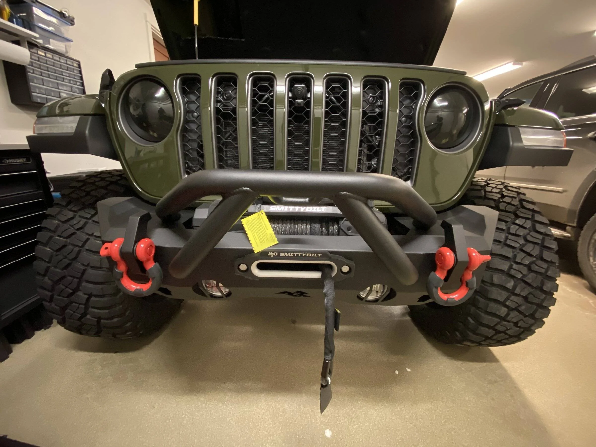

Just installing a X20 Gen3 12k on now. Looks like a great winch! Can’t wait to use it (or…I guess I can wait ?). Never used a winch before though, so can’t say to how well it performs. I really like the fact I can have a wireless remote (with a flashlight) if I want or just keep it plugged in. I REALLY like the synthetic line.

What bumper and winch plate are you using? Cant wait to hear how it goes!
I went with the Rugged Ridge HD Stubby (comes with included winch plate) with the additional X striker bar. Super tight fit, but it fits nonetheless!

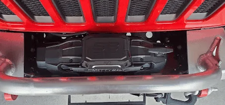

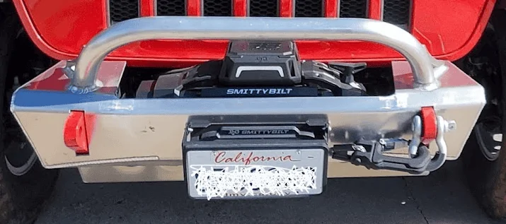

I have a Next Venture alum. front bumper and the winch fits perfect, tight.

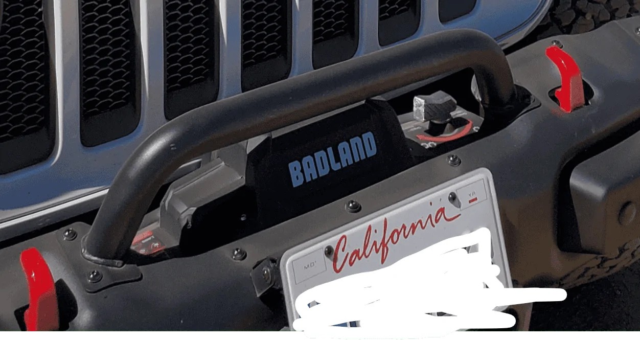

We also have a 2021 2dr Rubicon with steel bumper but with the Badlands winch. It was tight too and we had to trim a bit off the handle to clear the bull bar.
Looks like the Smittybilt fits in the front pretty well from side to side; was it just pretty snug from grill to fairlead? Any modification required?
