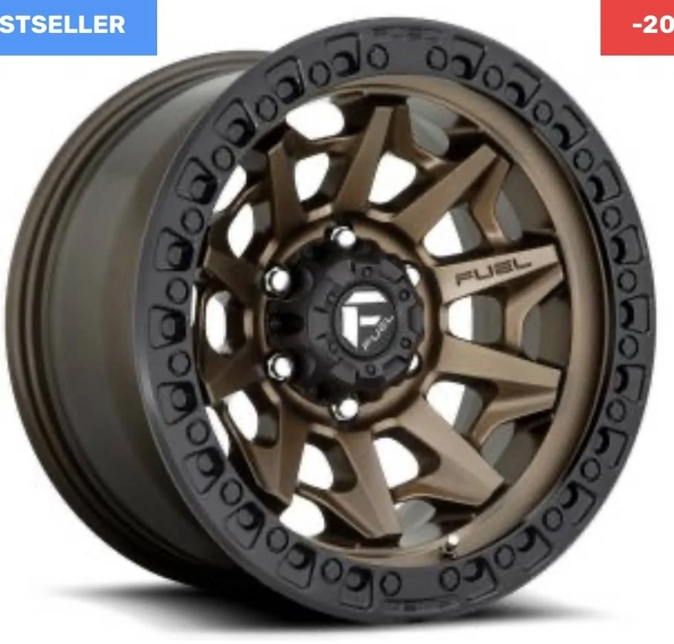

Hello Jeeper family…
Do you happen to know if my OE lug nut sets fit for these new wheels? (As pic below)
I got a 24 wrangler 2 door sport, so with steel wheels now
thanks

Yeah- you need black ones
Sorry- don’t know if steel and aluminum use the same. But, I had to get new spline lugs for new wheels because the socket rubbed them with the OEM style…. It never crossed my mind. Found out when the tires were mounted and they started to install them, fortunately, they had black Gorilla splines in stock.

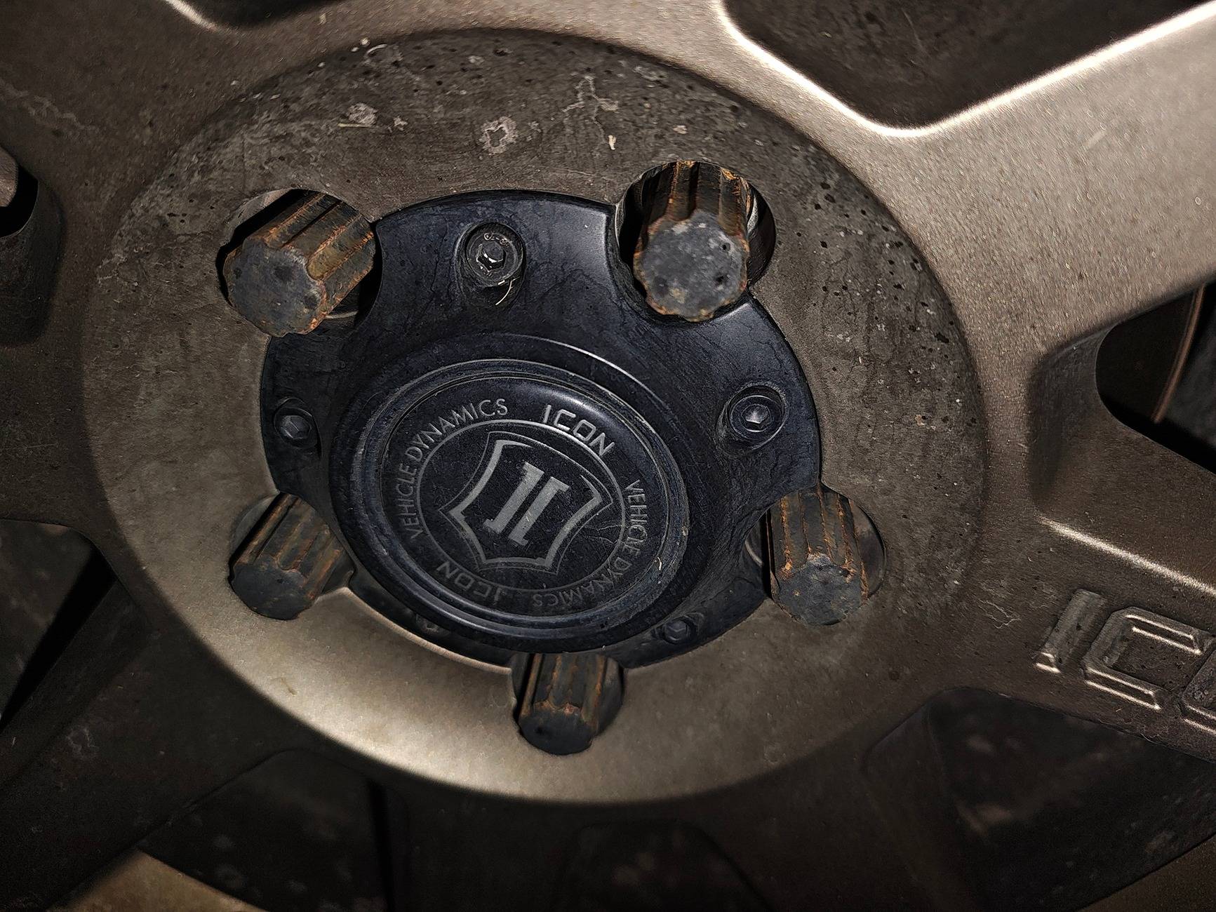

I've had my black gorilla splines on the Wrangler for a minute now. Maybe like a year, maybe a year and a half, they're rusting..
Jeep Wrangler JL New lug nuts needed? 1000002292
I've been meaning to upgrade them to a better quality steel lug nut, or ideally a titanium one, I just haven't gotten around to it. I mean these are still steel, so they're holding up just fine. A little bit of rust isn't going to kill them, at least not yet anyways.

If you're buying these new, they should come with new nuts. It looks like factory ones are conical seat, which is the same as most aftermarket wheels. So good either way.
The car shop I deal with asked me to provide nut sets myself as new wheels won’t come with nuts. I have a high doubt about it

Just my 2 cents on those wheels (as my son threw them on his JKU) water will sit in the Grand Canyon George between the bronze wheel and the simulated beadlock. Secondly, unless you have teeny tiny hands to fit in-between the small (for lack of better term) spokes I wouldn't throw them on if your fitting anything above a 35, because you just can't get a good grip on the damn things.
Not Titanium. Titanium is very prone to galling. Galling in threads is a very bad thing.
