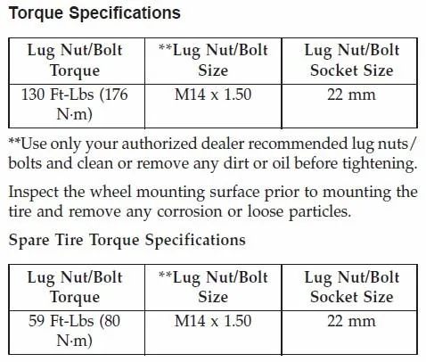

Does anyone know what size sockets are used? I got a flat already and didnt have anything larger than 21.

2018 JLU Rubicon
Am I the only one who looks at the owmer's manual? :)
Haha Thank you sir. For some reason i couldnt find it in the online manual.
