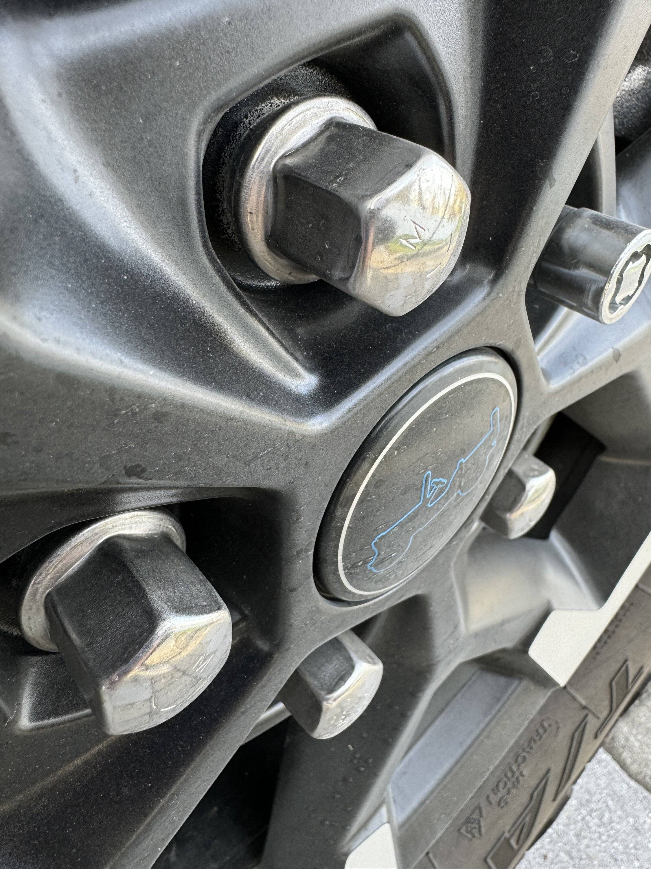

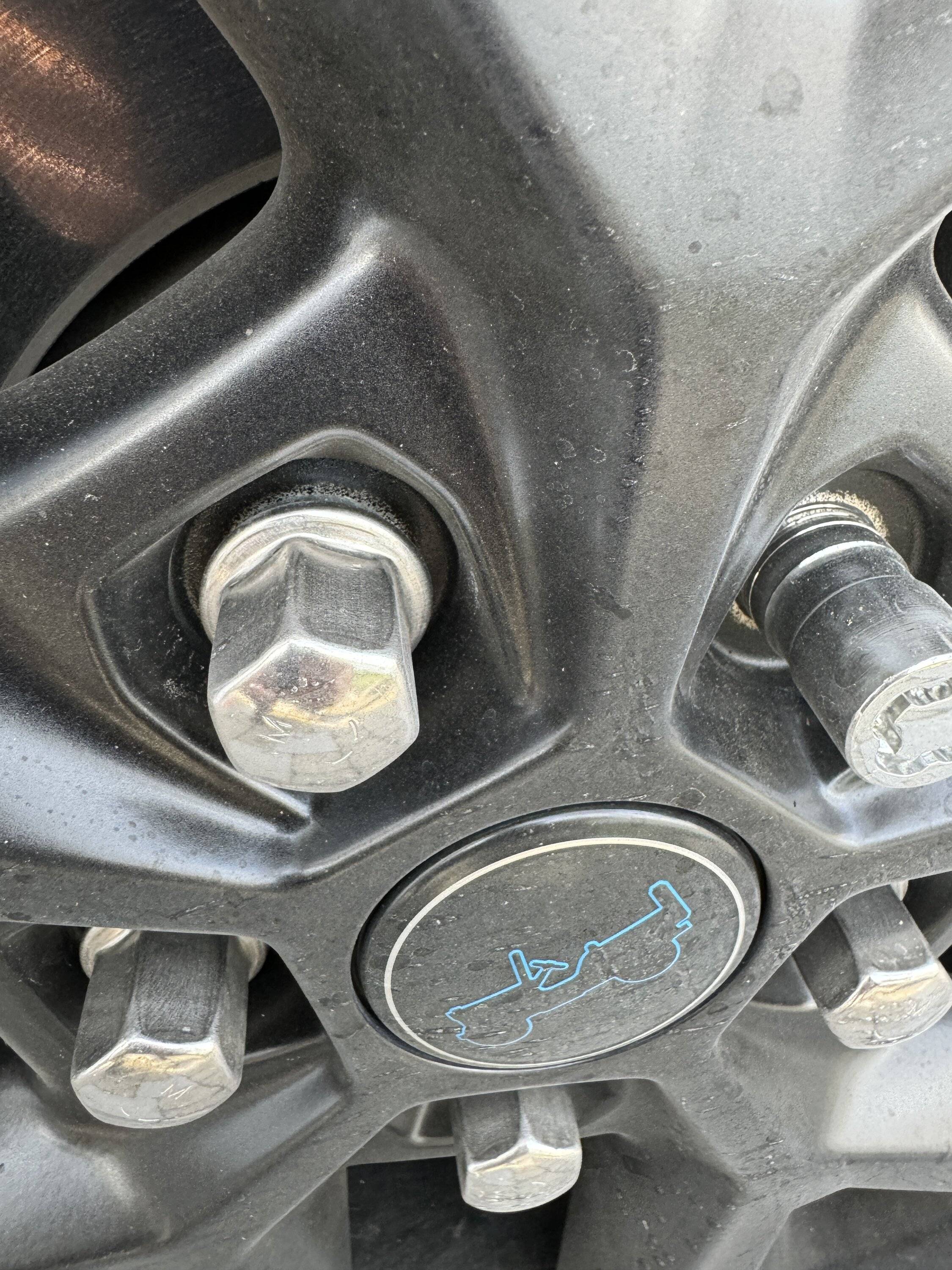

2024 Wrangler 4xe. The lug nuts on my wheels from the dealer do not right to me. They don’t seem seated all the way into the concave hole in the wheel. Is this the correct size lug?

Those are OEM. The "M" with the two "curved lines" are what is marked on the stainless steel capped OEM lug nuts. They are identical to the OEM lug nuts on my 2022 Willys. Mopar 14mm x 1.5 Mopar 6509422AA. They are seated properly. They have a long and wide 60 degree cone.
