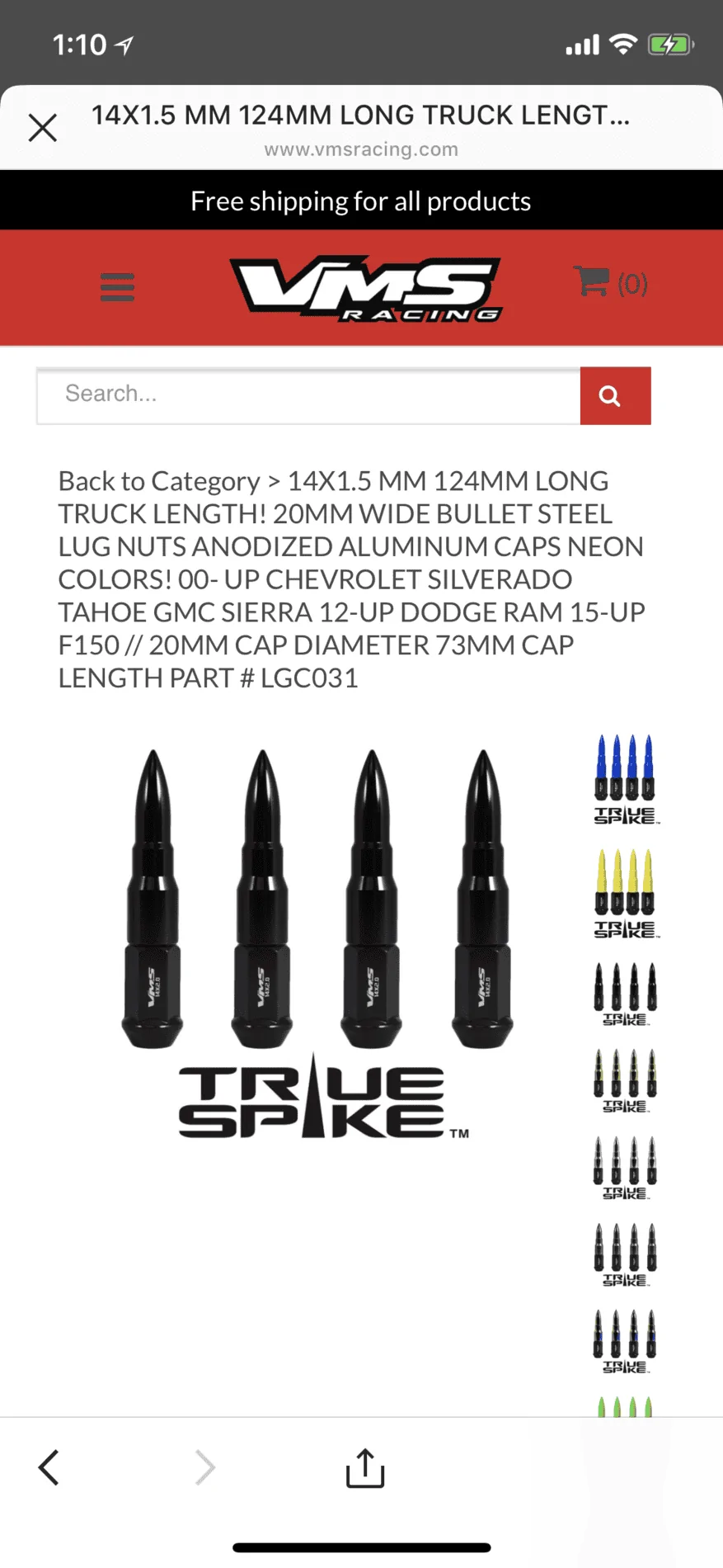

And back to the original question of the post finally.. What length? Is any length ok? Is size the only important thing? I'm not going crazy long, just add some nice flare.
Length only matters in that you need them to have enough thread and length to snug the lug nut taper up to the wheel. These look like they will easily do that...as long as the thread runs at least about an inch up in to those 50 Cal lugs.
Also, keep in mind you will need to keep a 20mm lug wrench in your Jeep since the OEM wrench is 22mm.
