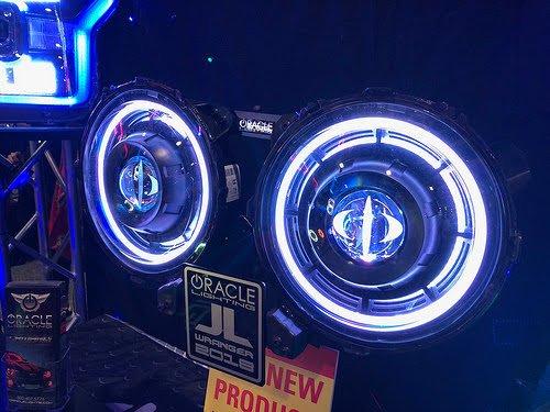

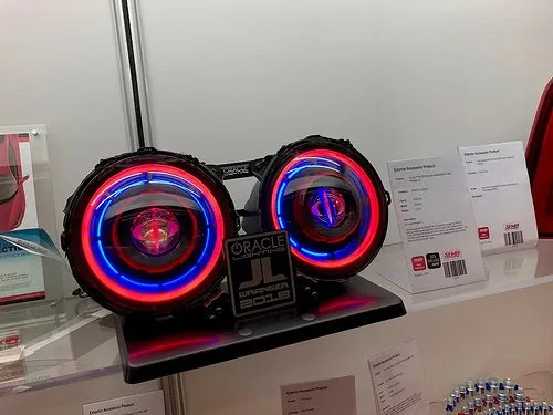

Rainbow colors are my thing either. These also may have an option of color change or the regular standard headlight white. From a quality standpoint they look promising and they are 9” housings that have no extra bracket to fit. We shall see!

If these have a halo option are they going to be plug and play as the factory halos utilize a 4th wire that is not there for those of us that run halogens and I don’t want to splice into side marker wires so I’m hopeing this is addressed in these lights

These halos are installed on the lights but would wire how I did it in this video or with a switch:
