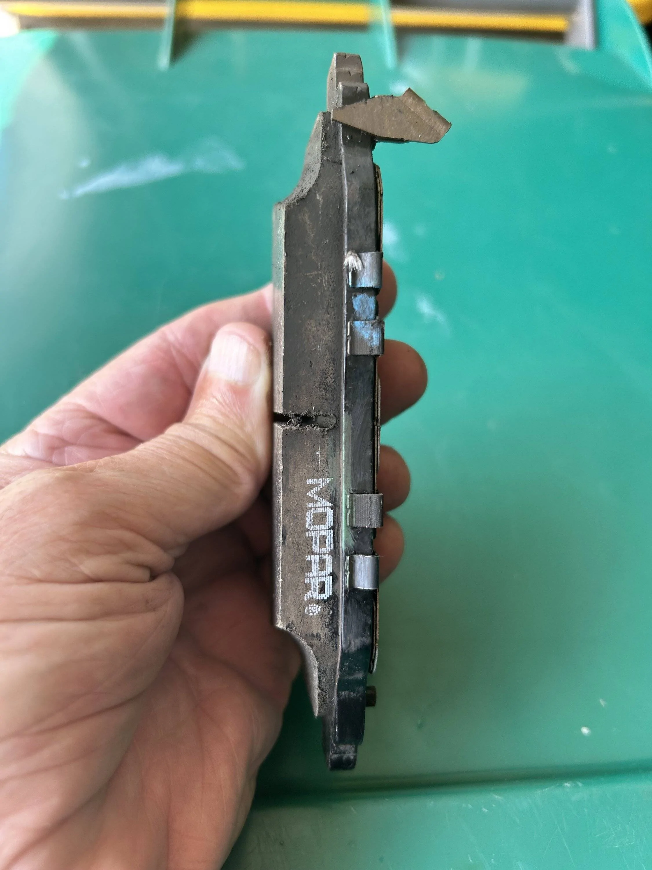

Fitzz47
Jim
Sep 7, 2019
151
303
Delaware
2018 unlimited Sahara jl
This is the pads my dealer told needed replaced. I replaced my pads myself. And did not change rotors. I have a 18 Sahara. Don’t ever trust your dealer.Sahara and Rubicon have the same Heavy Duty pads. As you can see I didn’t need pads.

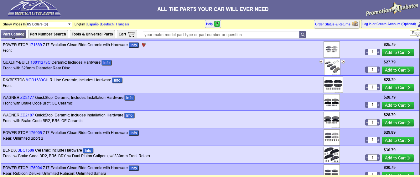

I just looked at rock auto, I'll be damned, they only sell rotor pads and disks as kits, thats what mopar does I bet, and all the brake parts are companies I have never heard of, from $98 an axle to $500 for all four. At Autozone, You can get just pad for 35 up to $90 per axle for duralast gold ceramic, those have worked well for me.
I'm on rockauto, I see plenty of brake pads alone.
