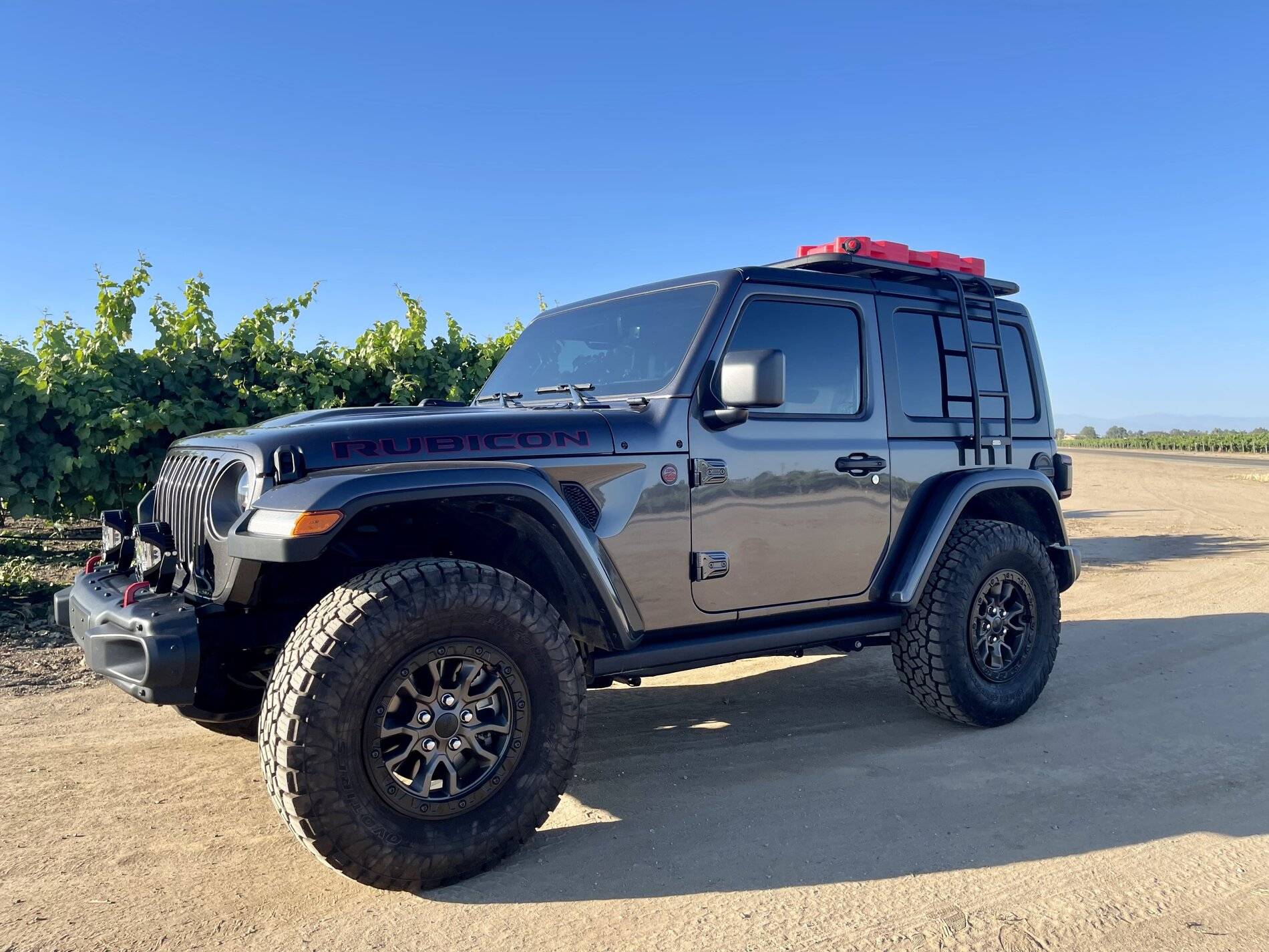

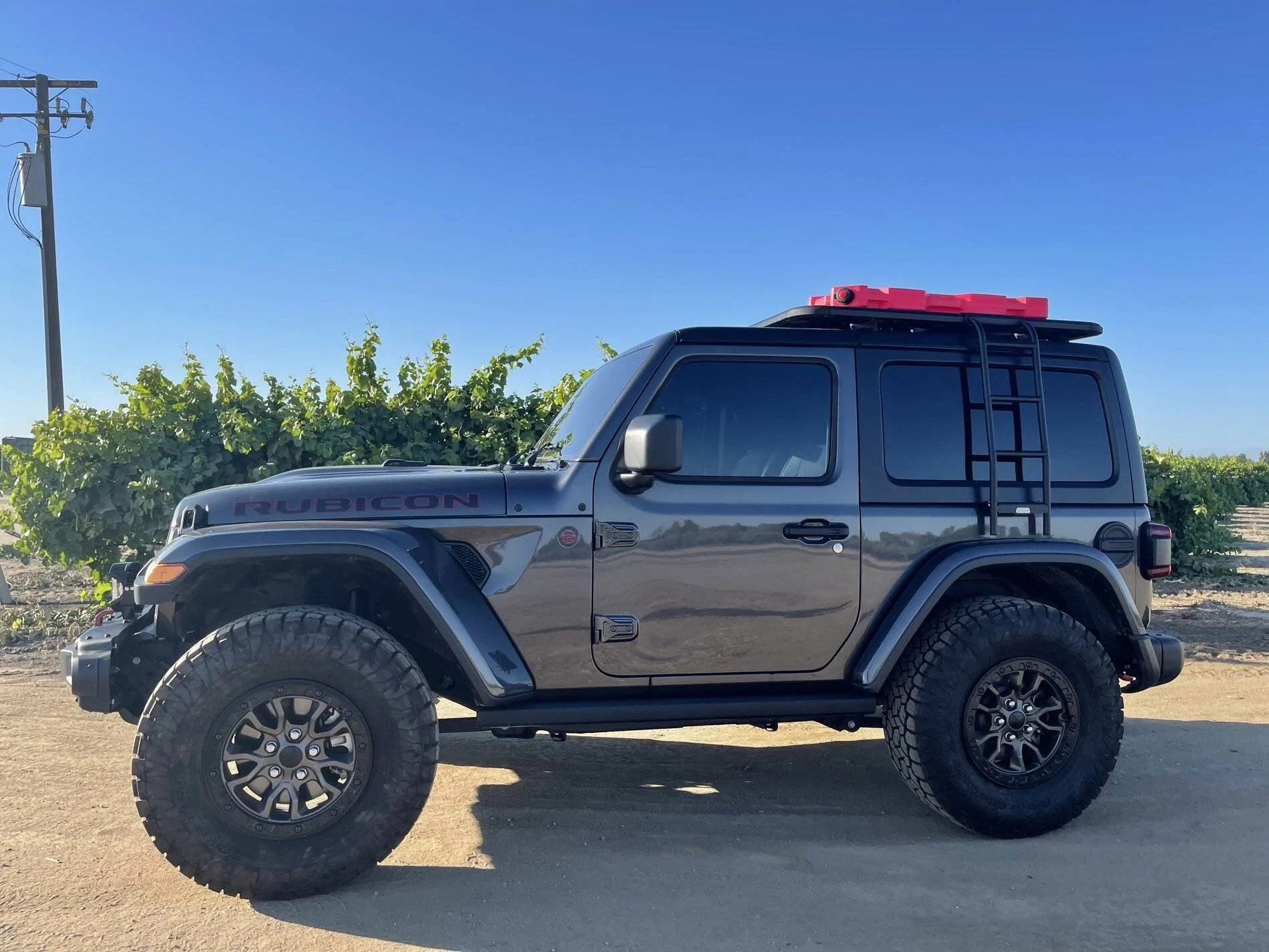

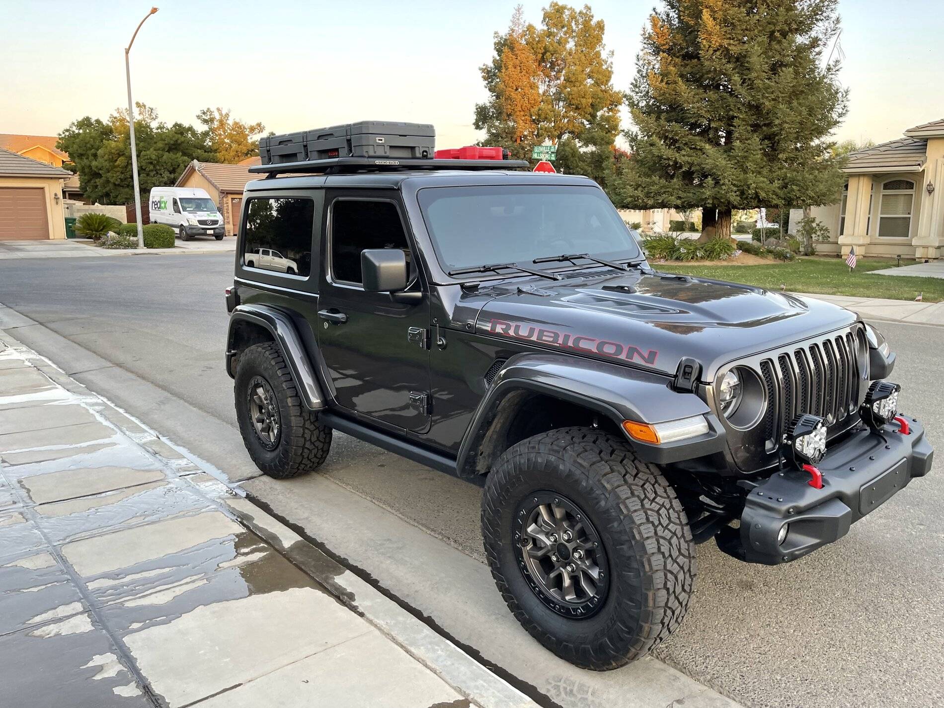

i am running 305/70/17s toyo 10 ply at3s on my stock rubicon. also have the 392 rims so its running the +44 offset. measures around 34.5 inches. my commute is from central California to the bay area. 123 miles 1 way. 74 mph in 8th works for me. love the stance and can still clear things.

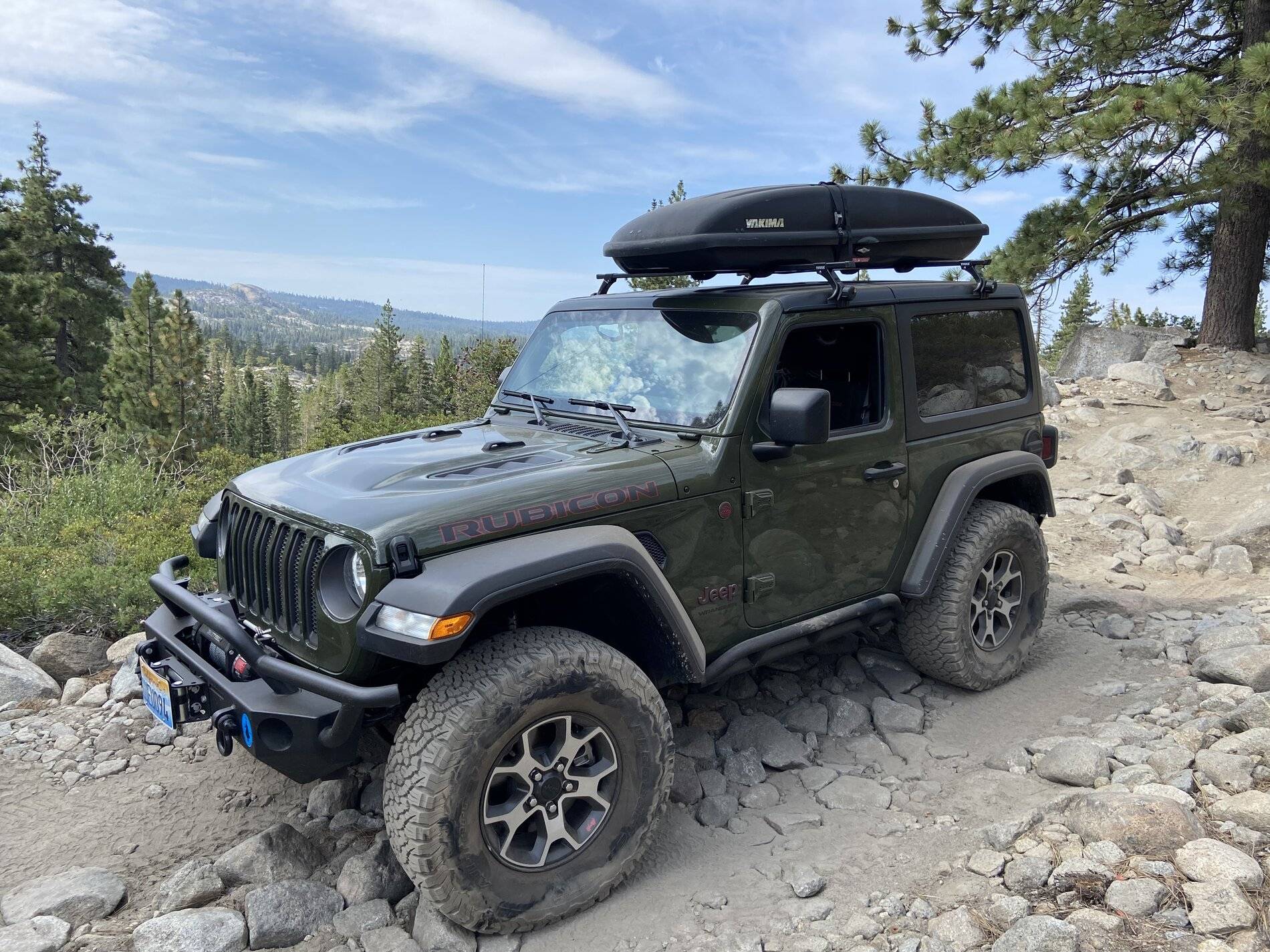

No real issues on harder trails. It just did the entire Rubicon and came back home doing 85mph most the way.
How did it do on the rubicon? I’m guessing pretty good if u could drive it 85 back home.

Dam that looks good! Ever take it down any trails?
Yeah mostly in the eastern Sierras and a local trail in the Bay Area, handles like a champ and no rubbing. This is my 4th Jeep and honestly love this setup.

It worked awesome on the Rubicon. You can’t get away with a lot of rock to skid plate contact on that trail even with 37s. JLs are still a real Jeep.

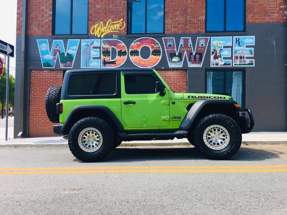

35s No lift drives perfect no rubbing unless you got crazy flexing going on

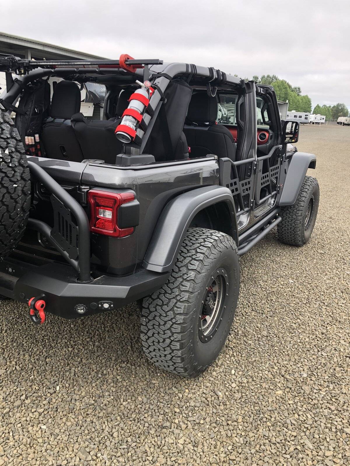

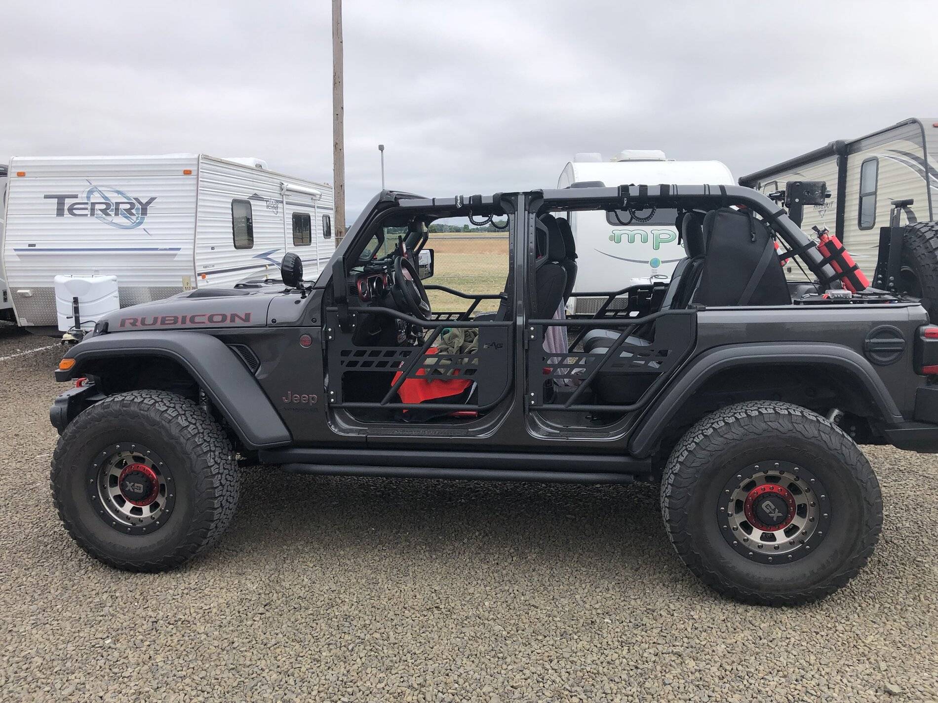

Kind of. Ur saying bc the 37 is physically taller it has more inertia going down the road thus putting more stress on the components of the Jeep?
One way to understand this conceptually is a full rotation on a 37” tire moves the Jeep farther than one rotation on a 35” tire. The engine is doing more “work” with each revolution. If you look at the sprocket/gearing on your bicycle in terms of pedaling difficulty and distance traveled per rotation it may also help. For me, that’s a helpful way to think of the “power-drain“, but everything about the larger tire also imparts increased stresses on the steering components and accelerates wear over time. Having said that, the difference between a 35” and a 37” tire isn’t huge — particularly if it’s the comparatively light (and short) BFG KO2.
I have the Mopar lift. Installation is straightforward, but this time I opted for dealer installation for three reasons. 1) I’m getting old, and lying on the concrete wrenching for hours hurts more, and 2) 95% of the Mopar lift complaints came from folks who did their own installation, and 3) I wanted to retain full warranty coverage without argument. The lift has been great, but I did swap in LCAs and a yeti to perfect the steering.
I ran 315s for a while, but I’ve been running 37” BFG KO2s for more than a year. Drives great. Plenty of pep. My JL with the stock 4:10 gearing has MUCH more pep in every situation than my old TJ with 456 gearing and 33s. (I have a 2019 JLUR with the 6: my brother, also running 37s on his 2019 JLUR, has the 2.0 and feels the same way.) We live in Oregon and Colorado respectively, both run in the mountains, and we have no shortage of power. If I had money to burn I’d probably go to 456, or maybe even 488 gearing, because it would restore closer to OEM gearing, provide more low end grunt, and make better use of overdrive, but it’s a very low priority. (My next big purchase, for the Jeep is the Alcon brakes. After seeing the improvement on my brother’s Jeep I really want them, but I can do a lot of hunting, fishing, and diving for $4,000, so it may be a while before I pull the trigger on the brakes.)
With the shorter wheelbase of the two-door I would favor the 35s, especially if it’s a DD, but the 37s have been a great choice for us.
