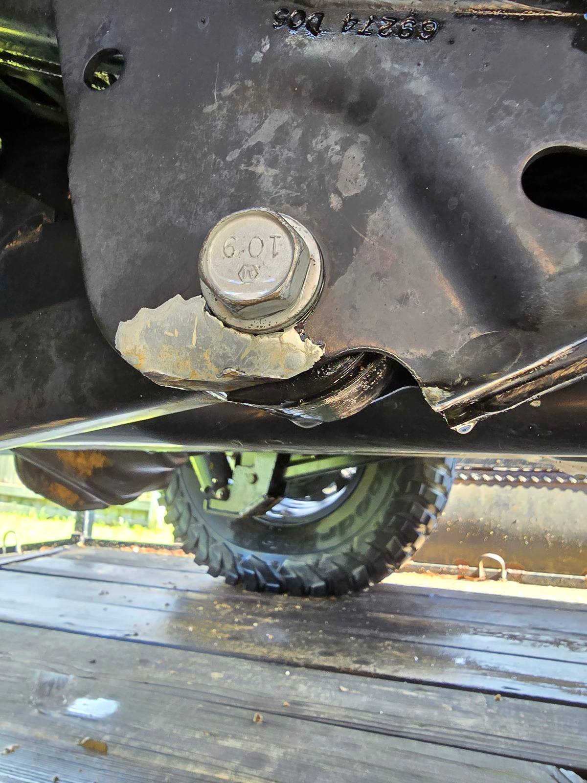

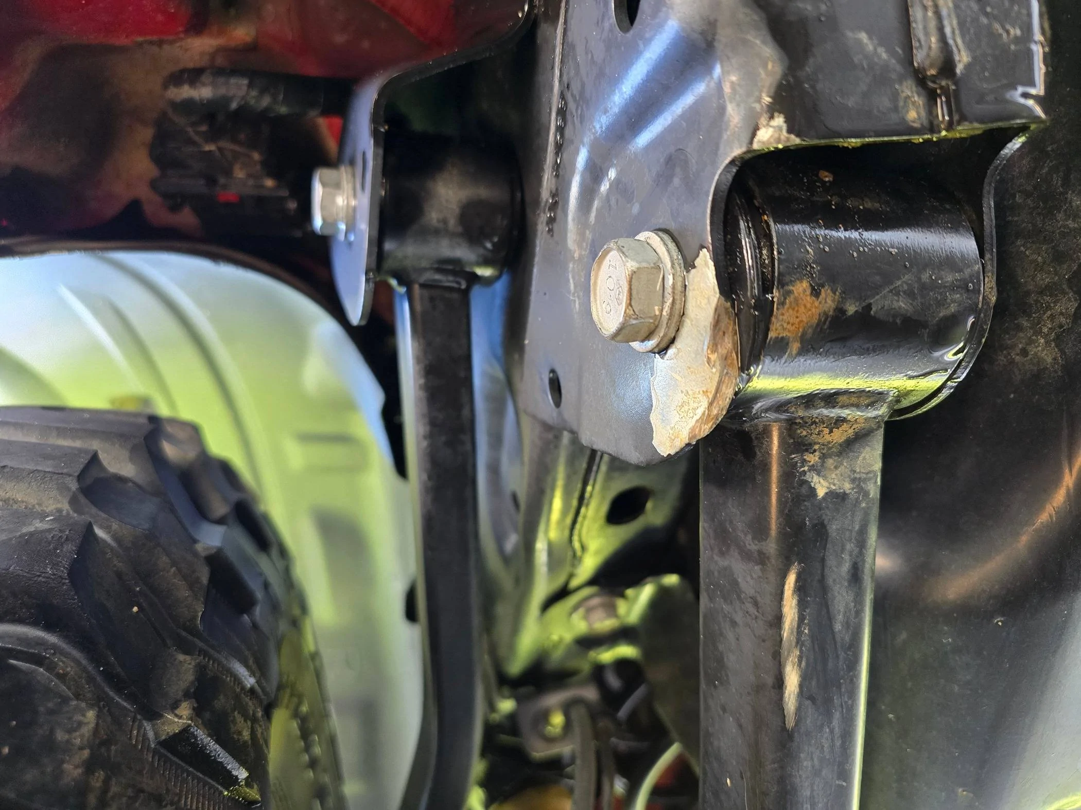

So 2021 JLR. I attended a Jamboree this past weekend and while pressure washing found this carnage. I don't have a shop close by that specializes in offroad. Passenger side lower control arm forward mounting point got hung up on a rock and I'm not sure how to repair it. I'm handy but not a welder or fabricator. Thanks in advance.

I can’t quite tell from the angle, but if it’s not twisted and everything functions like it should, I would rattle can it to prevent rust and keep on wheeling!
It's rubbing the control arm bushing, if it was just scraped up I'd absolutely just paint it. It's hard to get a good Pic. I was thinking pull the control arm out and use a pipe or large Cresent wrench to straighten it enough to keep it from tearing up the bushing.

That looks about average for a crawler.

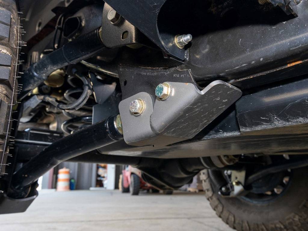

In that situation for me my best thoughts are to add LCA skids front and back to protect them in the future.
Fortunately I have LCA skids, this is the upper mounting point. Not even sure how I did it.
Oh. That’s not so normal.
I saw the second pic and thought the third was the same but looking back I can see that it is the upper.
Something was really reaching to get up there.

Is it possible to hammer it with a screw driver or prybar for clearance?
