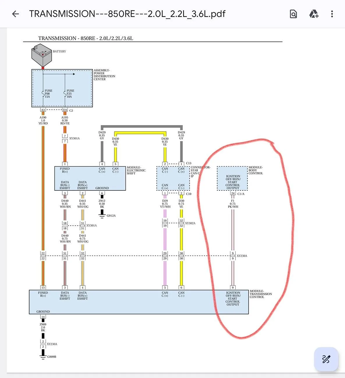

Tried alomst every fuse that active by run/start button, don't seems to work, UO101 - lose communication with TCM still active once the turbo timer running
Checked the wiring , seems the TCM also powered directly by the Run /start output?

Have you tried checking voltage at the tapped fuse when the timer is running?
Yes , it's outputting the battery voltage.
I think the problem is i can not find the correct circuit.
F08 and F25 always provide power to TCM, other fuse don't seems to provide power to TCM,
I tired the following Run circuit today but no luck:
F34,F41,F42,F46,F50,F56
