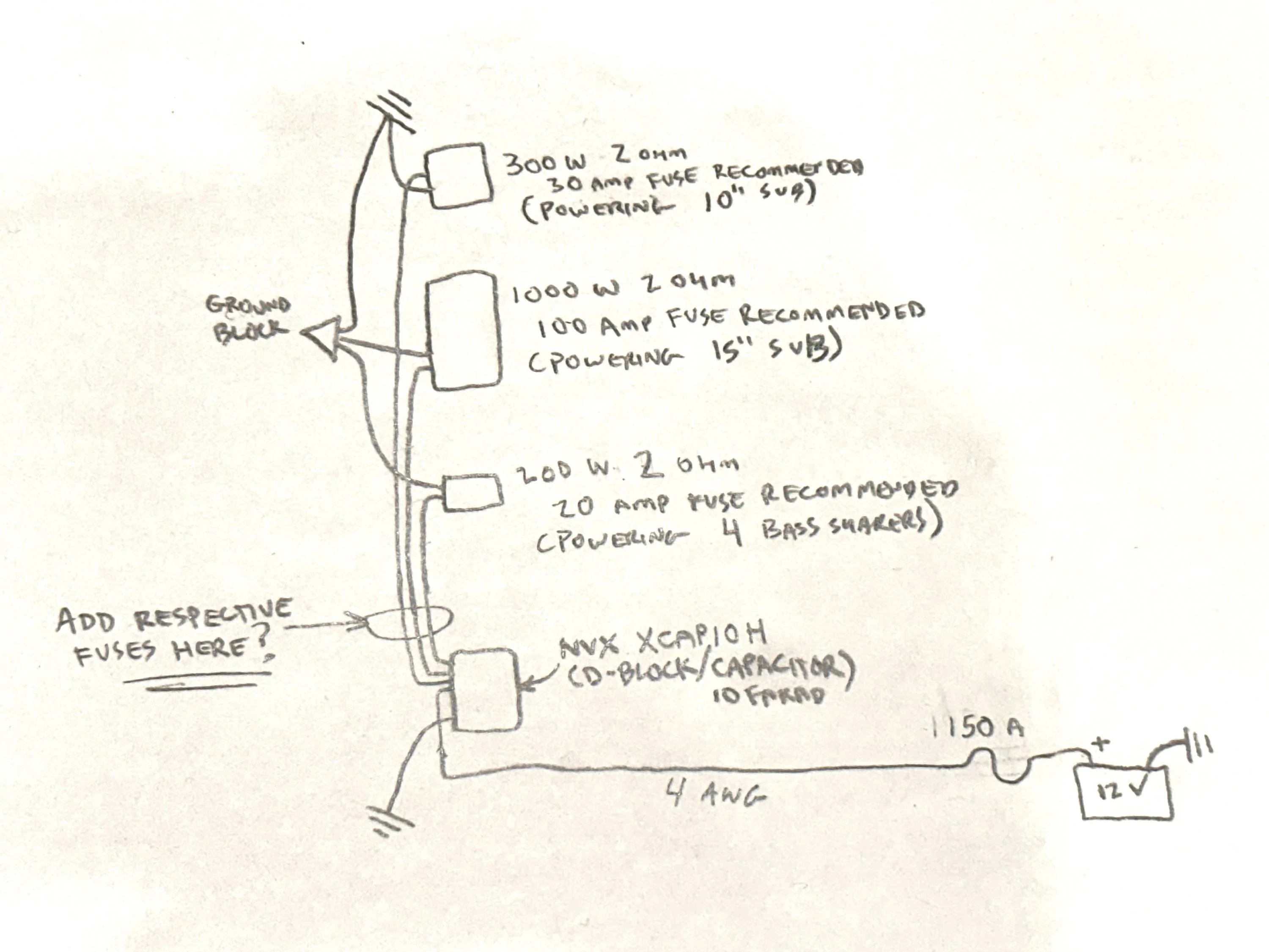

Alrighty folks…will someone please check my fusing with my proposed amplifier fuse setup as I’m totally frying my brain with this.
Here’s my setup:
Jeep Wrangler JL Looking For Help with Fusing my Multi Amplifier Setup d2b9801d-3c93-4f31-b385-542a6d34d846-jpeg
I will have three amp: 300 W, 1000 W, and 200 W. The recommended fuses for each are 30A, 100A, and 20A, respectively.
I am also installing a D-Block/Capacitor Combo (the NVX XCap10H).

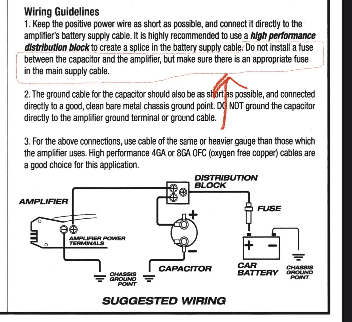

I’m confused about the main in-line fuse (do I install 150 amp fuse at the battery and the recommended fuses for the amps individually. In other words…do I install three extra fuses after the NVX d-block/cap for each amplifier’s respective fuse rating (as circled in the above schematic)? Based on the following I should not (granted this is in reference to a capacitor separate from the d-block)…

Fuses protect wire so I’d guess you would want to fuse individually if you ran different wire to each amp… or, run same wire and just use the initial fuse after battery?

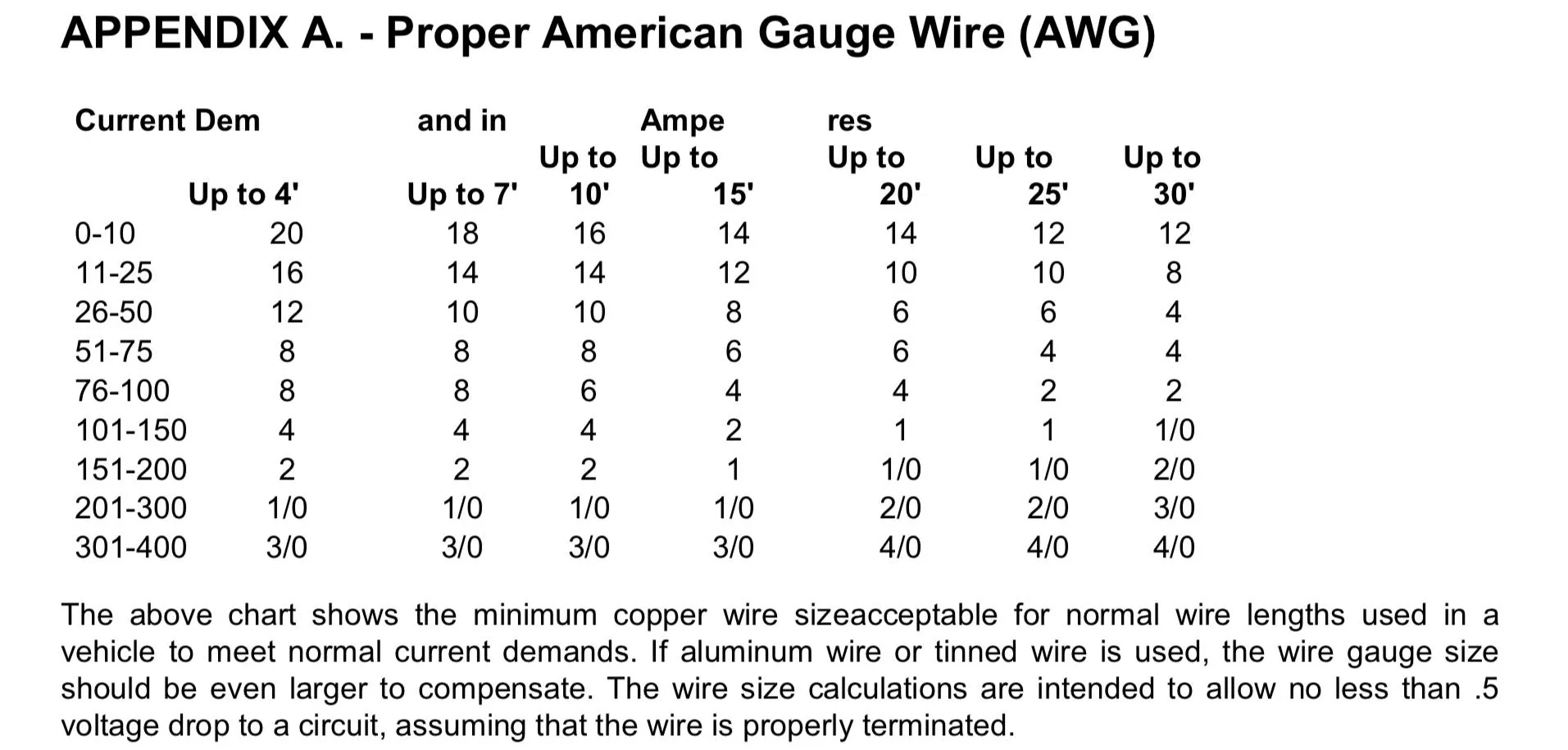

Here is a chart we use for audio competitions to help define wire size and fuse rating installed at the front within 18” of the battery.
Jeep Wrangler JL Looking For Help with Fusing my Multi Amplifier Setup 3A4AEC97-8403-4BF4-87CB-86A06B943B14
Per this chart, if you mount your amps in the back, you’re going to need a minimum of a 2 ga main power wire. I typically go one size larger than required on main power wire and fuse for the load so I’d run 1/0 with a 150 amp fuse. I HIGHLY recommend using welding cable and avoid eBay or Amazon car audio wire since it is typically CCA (copper clad aluminum). You want pure copper wire and welding cable is the cheapest way to buy good wire.

Thanks, Helps a ton! My wire is about 10 feet long, so I should be good at 4 awg.

At 10' 4ga should be fine unless you're hammering on the system constantly and pulling a lot of amperage. If you enter a competition, expect to be questioned though since you're right at the upper edge of amperage and distance.
I've never used Crutchfield wire but I know a lot of their suppliers and if it's labeled OFC then it is OFC.

Sorry I'm late to the party @JasonInDLH , I've been working on the JLUR getting ready for the trip to Moab. In my opinion, the two smaller amps don't need and won't really benefit from the cap. I would use the cap on the big amp, with the proper fuse on the battery side. I would use one 4 awg wire from the battery to the fuse holder for the cap, then to the cap and on to the big amp. Then run a second 4 awg wire to a fuse holder and to a distribution block (either fused or not) to power the two smaller amps.

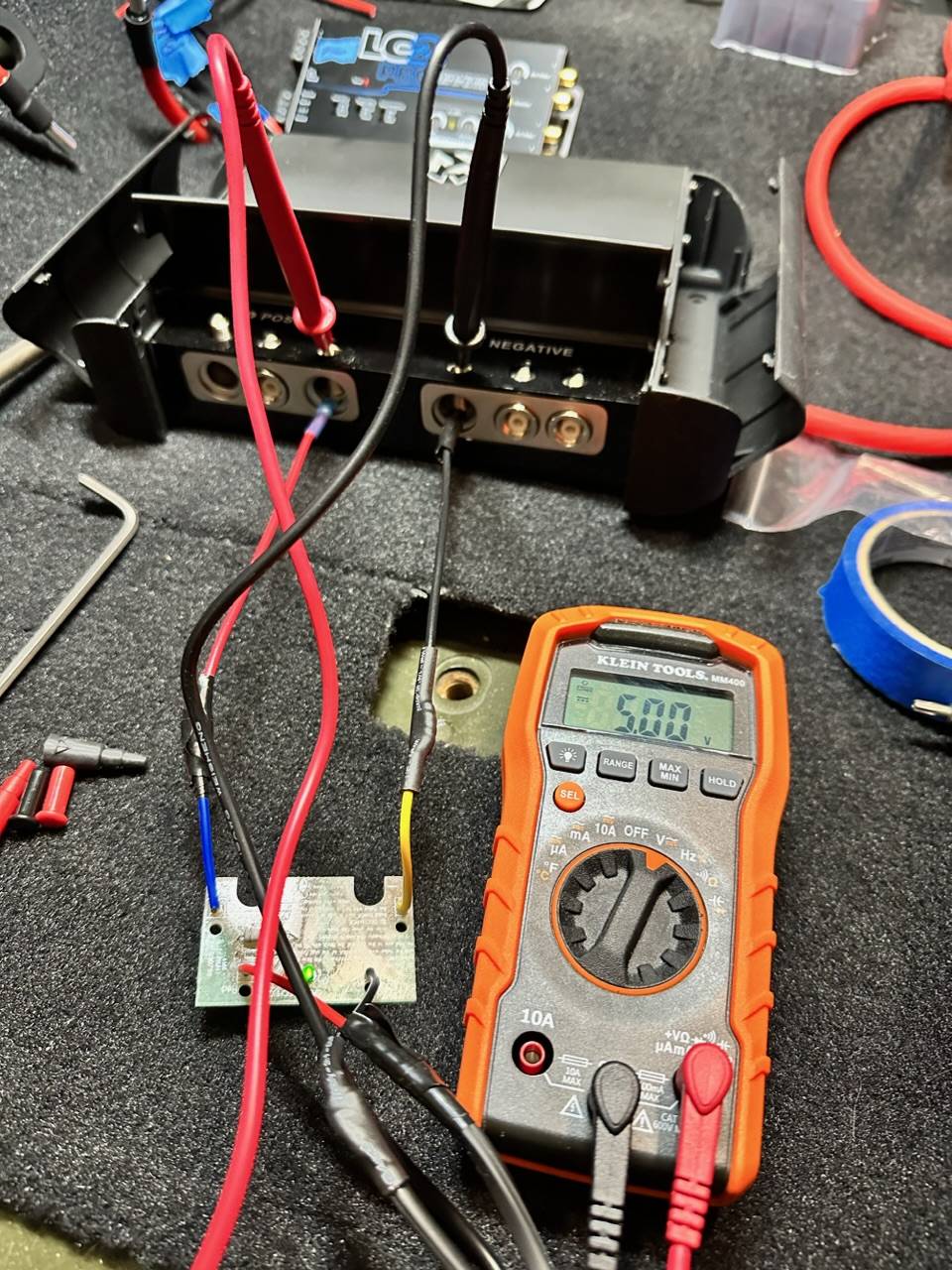

I finished slow charging my cap last night Strangely, I had to wire in an additional resistor (not shown) or the included charging resistor would smoke. Has this ever happened to you?
Jeep Wrangler JL Looking For Help with Fusing my Multi Amplifier Setup AA11705A-BF28-44BD-9D78-71B8251A0CAA
Sadly, I’m all done wiring things up for now (until I get my other amps). Now I don’t know what to do with myself! I s’pose it’s back to Netflix. ???

My way is fairly simple, you'll need to make a bracket to hold the two fuse holders under the hood. I did a similar thing in other Jeep that I did the two amps, each had its own dedicated power wire and fuse coming from the battery. It also minimizes the lump from using one big wire under the carpet.
I've seen that a few times where the resistor on the card is damaged and you'll need a separate resistor, but it's no biggie!!
